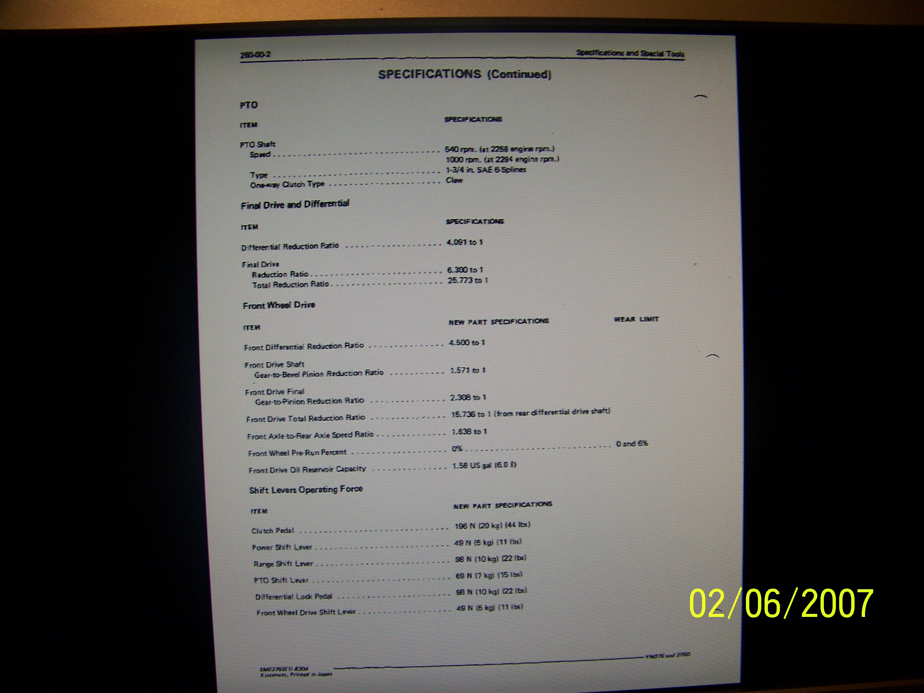

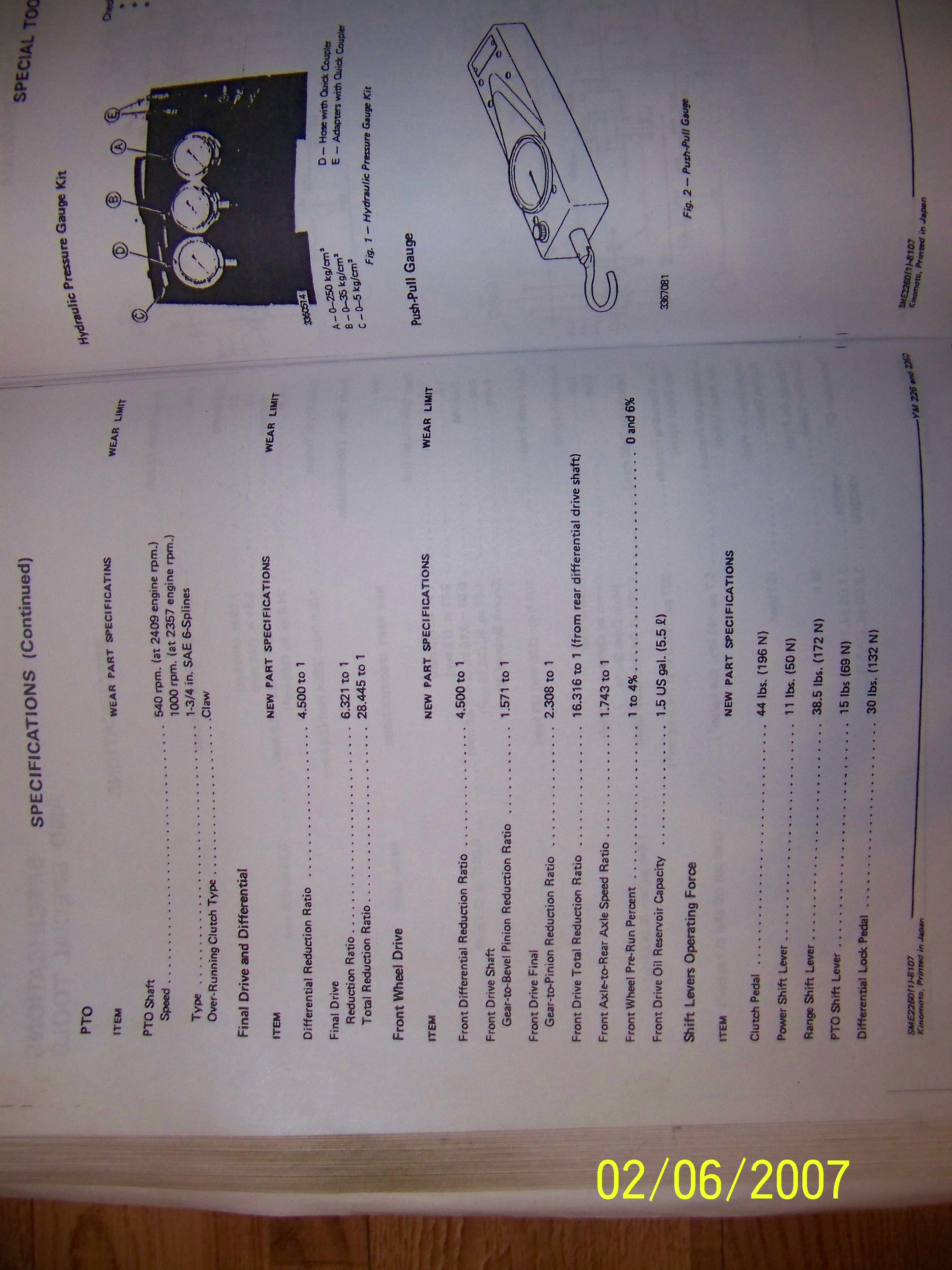

1st picture out of 220/226 repair manual, 2nd out of 276 repair manual.ratio 001.JPGratio 002.JPG
/ Yanmar YM2220D question to tire and lift capacity #37
1st picture out of 220/226 repair manual, 2nd out of 276 repair manual.View attachment 525454View attachment 525455
Of those various ratios on your second page picture, the one for the YM276,
I think the ratio I'd pick to try to match with tire rolling circumferece would be the "Front Axle-to-Rear Axle Speed Ratio of 1.638:1
But I'd still prefer to measure them myself.
rScotty
