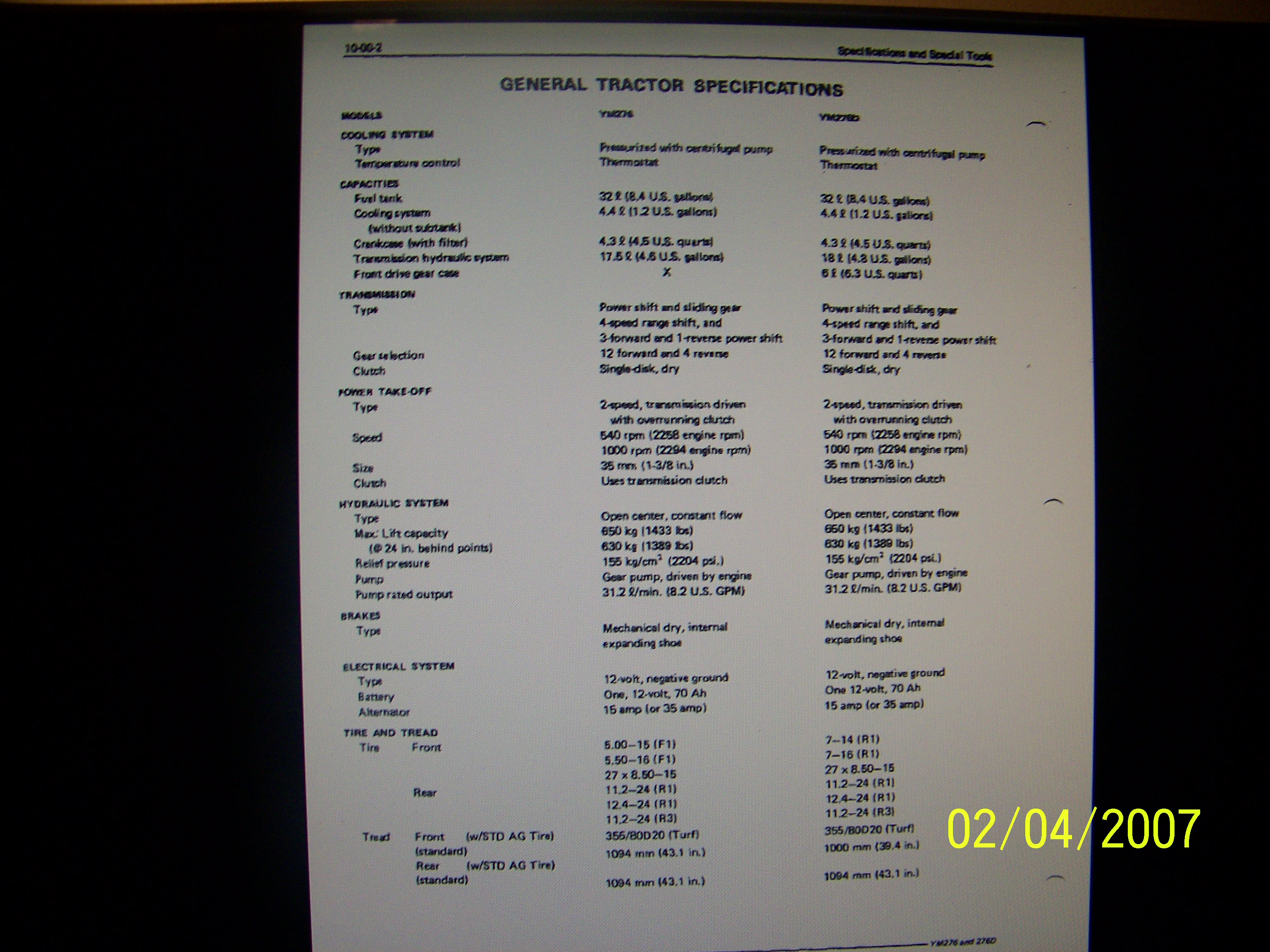

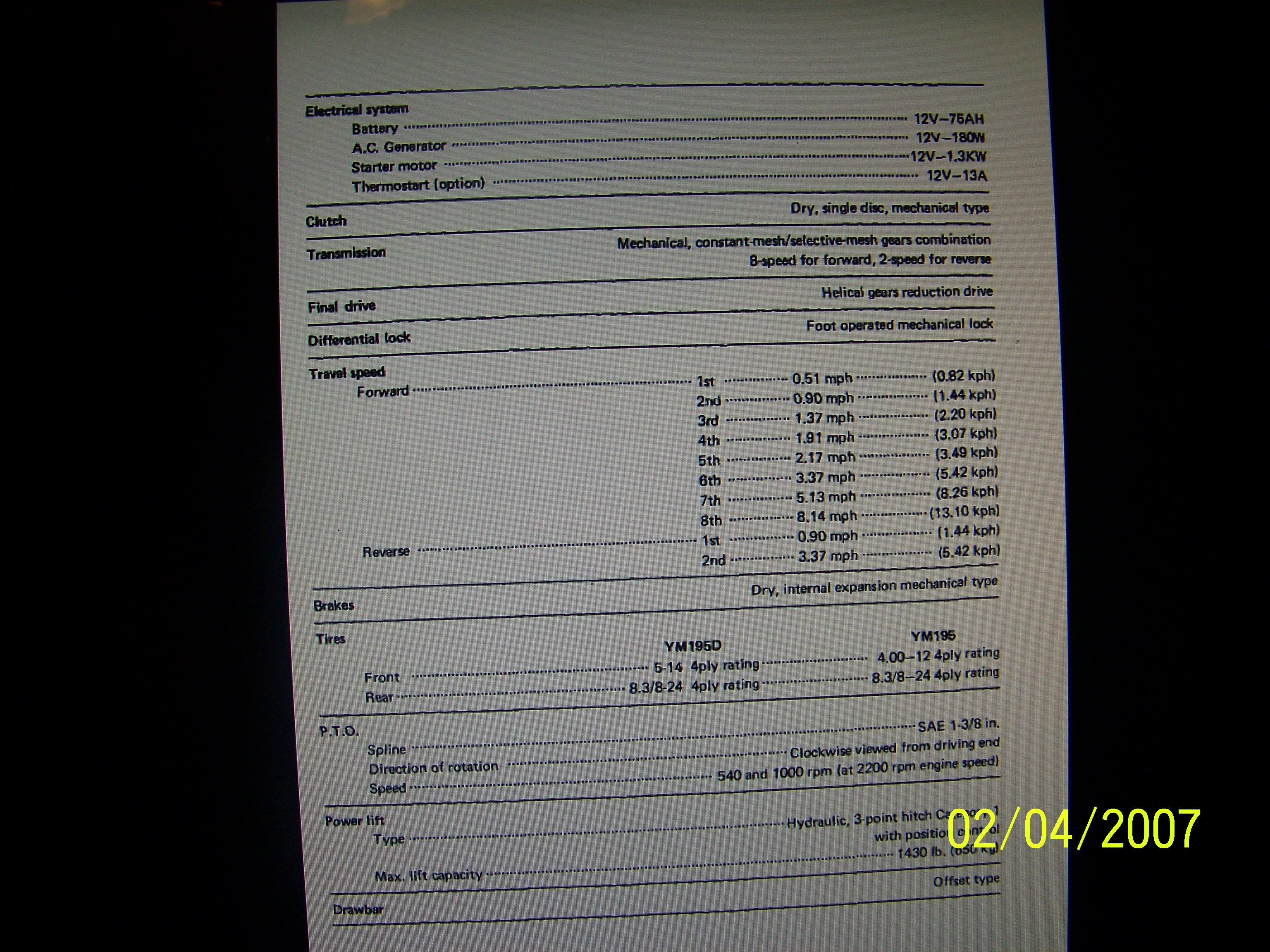

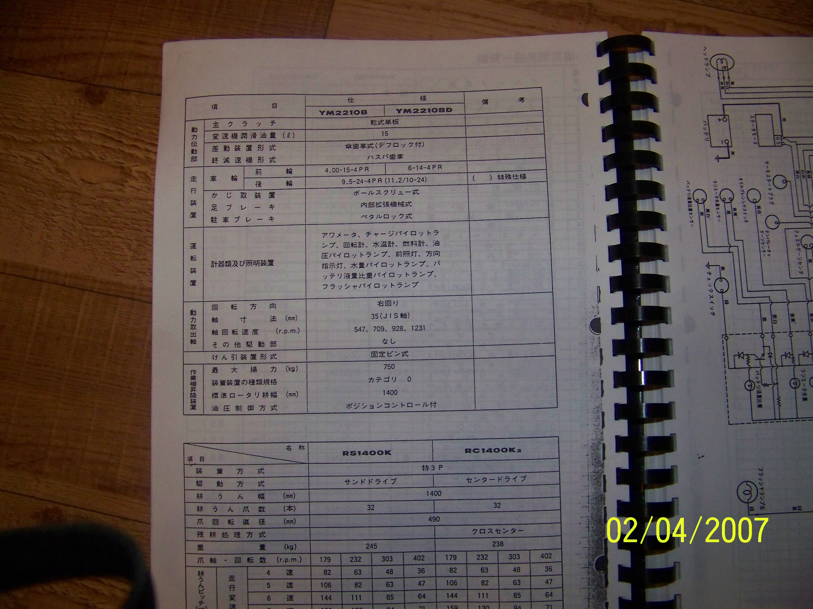

Info out of Yanmar manuals, again, I am not sure about the 2210. Descriptions of numbers are in Japanese. 1st picture out of 240 parts manual, 2nd picture out of 276 service manual, 3rd picture out of 2210 parts manual. I agree the weights seem heavy but for what it's worth this is Yanmars specs, not mine.
yea I looked at my Shop manual. Its a Yanmar Printed shop or service manual in English for the YM 240/YM 2000 which is a tad smaller than the tractor discussed but it does confirm what you said Winston. Just seems really high to me. That would be right at the lift arms with the vertical arms in the furthest back or closest to the tractor holes, which means it wont lift as high but the 3pt will have better leverage on the arms.
As for the disk. My disk probably weights 500 or so pounds and I stack over a hundred on top. It feels a whole lot heavier and lifts my front almost off the ground even with the front weight but that's because it hangs so far off the back and gets leverage over the tractor that way.
   / Yanmar YM2220D question to tire and lift capacity #16
I wonder if those figures are measured at the ends of the hydraulic arms, rating the lift applied to the vertical shafts. Since many of the Yanmars sold in Japan included the close-mount semi-permanent tiller, their rating might have been measured that way.
I don't doubt those numbers are in the printed literature but I doubt a standardized test (I think measured 24" beyond the end of the lower arms) would match the printed figures.

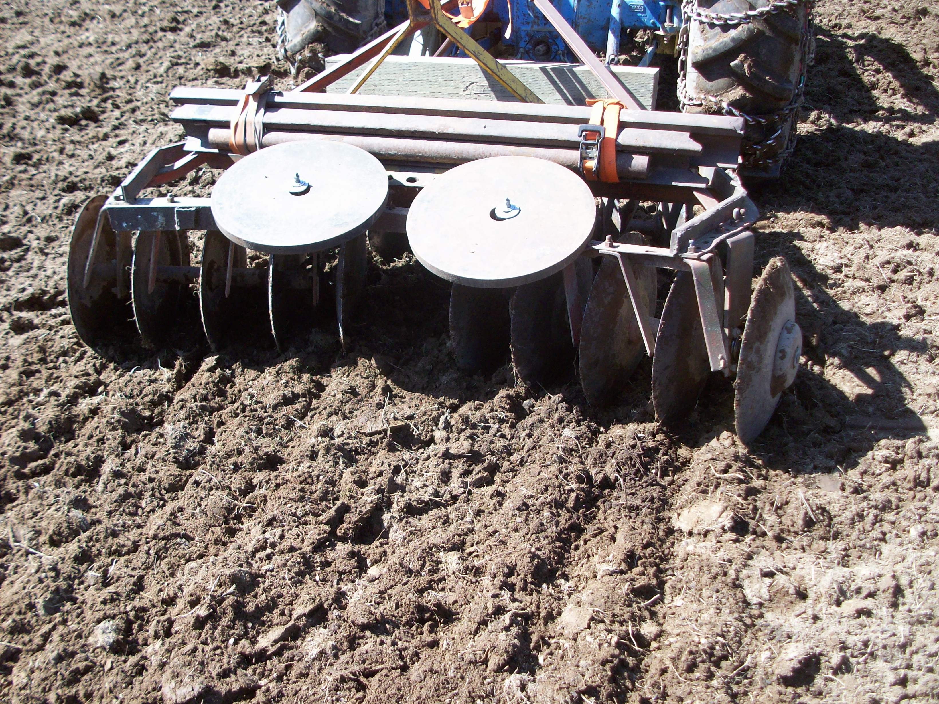

Well, i will admit I don't know the discs actual weight.
Front end lifting was not the problem (has an Allied FEL) for front axle weight.
Maybe it has more to do with the leverage applied because of the discs length?
As I said the 2310 has no problem with a 3 point snow blower He also successfully uses a seeder and rear blade.
attached is a pic of the disc in question, None of the added weight was on the disc when trying to lift it with the 2310.
Maybe the relief pressure is set to low on the 3 point?
To the OP does the 800lb. forestry winch also lift the front of the attached winched in log with the 3 point when transporting If so it may lift the winch itself OK, but how much extra will be left to lift the additional weight of the log?
Can you trailer the tractor over and mount up the winch and try it with a log- that might be your best option to be sure it will lift the winch.

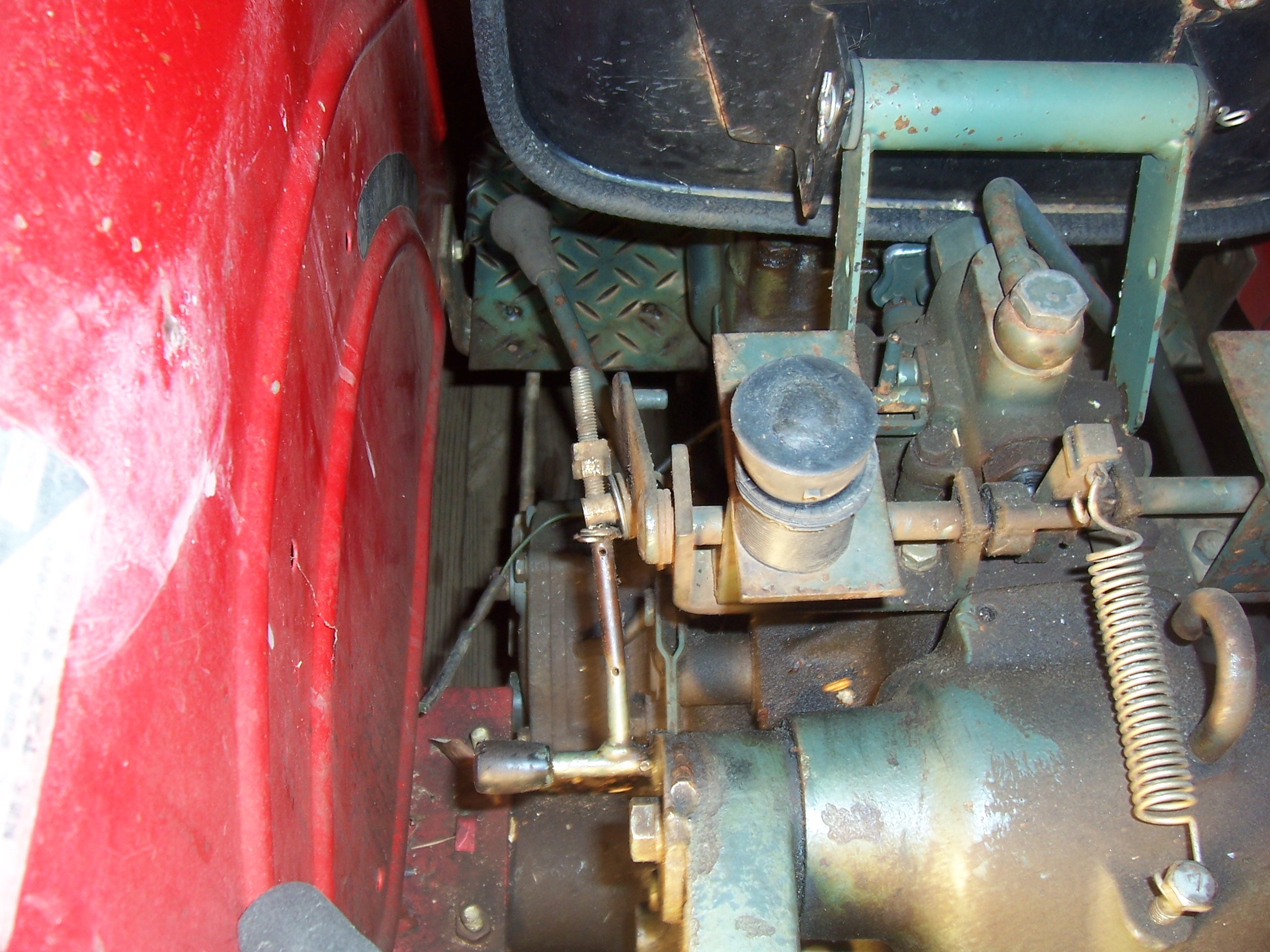

I agree with Cal. So far back. Those Disk Weights are way back. My top link has a pivot that doesn't start to tighten and lift on how you Adj. it. I never actually lift my Implements. level. So that helps. Hoye gives you 6 more Eng. Hp. than my 2000. That gave me the suspicion of something may be not right. The first thing that came to mind was if your Lift arms are actually lifting all the way up. I can set my Height by this Adj. on my 3Pt. and may not be lifting high enough were it's set. If you have the Adj.? It's to the far left by the Fender.....
