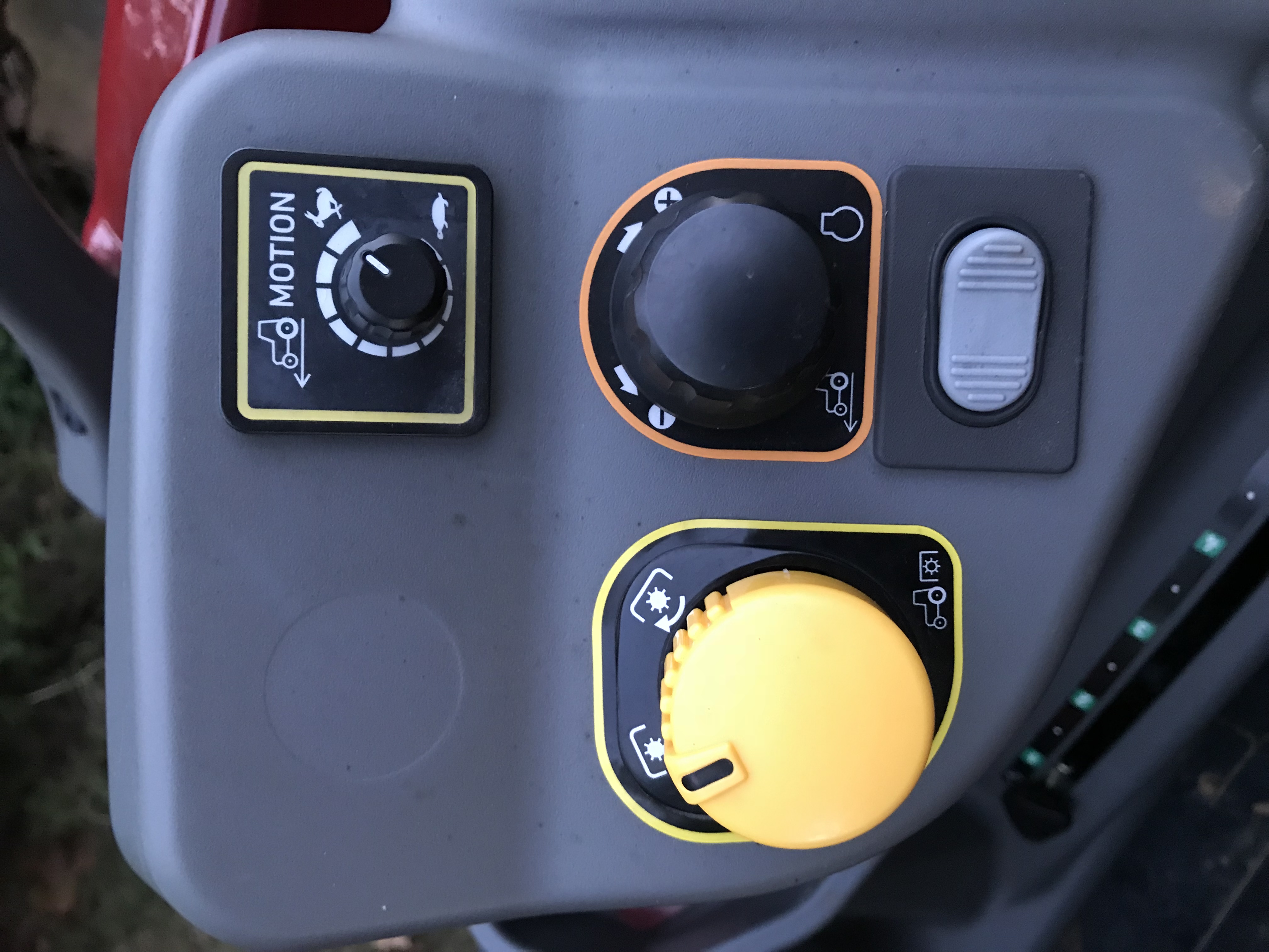

It is instantaneous or gradual all adjusted by a knob on the fender.
Top motion knob is reverse lag. Sometimes you want fast - other times slow.
Bottom knob is cruise. You can set it for ground speed or engine rpm.
Yellow is PTO engagement
   / Yanmar YT359C #37
Thanks.
What's the blank circle cut-out for? Is there another option available?
