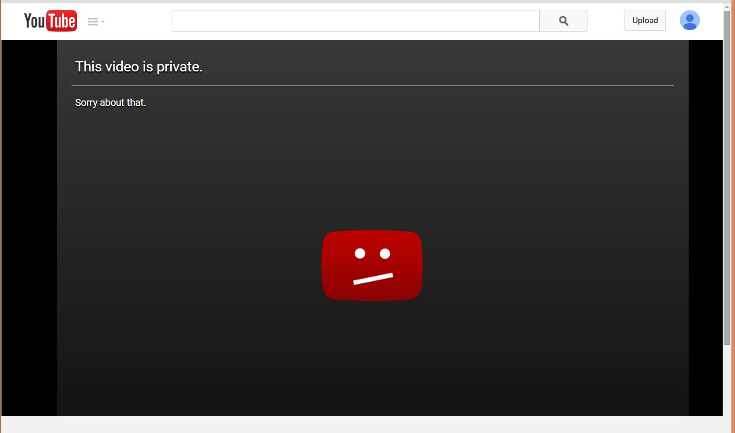

Here is a short video of my extremely safe hydraulic testing bench :p the power steering pump was deemed too slow and I have now obtained a PLP20 16D gearpump testing will begin hopefully tomorrow.
https://www.youtube.com/watch?v=AGBAwLKJKwI
   / Yardmachine MTD FEL build diary #33
Wanted to watch it, but can't. :(
Got this.
attachment.php
#34
oops my fault, try again should be all good now :D
   / Yardmachine MTD FEL build diary #35
Yep, worked.
