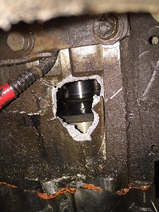

and now I have broken it! http://i247.photobucket.com/albums/gg149/mushieman/th_it%20be%20****ed.jpg
/ Yardmachine MTD FEL build diary #52
What broke?
Can't tell from the close up picture.
/ Yardmachine MTD FEL build diary #53
You grenaded that good...I just busted one of the mounting ears off mine.
Transferred the whole works to an older "garden" rather than "lawn" tractor to get a cast-iron transaxle. Still find that most of the time, I have way more bucket and tire than I do traction and still can't do much real digging with it. But it mostly works for handling mulch, which is what I wanted it for to start with.
#54
I have another motor here i may rebuild and put in, but now the bug has hit me hard and I am already drawing up plans for a 4cyl garden tractor :p
