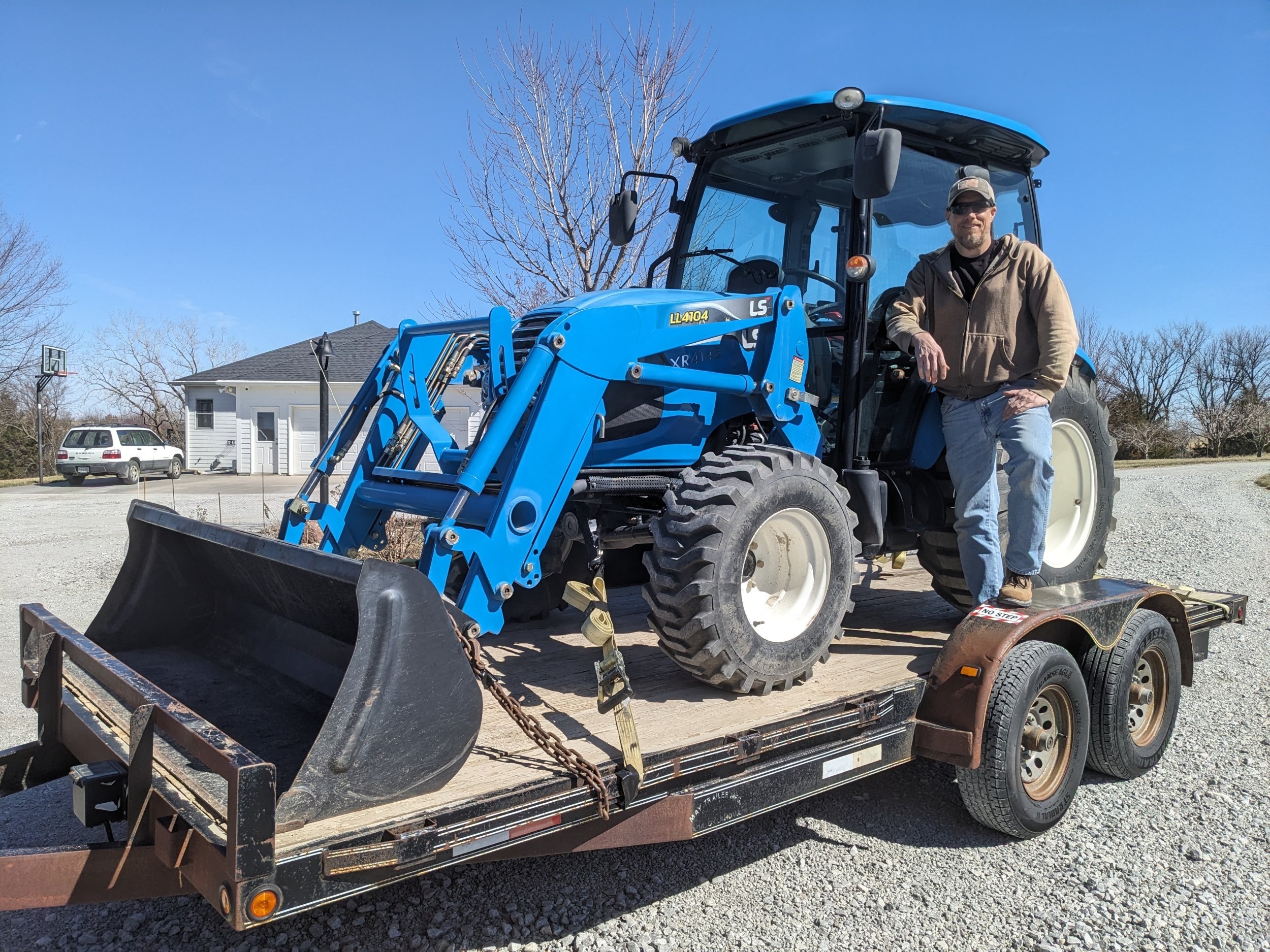

We also love photos! :)
Bringing it home last month:
