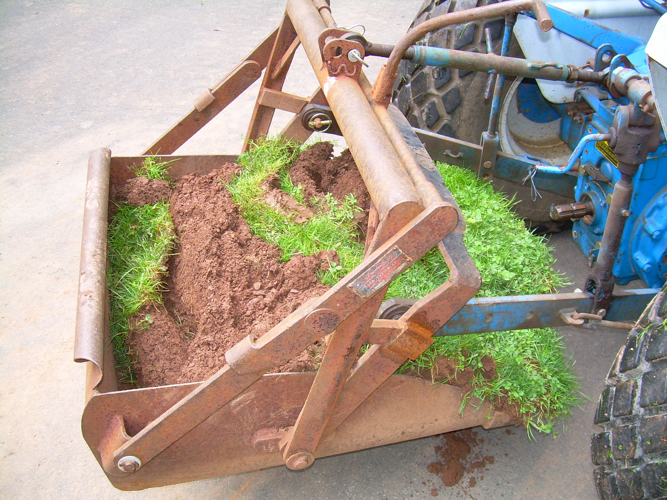

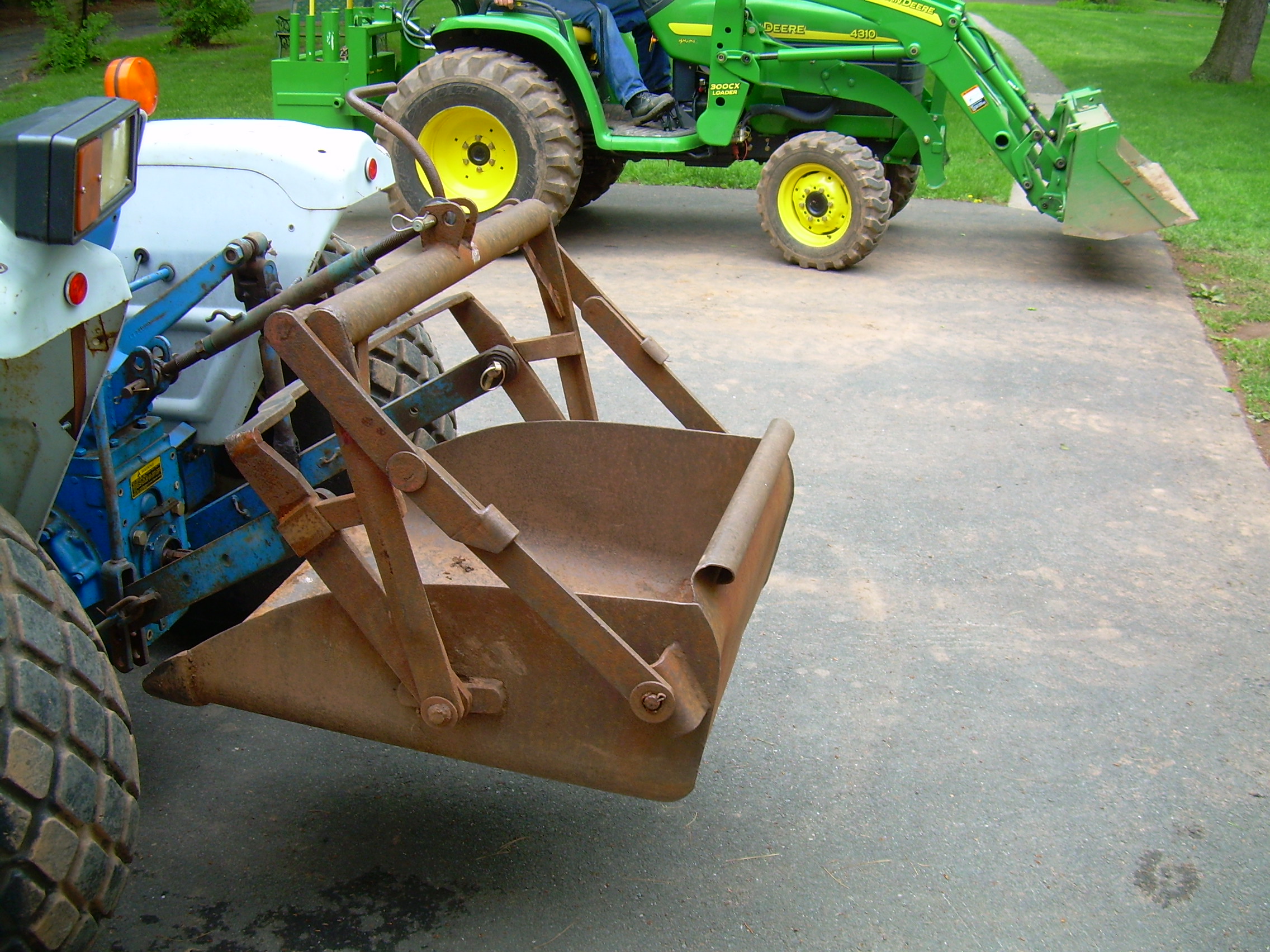

I was thinking about the title to this thread today and was gonna start my own, "Yesterdays excavating technology ......Today".

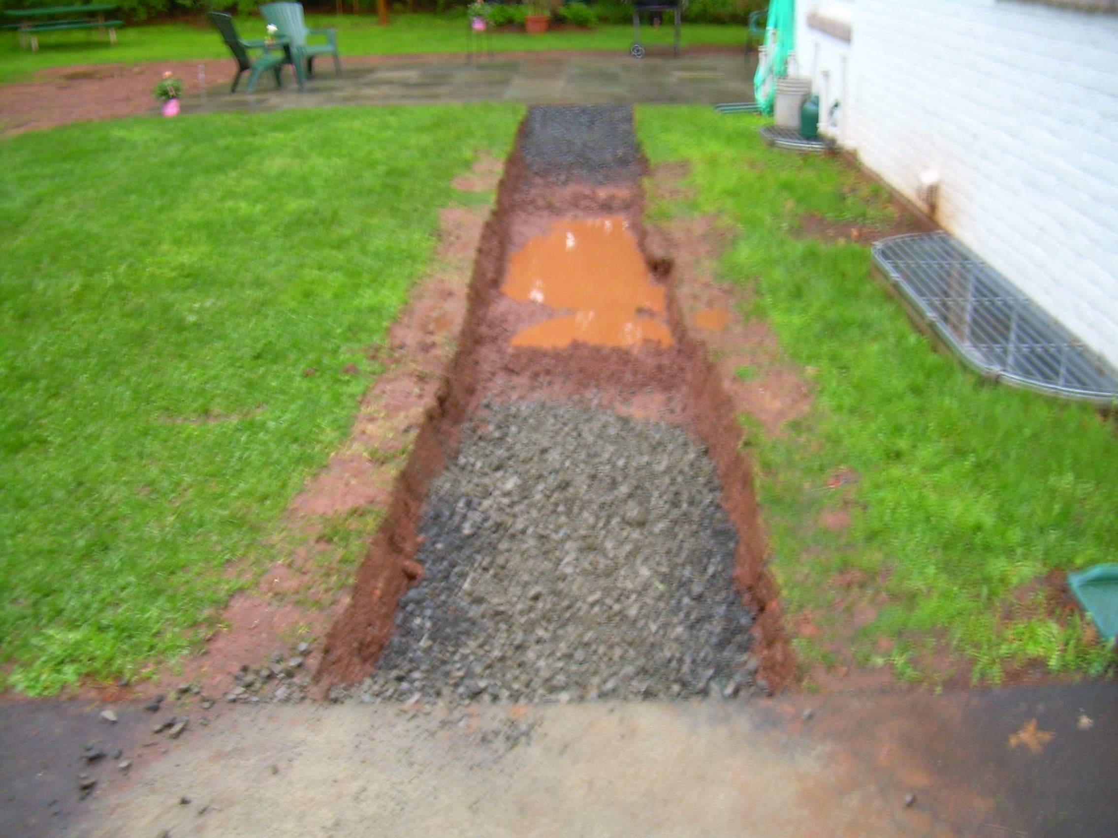

Was looking all day to borrow a 4 ft box blade/scraper to dig a base out for a walk, I have a 5 footer but the walk will only be 3 ft wide so I didn't want to over dig it by 2 ft.
Well I couldn't find a 4 ft box so my helper recommended that I ask my old friend Oscar to borrow his 3 pt scoop, at first I thought it was a dumb idea, but after weighing all the options I figured it was worth a shot. I had fixed the scoop for him last fall and welded a cutting edge on it also. Never thought I'd be asking to borrow it with all my modern equipment.
It's around 30 inches wide, he got it as part of a package deal back in 1948 with his Ford 8n, along with the plow shown in my pics.
Man! what a handy attachment, capable of moving a pretty hefty scoop of dirt very efficiently, made several passes down the middle and cut what was left on the sides with a shovel. Starting raining so I couldn't finish up, but that scoop saved us a lot of time, If I didn't have a loader I would definitely own a scoop.

Good Afternoon John,
Wow that scoop really can do some significant work ! No wonder they still make 3 pt scoops ! ;)
