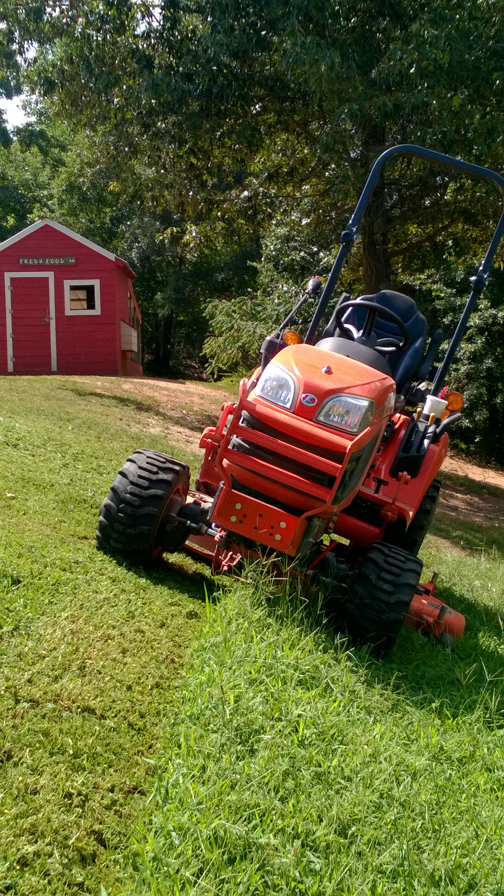

I mow fairly steep side hills with my BX. Is it more stable then you current mower. Maybe a little but with a roll bar and seat belt, I feel safer. If mine was any steeper I'd get wheel spacers to help. I also have fluid in my rear tires which helps. I mow with the loader off. Once you get good at it you can get it off in about 3 minutes.

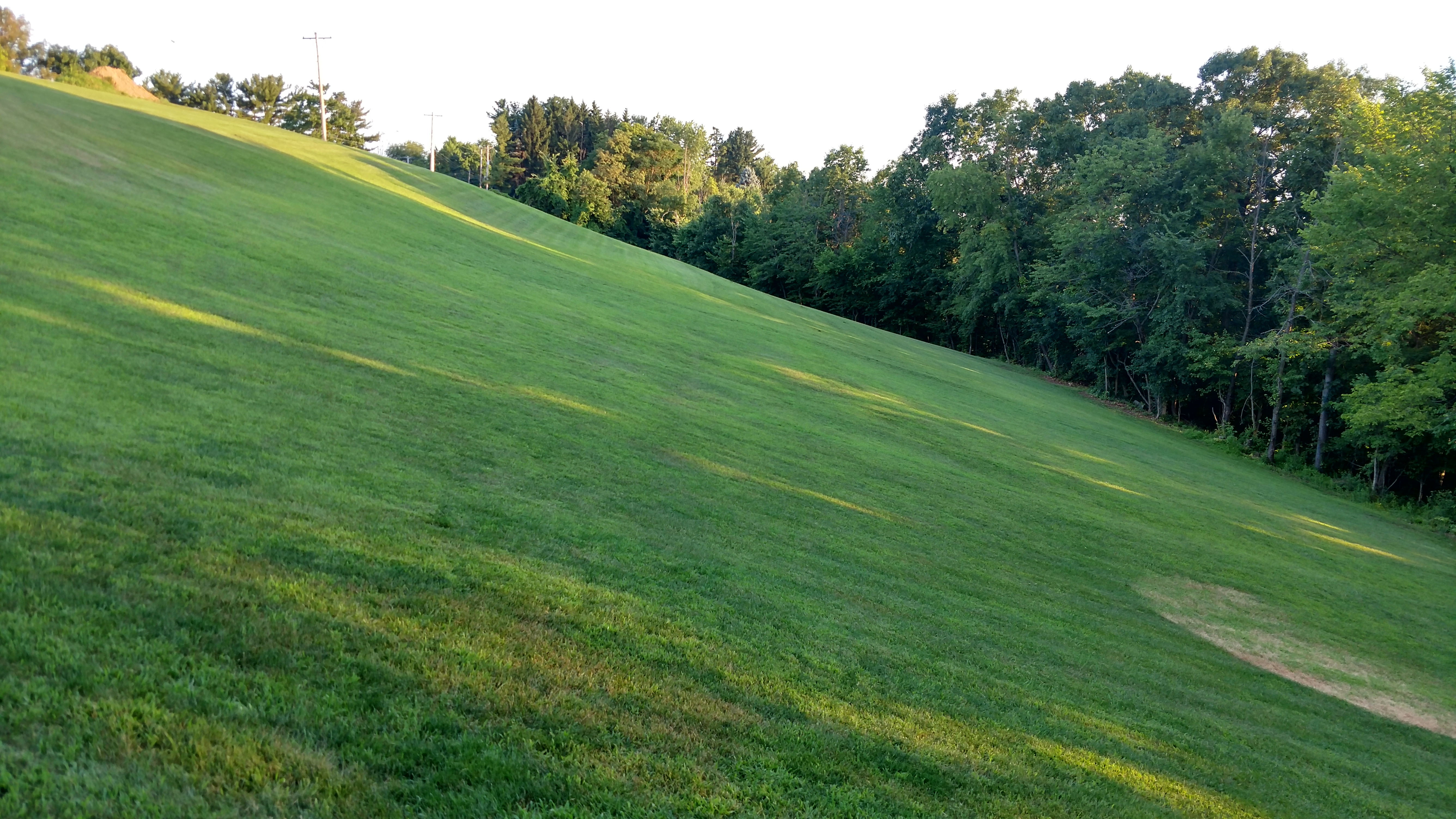

You speak of steep slopes, and you question stability of a larger tractor compared to a SCUT. I have a photo of my yard attached for you to ponder.
I cut 3 acres of this slope, I started out buying a SCUT (Kubota BX25D) and found it to be inherently dangerous and deadly even with filled tires. If you stepped on the downhill side of the floor board the machine would start to tip. With my backhoe on, I had no choice at all but to swing it to the uphill side and drive real slow. Overall, it was MUCH less stable than my garden tractors. As in, I dumped that thing on Craigslist within 4 months of buying it. Not just no.... HECK NO!
I went from that to a Kubota B2650 that I had built specifically to live and work on my property. I had it built with wider tires than standard, spacers added, 400+ lbs of fluid added to each rear tire. My B2650 is massive compared to that SCUT. It is much wider (61"), much longer and much taller. But... it is much heavier as well with those fluid filled tires that are 4 times larger/heavier.
The stability of the B2650 compared to that SCUT is night and day improved. Do not get in your head that a SCUT is stable. I found it to be the most insanely dangerous and unstable thing I have ever driven on this land.

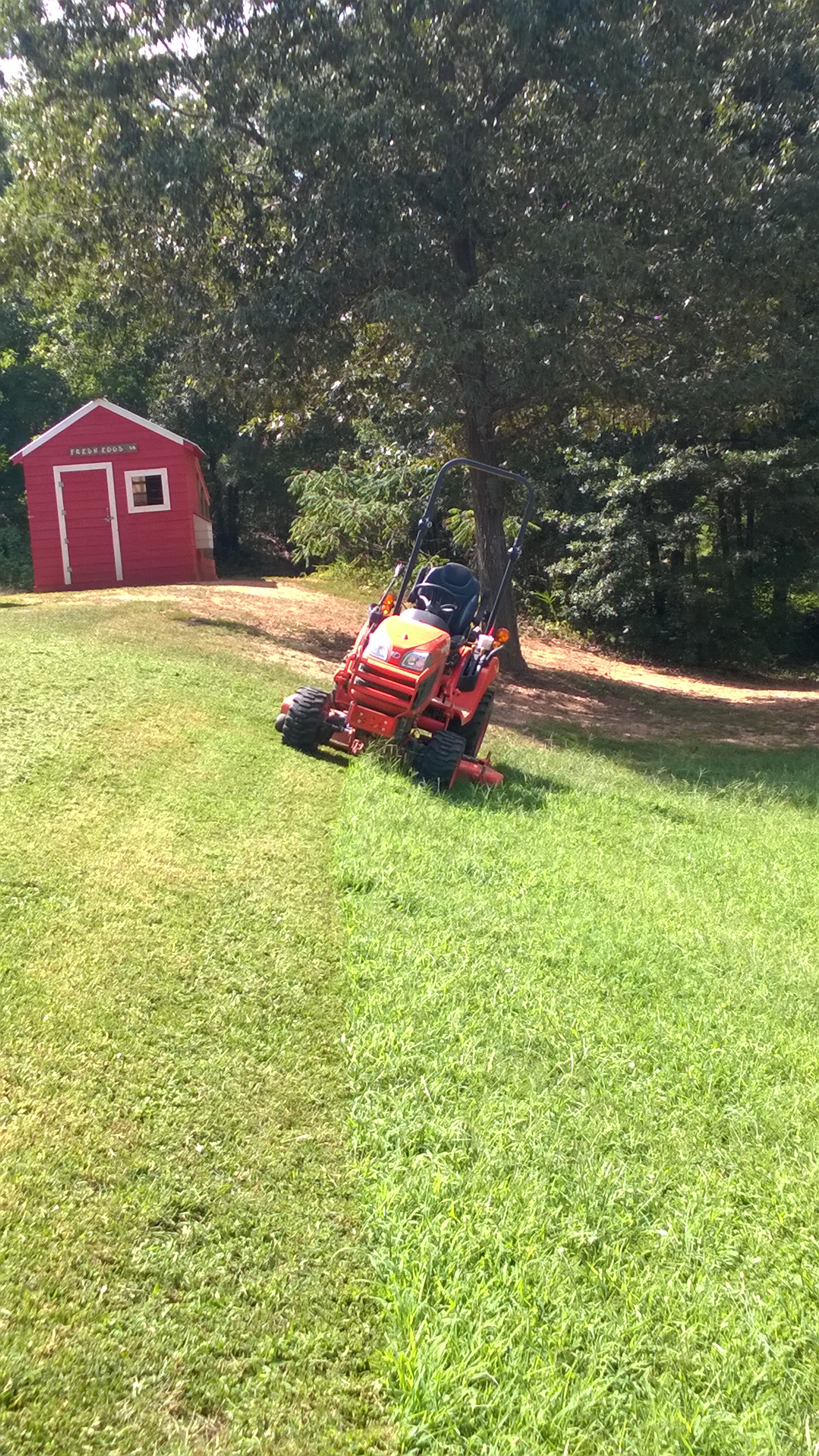

I mow with my BX with the loader and attachments off. I have real wheels filled. Mows great. 4X4 high on the hills. When on this side hill and a little steeper place I feel nervous, but I can sit in the seat and rock toward the down hill with no lifting of uphill tires at all.
You can drive over the deck with your loader on if you want, but it's so easy to take off the loader and put it back on that I don't know why you'd want to.
You can't drive over the deck with a box blade or tiller on. Actually, you can, but you can't lower the 3PT to full bottom to remove or put the deck back on with an implement on the back because the hydraulics that controls the 3PT also controls the deck raise/lower.
