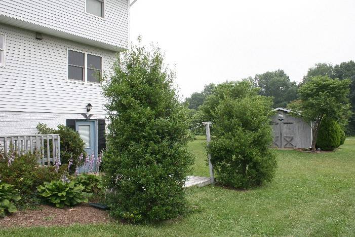

In the couple hours I did have, the first thing I tackled was a couple of small holly trees with the backhoe. It worked great and I can't wait to go after a few larger (about 12 inches) stumps left from some sick pines I took down last year. I know that project will take some time but it should be fun. The backhoe has about as much power as I anticipated but not as much as I hoped for /forums/images/graemlins/tongue.gif. Of course, I was taking it easy and not running the engine at max RPM. I don't want to work it too hard until the after the first service.

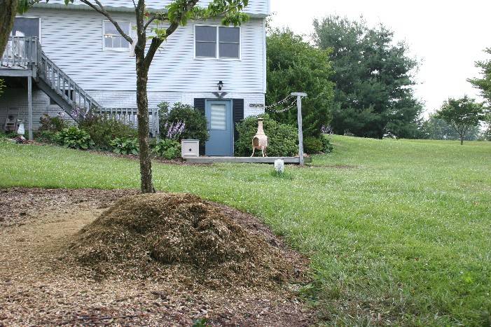

These are the trees I was referring to.

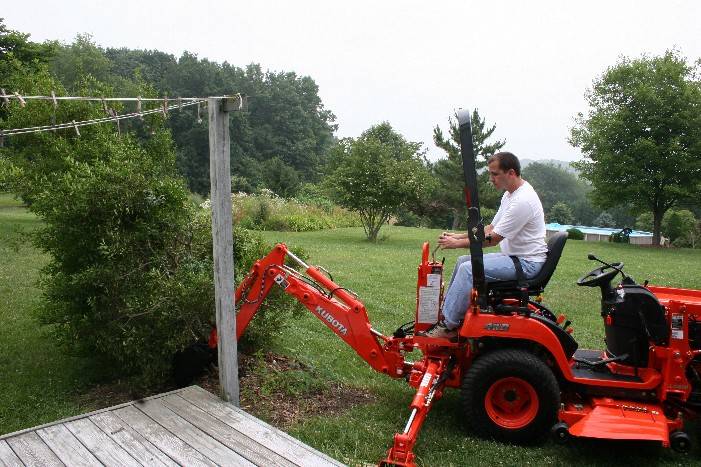

Almost scary how easy this was to knock over. Like it wasn't even there.

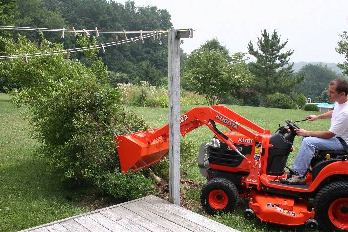

Definitely tricky to get the hang of. I'm sure it will take me a while to get proficient with the hoe.

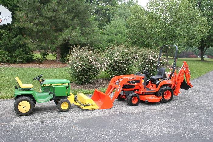

This is the end result. The mulch pile in the foreground is what's left of the trees. A little grass seed and I'll be good to go.
