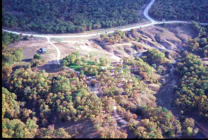

   / yet another pond #56
have-blue: </font><font color="blue" class="small">( I think your sand is from ancient meandering river, right? )</font>
I can't figure out where that river used to run...NOT! /forums/images/graemlins/laugh.gif (see attachment)
   / yet another pond #57
</font><font color="blue" class="small">( I can't figure out where that river used to run.../quote]
Uh huh! /forums/images/graemlins/wink.gif
