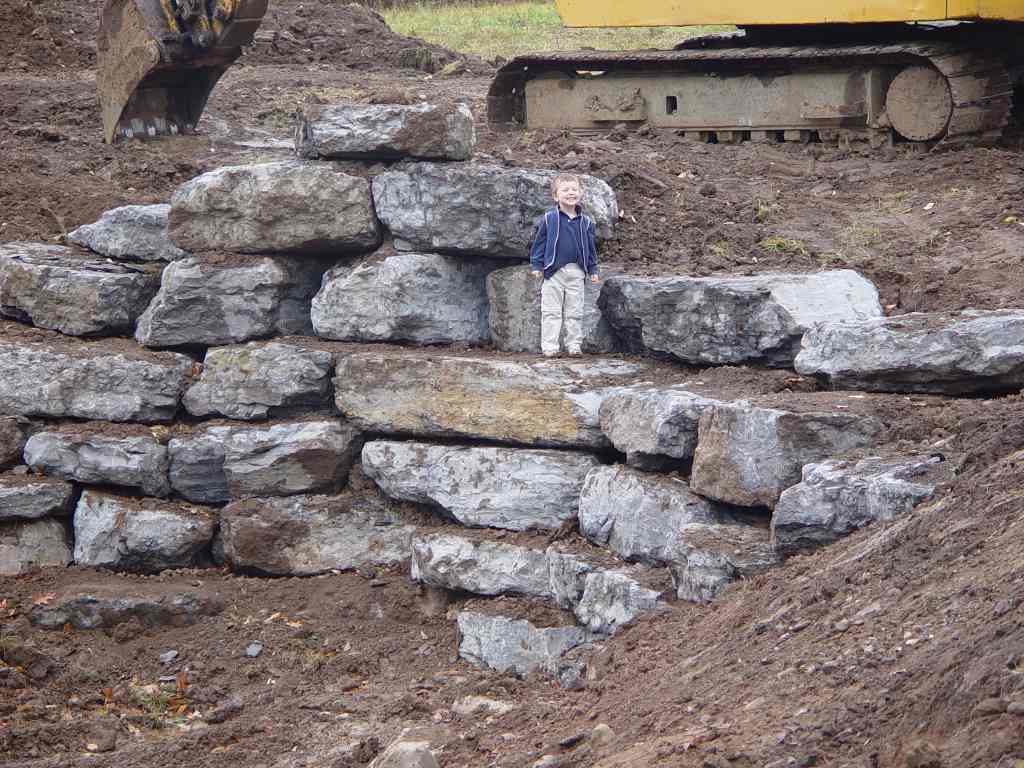

I was in a somewhat similar position to yourself. I just completed my pond a couple of weeks ago, and wanted to have a stone wall around part of it. (I am talking big rocks - 1 - 4 tons a piece which the grapple on the excavator was going to place.) The flat stakable stone itself was only about $10 / ton but the delivery was very pricey.
I picked up a Ford F700 Stakebed dump (GVW 26,000) with hydraulic liftgate for $4,250. I have hauled in 62 tons of stone, and am moving the the family to the new place with it this week. Get the truck!!!
I have attached a picture of my son next to the partially built wall. He is 4 ft tall to give some perspective. Final wall should be 14' high with 10' above water. I have a 11,000 gallon per hour pump that I am putting in to create a waterfall over the wall.
Best,
Larry

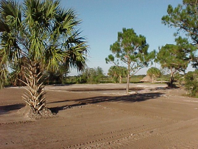

I saw your wall in your previous posts and was immediately envious. It's great. I consoled myself that the only place in Florida one would find such rocks is Disney World, so, while it will be appropriate in your location, it would be less than natural here. Instead, we plan to use wild grasses, ferns and flowering plants on the bank at selected places; the rest will be sod.
Here's the final pond, taken from the approximate location of our future front porch. The water level will come about halfway up the bank once we get the well installed. The shadows are me, my daughter and son-in-law and my grandaughters.

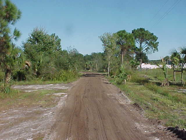

This shot is from the other side, looking back towards the house location.

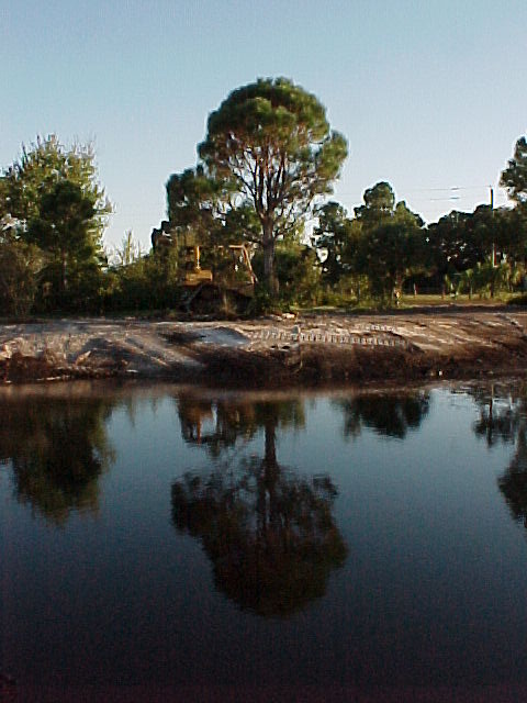

This is from the road we built, looking across what will be the front yard. The house will be to the left.

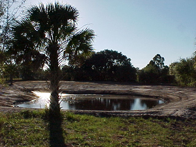

This is the actual house "pad". It's actually a raised yard on which the house will be built. It's about 2-1/2 feet above the origibal grade. It isn't high enough for slab construction;the house will be built on a perimeter wall and pillars about 2' above the new grade. Local codes require it to be 18" above the level of the nearest road. Roads in this area tend to be built up.

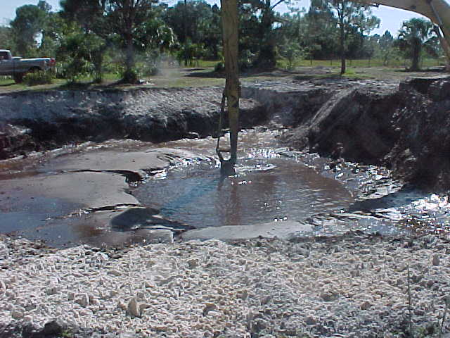

This is the end result of our road building effort. It will be covered with a 6" layer of shell rock to stabilize it, and a swale will be built on the right side to handle drainage. At the far right you can see the other approach to building a house pad - the mound of white fill is almost 4' high to meet code, but with no sloping or fill. They'll build on a slab. It's a little less expensive, but in my opinion, looks like a sore thumb. That house will also be conventionally much closer to the road, while we preferred to set the house back about 500' or so and have a "park" for a front yard. I'll be planting a screen of shrubs to block the view and give us some privacy.
