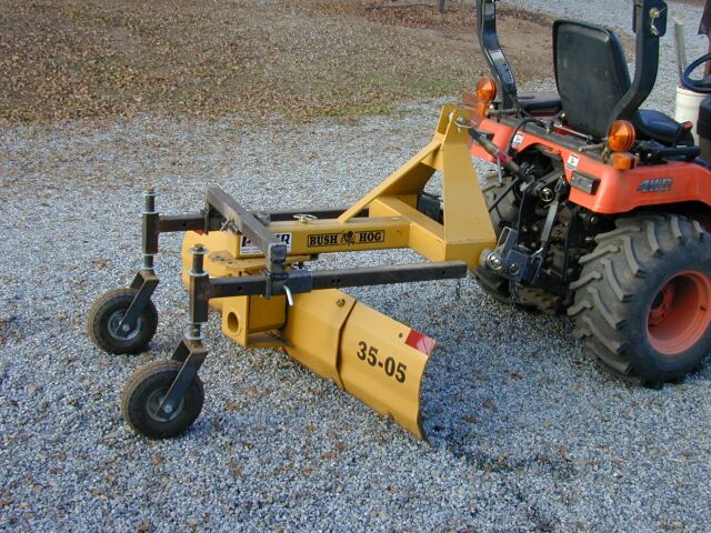

Just came in from the big test, dressed up our 150 foot gravel drive, played in the big ditch I dug with the BB and the dirt I spread out from the ditch. Then went over to the property next door and helped fill a trench he dug for his shop electric but never filled back in...
Results....
1. Gauge wheels are a cool, wonderful, great, gotta have accessory.
2. Jack stands work great, no problems with the adjustment moving and it was really cool to be able to jack one side up when dressing the drive to emphasize the crown and pull the gravel in from the sides.
3. Should have put the jack stands on the end of the 2 inch tube instead of on the side.
4. The Harbor Freight wheels suck.
They actually work pretty well but tend to hunt due to the geometry of the side mount, the slop of the 2 inch tube in the receiver and the not-so-precise HF wheels. Didn't really effect the function but bugged me... Kinda like a grocery store shopping cart with a wobbly wheel. Neither wheel is truly centered under the bearing but one is noticeably canted to one side. Didn't notice it when I bought the wheels but like they say you get what you pay for. I think the only thing that saves the situation is the stabilizer bar on my 3 point that keeps it from flopping side to side.
The Bull Dog stands are going to be fine and will use the same one on the 2nd generation but will need to do something about better wheels. All-in-all they work well enough that I don't feel a need to rush into the 2nd version, a good time to build replacements will be when the bearings in the wheels go out .

Im curious as to the wheel problem. I made some gauge wheels, and the wheels sort of shimmied and spun , I was sure to make th brackets angled too. Do you think the wheels were possibly too narrow?At least the jacks worked good. I find that is well worth the investment. I plan to go that route with mine. Ill post mine when I get started on it.
Thanks for sharing your ideas , greatly appreciated. Im curious why you have concern for the placement on the side rather than the end of the tubing. Whats the thought there?

Great News Bob!
My guess is that at some point in their gage wheel life, you are going to catch something with the wheel or bounce over a rock or something that will wipe out the jack and/or wheel. Or might cant the jack at an angle. Not an issue to rebuild.

RonR, what you advise is easier said than done...
Though I agree with your point, once you see what gauge wheels do, it is almost impossible to "not watch closely". Once you see a rake capable of feathering in a newly dumped pile of gravel into an existing gravel surface, watching it again and again is addictive. And, watching a box scraper perform as we thought it always should (with gauge wheels, it will) is a tractorgasm. Watching a baby tractor like a BX23 pull a full box (48") of dirt and watching more dirt just run over the top has been beyond belief and I can't watch it enough. Without wheels the box would always want to dig deeper and deeper which made me and others think the tractor could only pull a full box ... nope, it was the fact that nothing limited the box from trying to dig to China that gave that impression. Untill you experience it, it defies description.
Another unforseen benefit is that after you pull a full box, the 3PH lever actually works as we had hoped it would ... you can actually feather the dumping of the box for a really extended distance. Unfreakingbelievable!!!

Hi AL,
$20.00 trailer stands are not the most precisely manufactured items in the world, throw Harbor Freight wheels in the mix and they need all the help they can get. In watching the wheels in action the offset centers made the wheels try to tilt to the inside rather than follow like they should. I think putting them on the end of the supports will improve the geometry and eliminate some of the side play which should help tracking.

Finally consumated my holy trinity of gauge wheels ... for the back blade this time. That makes gauge wheels for my 6' landscape rake, 4' box and 5' back blade. Yet again, sure sorry I didn't fab this setup long ago.
Cheers!
