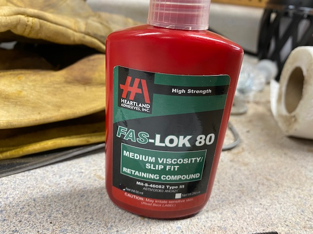

If you feel that the shaft is worn, cant you get a larger diameter seal and a smaller ID on it so it will be tighter?
Put some grease on it and force it in?
The other alternative is to have the shaft welded, then turned down on a lathe... ( lotta work)

I figured it out. I had the chain box overfilled and it was leaking. I also used a shaft to bearing seal called FAS LOK 80 IMG_0115.jpgthat I got at the bearing shop.
Lesson learned about overfilling chainbox for me.
