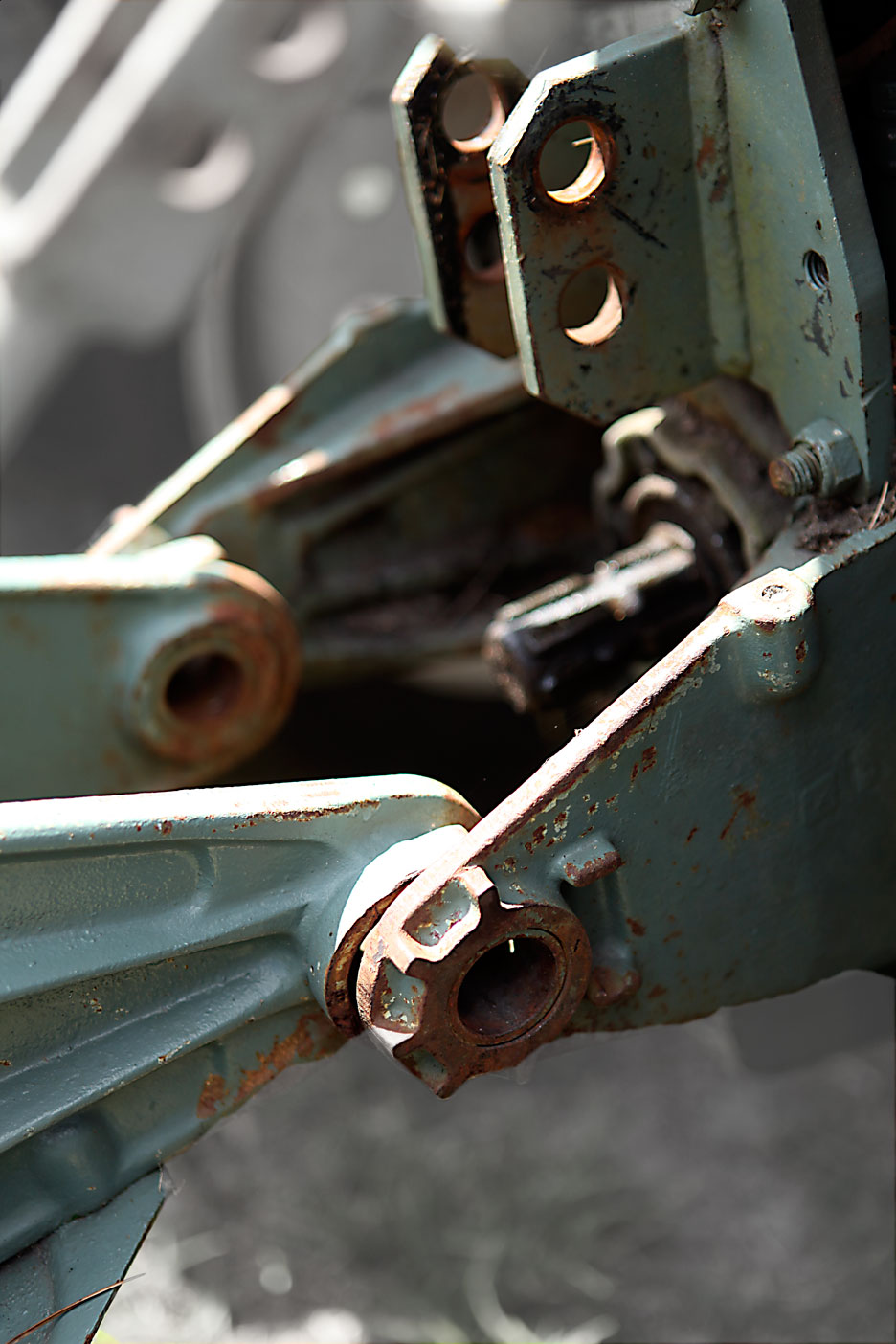

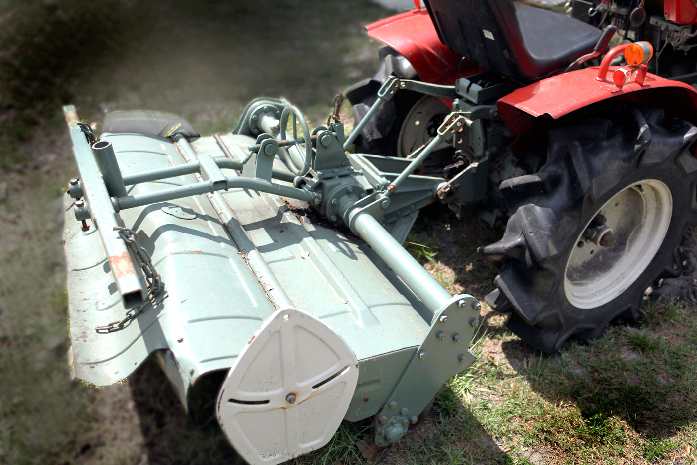

Got a tiller - make/model not known... No manual (see images)
Can't find pins for attachment. Tractor Supply (always helpful) was (ironicallly) not much help.
Attaches near PTO. (see image)
Was told that my 14HP tractor was a category 0 tractor and need to look elsewhere.
1) What is make/model of tiller?
2) Where do I find connectors?

/ YM 1401 tiller #2
Sorry, that's not cat 0 or 1. It is not even an industry-standard 3-point hitch.
It is a proprietary Yanmar 2-point tiller plus *most* of the special 2-point attachment parts that originally came on that tractor. Your tiller and tractor are a matched pair, just incomplete.
I think only a dealer with a boneyard of Yanmar tiller parts can help, nobody else can imagine what is missing.
But the good news is: Hoye sells a 3-point kit to make your tractor industry-standard. Then all implements (of reasonable size) can be attached. The price is reasonable, I think under $200.
Then it might be simpler to buy a 3-point tiller, if nobody can provide the parts you are presently missing.

/ YM 1401 tiller #6
That is the standard 2 point attach for Yanmar tillers. That looks like a 120 cm (4 feet) tiller. Chain drive and a very good tiller too. I have one. Model RS 1201 or something like that. What you are missing is the attach pins. A step pin that holds the tiller in the bracket and the pto shaft. That may be the hardest to find although there should be some available. I like the 2 point tiller and find it very easy to use and tight to the tractor. If I can I will go out and take pictures of my pins and pto shaft and post it in a bit.

/ YM 1401 tiller #10
There are 2 different sets of pins for those tillers, (long or short).
I use to have a lot of them around but we sold most of them to members here.
I might have a set of short ones left in a corner somewhere. I will check it out.

/ YM 1401 tiller #14
I don't understand why a set of bolts couldn't be made into pins. If I couldn't find the correct prices for a reasonable price, I would get an M24 or 7/8" or whatever sized bolt it is that fit, and convert that into a pin.
/ YM 1401 tiller #15
The pins for the 2 point mount at tractor are a larger diameter tapered to smaller diameter on the end.They also have a grease zerk with a hole to grease at the housing.They also are not to long to get in the way of the PTO shaft,with just a pin to hold them in place.Very cool design.
