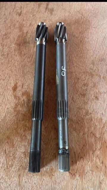

The axle without the bearing on is broken, I super glued it on just so I would not lose the piece. Thought about welding it on, as the bearing just needs to slide over that section.
I did get a quote for H&E Gear to make a new one, so the high end will $625, I am hoping someone will have a used axle, for maybe $150 to $250.

Oh yea the bearings are a simple fix at about $10 each from SKF 6304 deep.

On the YTOG, there was an outfit in Greece making splined shafts for us in 2 weeks time for over a year. We just haven't heard from the outfit in a while though. A complex splined shaft was about $80 if I recall.
Paouris Parts
Contact Enea
pick Yanmar on the main page, then search via p/n
BTW, do you need the bevel gear too?
re-manufactured on the left and the broken one on the right.

BTW, you picked out one great bearing based on the bearing standards and material. I would consider you an engineer.

This is a great lead, but I don’t know any Greek. I will take a look at the YTOG site and see if I can find any references. I did go to the link for the parts website, but it is all Greek to me. - Thanks
