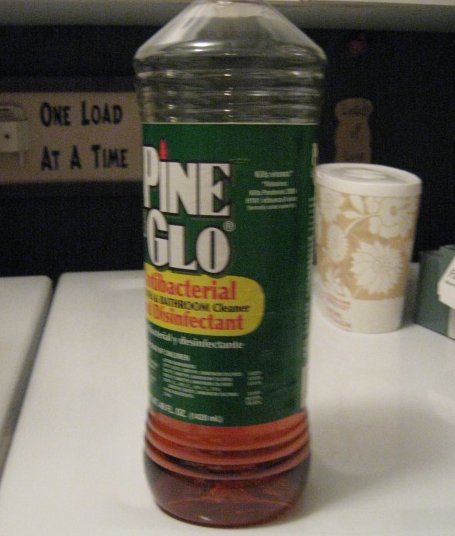

when I got my 1700 3 1/2 years the reservoir bottle had a dime size hole in the bottom corner ( the side against the radiator ) the hole almost looked burned through from the heat of the rad, but i was also aware the bottle was over 30 years old so it was brittle as well,
I redone the tractor but couldn't find the resource to get a replacement, so I started looking around the house and found my wifes cleaning supplies,;) I found a Pine-sol bottle that compared close to the same size as the reservoir bottle, the pine-sol bottle was of much heavier gauge and design, :thumbsup: as I said it's been 3 1/2 years now and has been working well, however I had to tape the lid to stay on,:D
Oh! BTW the bottle is 48 onces

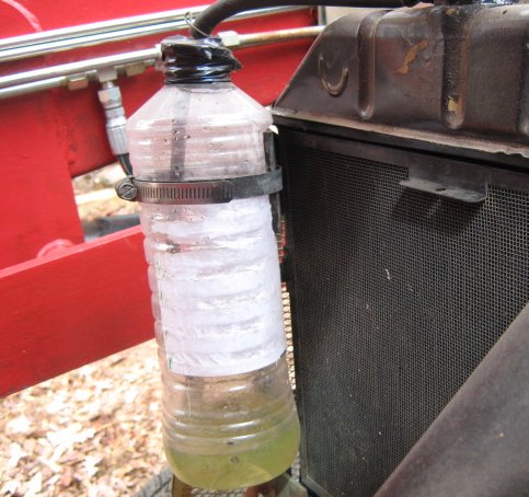

That reservoir isn't essential. It may have been optional on YM1700. Cars from 50 years ago just had expansion space above the water in the radiator and I expect your Yanmar was the same.
I tried a cube-shaped replacement reservoir and couldn't make it fit, so I used a Nalgene bottle like the ones that fit on a bicycle. (and in my case, I re-used the lid off the original cracked bottle.) A large hose clamp secures the bottle to the original mounting pad in front of the radiator.
It doesn't make any difference if it is in front or behind the radiator. Capacity: about a pint.
I'm not convinced YM1700 needs a water pump, especially because they worked fine for 30 years without one. Why add complexity? I would spend the equivalent on restoring the cooling system to original spec.

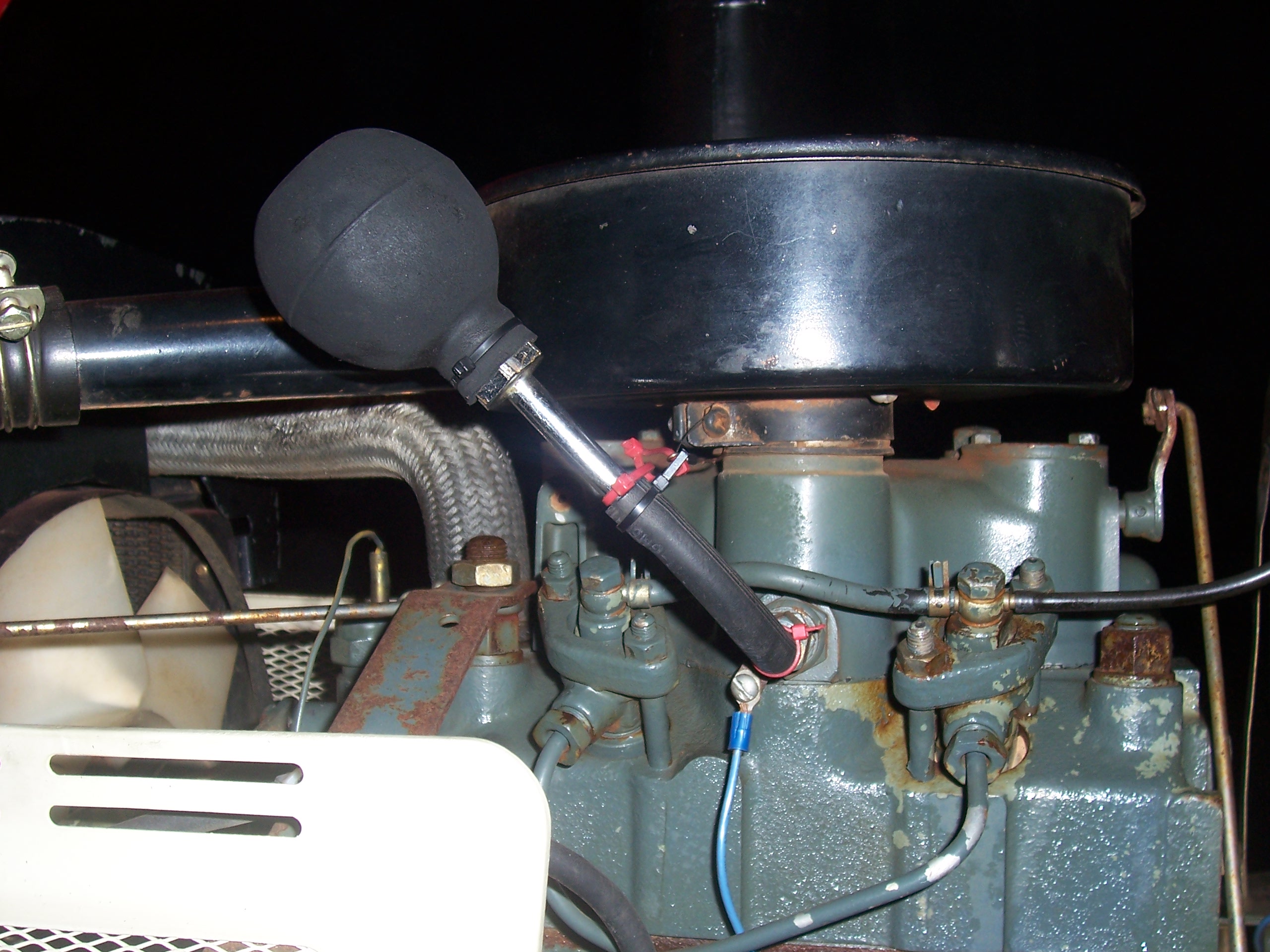

I have a Ym2000 wich has a Water Pump so I run 50/50. My guess is that with the larger cylinders,More Hp. More Heat. Yanmar decided a better or more efficient cooling sys. was needed. You can use more Antifreeze in the Winter to prevent a freeze up but in the Summer the Antifreze will not Thermal siphon or circulate enough so 25% is recomendedfor it to cool properly. Mine is under a extension off my car port. Out of the Rain and Being Disabled If it's not 40-45 Deg. My _ S S isn't gonig outside anyways unless I have to LOL. so the Temp not a problem for me. I've owned it 5yrs. now and only used the Thermo Start a Handfull of times. I don't even have Reservoir and Ghetto'ed up a Quick connect. It works:D
