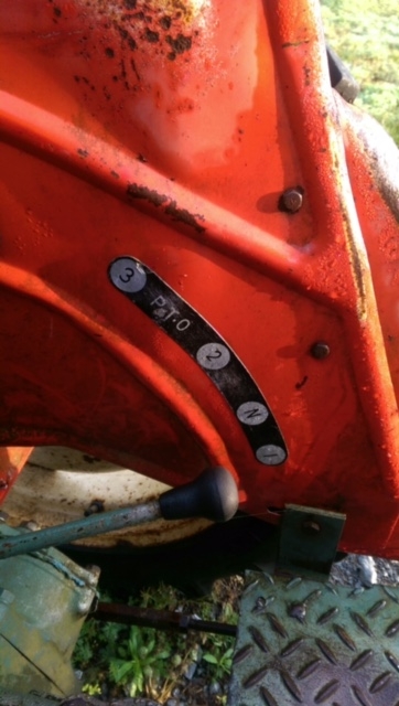

I recently bought a YM 2000. It is the first Yanmar I have owned. It is used exclusively by my brother at his place. I have zero seat time.
He called me recently and asked why the tractor has 3 PTO speeds. I told him he was mistaken, tractors don't have 3 PTO speeds. He sent me the attached picture of the PTO lever which shows 3 speeds and neutral. He said that it indeed has 3 speeds. He operated the PTO in all of the three settings and each was a different speed. He does have a manual, and it only mentions two PTO speeds for the YM 2000. Any insight here would be appreciated.

from the parts manual: 588/730/1260 rpm. I believe these speeds are achieved with engine at 2200rpm.
/ YM 2000 PTO Speeds #4
730 of there abouts is commonly meant to give 540rpm when used at a lower engine speed to save fuel
/ YM 2000 PTO Speeds #5
On my 2000 I run 1st. gear at 2100-2200 but now I have my 2nd. gear working and staying locked into gear I run my Eng. speed @ about1600-1700 which comes up to 561 PTO. Also since I'm a straight drive It only takes a few second of a wait to be able to shift gears now. Which makes it a lot easier to mow. I can shift into 3rd. PTO but found no use to so far....

PTO speeds - Yanmar Tractor Support Message Board
1) Nominal 540 RPM at full throttle
2) Nominal 540 RPM specifically when used at 3/4 full throttle
3) Nominal 100 RPM when used at full throttle
There's a typo there that could be dangerous to someone. You might want to correct that post: PTO 3 will be over 1,000 rpm, not 100 rpm, at full throttle.
TNhobbyfarmer, the manual usually provided for YM2000 is actually the English-language manual for YM2000's American-market twin, the YM240. YM240 has a few minor mods from YM2000 to meet US safety standards or expectations, one of these is its 2 speed pto of 540 and 1,000 rpm output @ 2200 engine rpm.
Other changes from that manual you might note: YM2000's throttle is push to slow down, not pull as shown in that American manual. And YM2000 doesn't have the over-run clutch internally in the pto. Aside from those, two-piece rear wheels, and paint color I can't think of any other cases where the manual differs from your YM2000.
Added - FYI, you might like this: Here's the original YM240 showroom brochure. Nearly 100% relevant to YM2000.

Thanks for that clarification California. I noticed the 100 and was scratching my head wondering why a higher range would be slower. 1000 makes a lot more sense.

Many older American tractors have 2 speeds including the US market version the ym240
