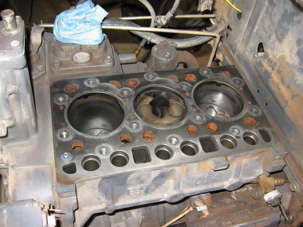

Not saying a compression test would not be in order...but...
Actually not totally the case. Tmar04 just added the secret comment. Dirty oil, not changed in a while, etc. Since the top of the cylinder has no ridge, we might be able to say the air comming in was not dirty. This of course doesn't mean the filter was not changed when it should, but if you are working in non dusty conditions, it won't suffer as bad as dusty conditions. Case and point my boat does not have an air filter, it's not very dusty on the lake or river.
But dirty oil will wear the oil ring quicker than the top rings. So yo ucan get oil bypass but still have good compression. If the oil rings wear bad enough then could break. But with dirty oil and a worn oil rings you have to look closer at the piston skirt and the lower cylinder.
If it was mine I'd still probably just hone the cylinders real good and replace the rings. Give everything else a triple check just to make sure too.
Here is a shot of my Kubota when I pulled the heat. I found a lot more wear than expected. Wear on top and I am getting some blowby. But the engine runs/starts fine and doesn't use a lick of oil. So I believe my problem is dirty air in the top end. And since I can still see factory cross hatching at the bottom, I have to guess the previous owner was changing the oil at goot times. It's all sort of a guess but I'm looking at what I have in front of me.
Rob
