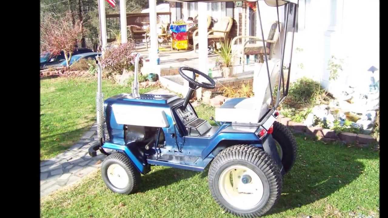

Thinking outside the box, there are seats out there being non-tractor, more durable and often additional features for about the same or less in price. These seats are in the Marine grade outdoor sports shops. On a few older Fords and the John Deere siblings of our YM-series, I've seen these being used and inquired from the folks.
Wise boat seats have the most robust and durable for less money. Attwood is the middle range of Marine boat seats. A majority of the boat seats are folding, thus offering even more flexibility on a tractor.
Before going out and just buying something, take measurements. My replacement seat is a tad further back and a tad wider. All worked well until I brought the 3PT lift arms up and got a jiggle in the seat. It's a small 1/4-inch [7mm] bump at best. So, be wise on your hunt. :thumbsup:

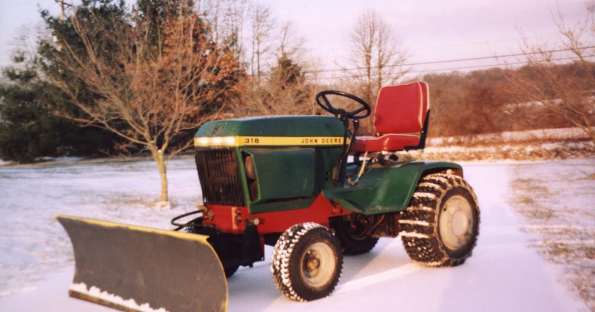

The marine seats come in various colors and patterns. This small tractor with the Marine seat is actually good.
Red on a Deere?

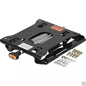

I put a suspension base under an aftermarket seat. Took a little doing but works great.
Best pictures I have the at the moment.
   / YM1100D Replacement Seat
Thanks for your input guys, I like the aftermarket seat base that gets you up a little higher.
