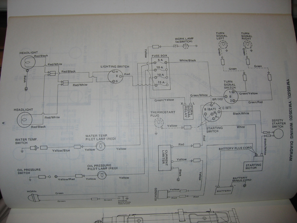

Anybody wanna help me figure out the charging circuit on my Yanmar Ym135? The wiring on this tractor is a shambles other than the starting and oil pressure circuits. I have the I&T book for this family of machines. I dont even know if the generator is working. I just got my digital meter fixed so I can start figuring it out. Thanks Mike

That tractor uses a permanent magnet type alternator. It is my understanding that it puts out the rated voltage and current constantly, and the voltage regulator or current limiter shunts excessive current to ground. If you go back through the threads, you will see you are not the first person to have issues with these. I believe that if the regulator or current limiter is not properly grounded to shunt the excess voltage, something is going to give, probably the regulator. Some of the current limiters have been incorporated into the replacement VRs. You can do some research such as Hoye and see. If you determine the regulator is bad and decide to replace it, make very certain that you have a solid ground on the regulator, current limiter or both. It is common for rust or corrosion to compromise the ground. It wouldn't be a bad idea to run a separate ground strap from the regulator to the engine block to be sure.

If the YM135 regulator is the same as the 1610 regulator discussed in an earlier thread, it is a bit more sophisticated. That circuit turns output current off when the battery is charged. There is no path to shunt excessive current to ground. I understand that is a common approach in some motorcycle or other small engine applications, though.

Here's the schematic for my 155D which seems to be the same as the 135.

Judging from that schematic diagram, the current limiter is not the same as the regulator in the 1610 circuit. It could very well be as Underwaterdog describes.

I looked at the wiring diagaram that you posted. I do not understand how the circuit works or was intended to work. I have always believed that you you must understand how anything works or is suposed to in order to make it work right. Is there a section in you manual that describes how the charging circuit works? (i.e. theory of opeation, seqence of operation, or testing) I'm looking for answers for specific questions, is the alternator output A/C or D/C, and what exactly does the current limiter do?
