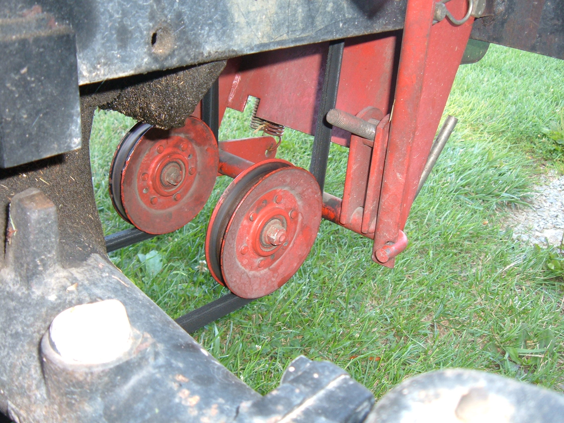

   / YM146 new owner, new to forums #15
That is the belt tensioner.That's how you tighten your belt up.The only one that Might have the parts is- Jamieson's Tractor (570)253-4810 in Pennsylvania
   / YM146 new owner, new to forums #16
That is the belt tensioner.That's how you tighten your belt up.The only one that Might have the parts is- Jamieson's Tractor (502)253-4810 in Pennsylvania

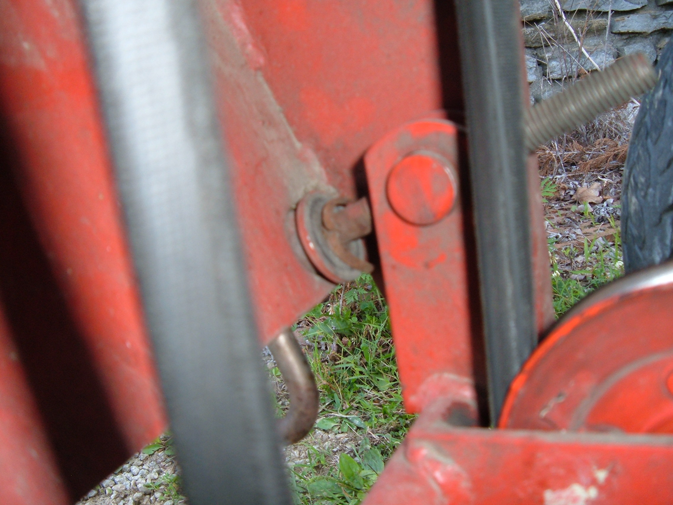

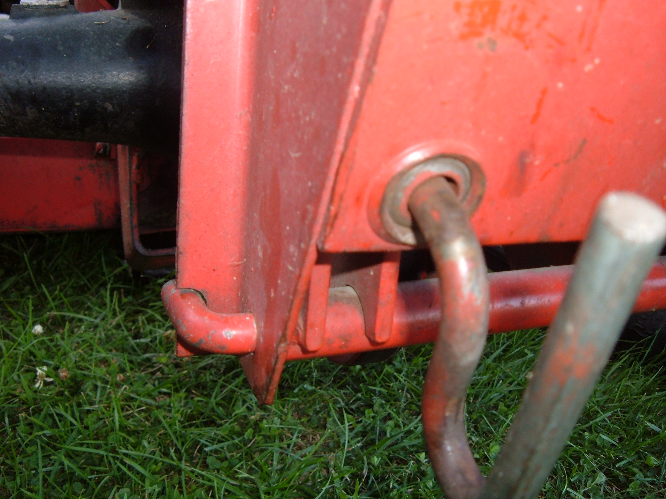

   / YM146 new owner, new to forums #17
Here are some pictures of the one on my YM186D-should be similar?

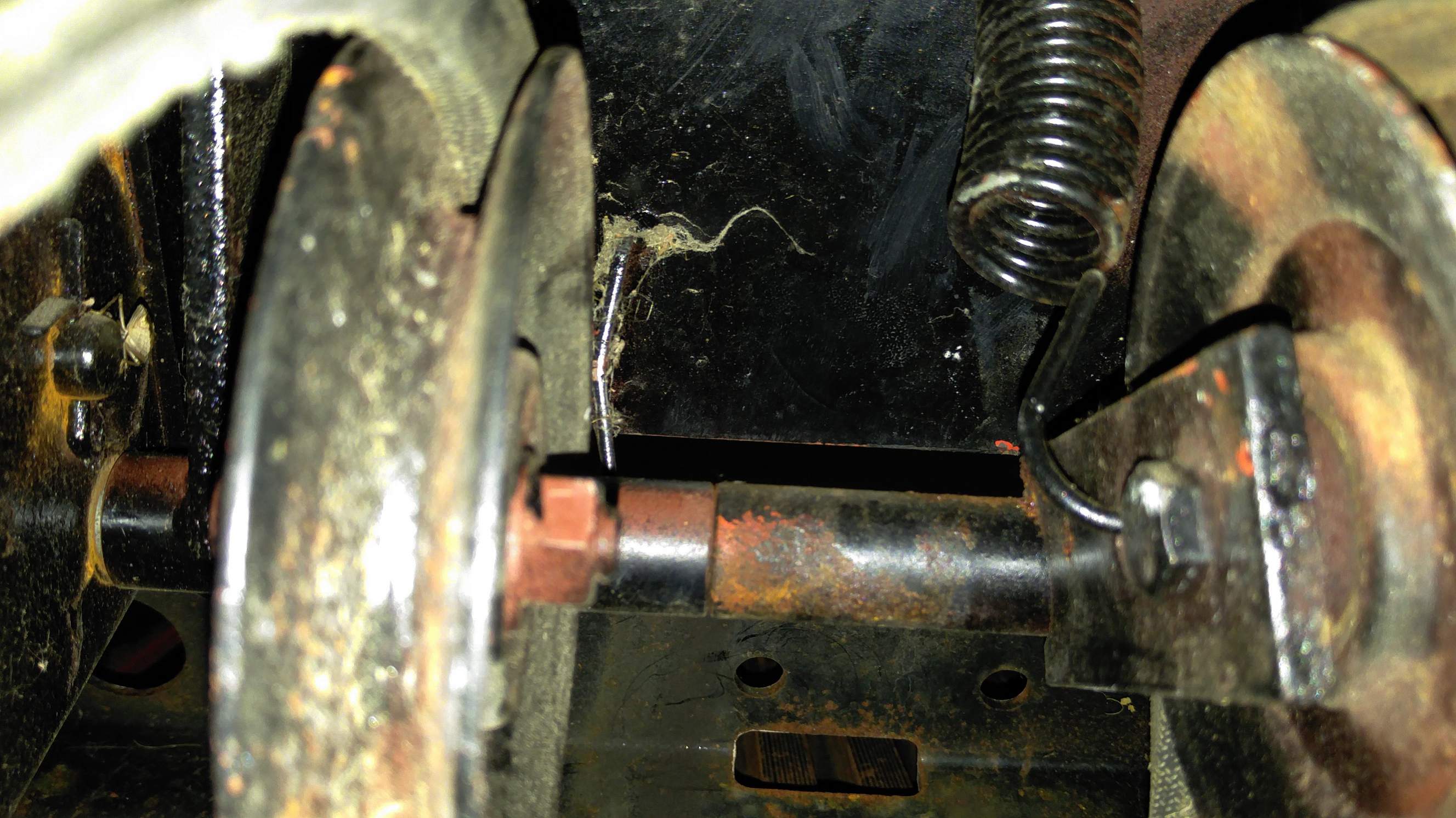

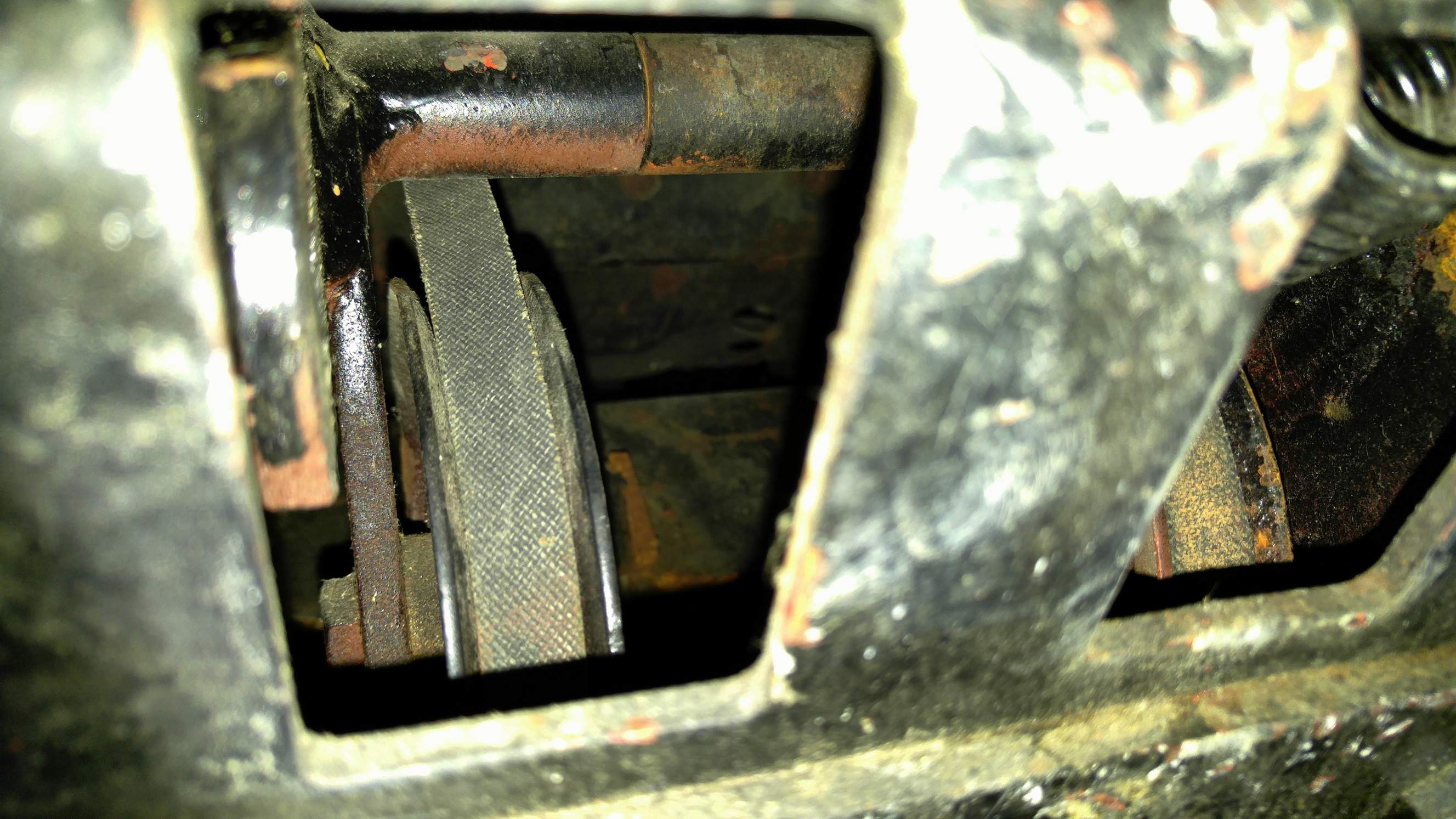

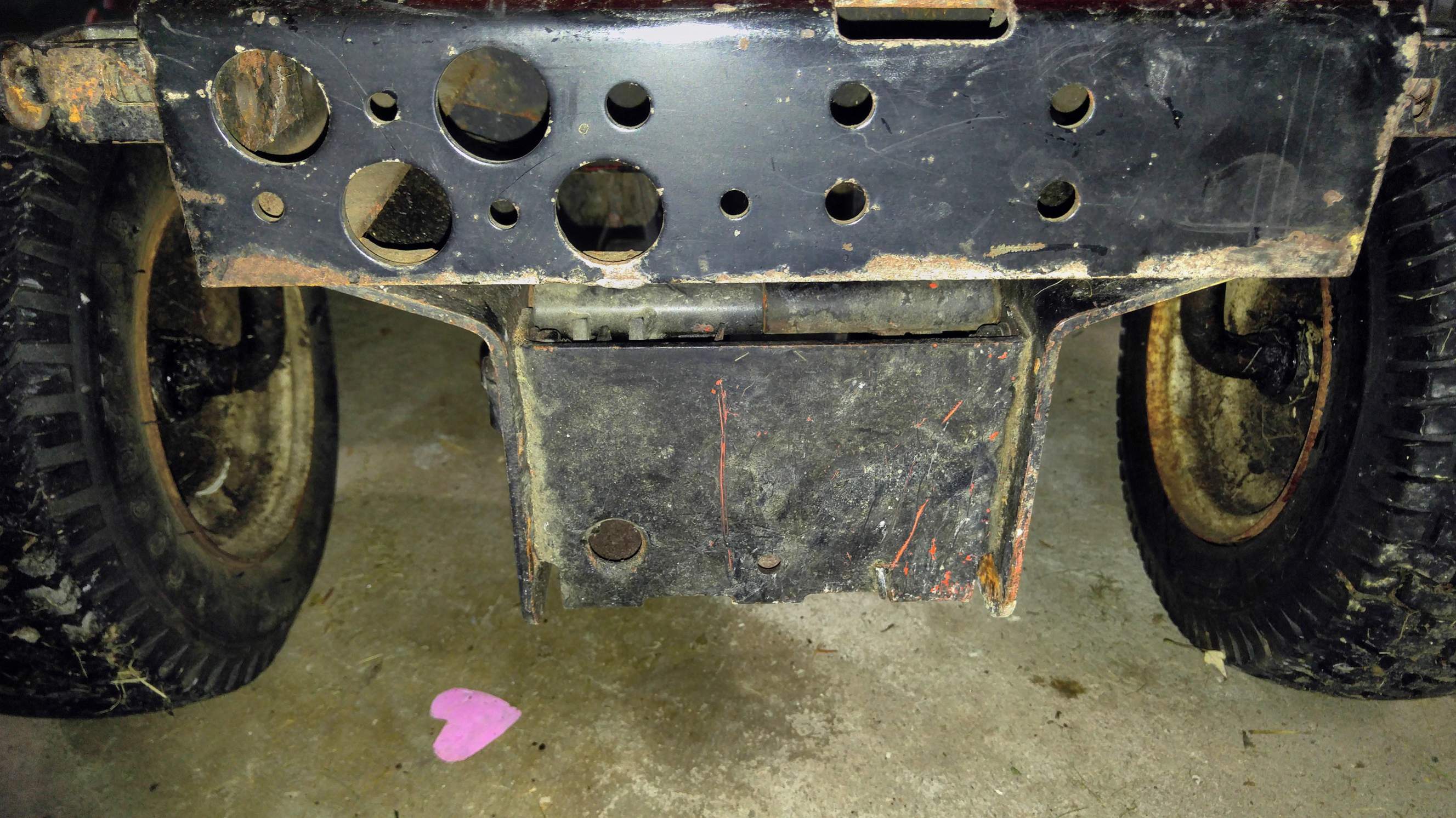

#20
My mount looks a bit different but I see where that tensioner should be attached.
