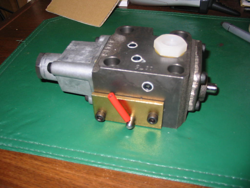

   / YM1500 3pt Hydraulic Valve Assy #15
Accodring to the info that I have, this part number has been superseded several times.
From 794151-45101 to 794197-45102-X
From 794197-45102-X to 794151-45102-X
From 794151-45102-X to 794361-45100, with a current list price of $314.50
Hope this helps.
   / YM1500 3pt Hydraulic Valve Assy #16
I don't think the 794361-45100 will fit the YM1500, I can post a picture of it if anyone wants to see it. I'm leaving in a few minutes to go to Fl, but I will be back tonight. BTW the SLP is $ 285.91 not $ 314.50.
Danny
   / YM1500 3pt Hydraulic Valve Assy #17
Danny
Please post a picture, & I will go thru our parts yard here. Maybe we have one. I just got in a partial 1500-D for parts machine. (no front end)
Ernie
   / YM1500 3pt Hydraulic Valve Assy #20
Ernie, here is a picture of the 794361-45100, I don't think you will find a used one. You can see that the 794361-45100 is not even close to being the same as the control valve on the YM1500. The control valve that Arron posted is the correct one. The one that I posted is suppose to replace the old one, but I can't see any way that it will work. The only tractor that I know the 794361-45100 will work on is the 650 JD, I'm sure that there are others.
Danny
