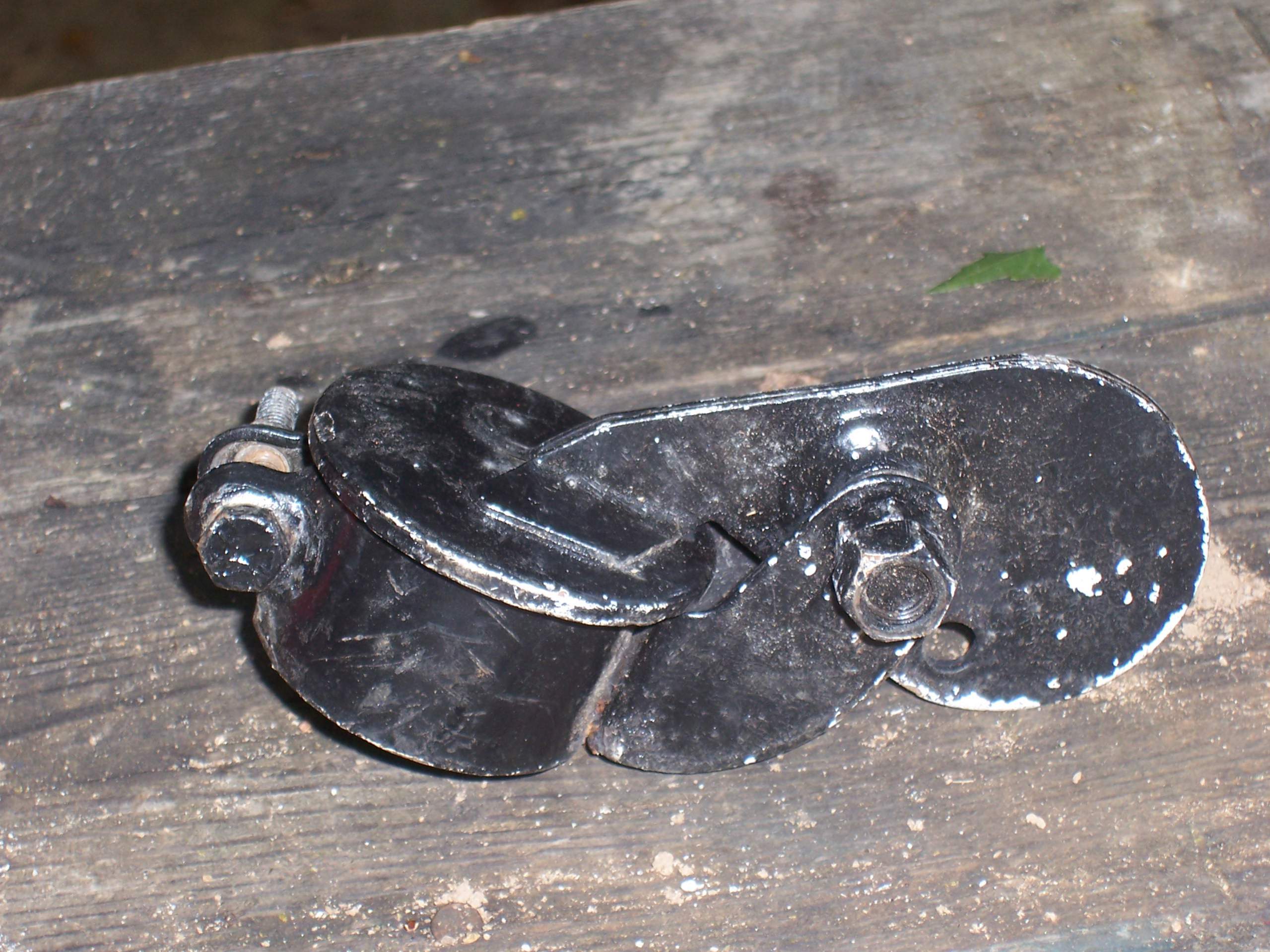

If mine, I would pull the exhaust manifold and attempt to start. A plugged exhaust can cause a no/poor start problem.
   / YM1500 wont start air escaping near fuel pump? #24
Being stored inside and I believe you stated no signs of Rodents. If you have one of these on the Muffler. Very doubtful. If so was the lid opening when trying to start it?

I pulled my muffler off the outlet piece this last week. The OE muffler looks to be cut off the original base and a aftermarket one is slid down over the pipe. It was not fitting tight and i was getting exhaust blowing by the connection so i took it off and smoothed out the rough casting on it so that the pipe would then slide down over it better. Anyway once off i rinsed it out with water and could not beleive the carbon that flowed out of the muffler. I rinsed it both ways several times till it was not flowing mass carbon out. And after all this it sits down on the outlet better but still blows the same amount buy the muffler pipe...oh well? Its just under heavy accelleration or heavy loads does it blow out the connection point so i can live with it.
Point to this long diatribe is that there can be quite a bit of built up carbon like Norm mentioned.

I get alot of buildup on my lid. Which I clean off but with no signs of any buildup in the muffler after 7Yrs. That was last year when I removed the Muffler to see about pointing it forward and try and keep the Exaust down. I would of had to cut up the Muffler an shorten it to keep it from sticking out past the front bumper. Deciced that was probly not a good idea and I definatly wasn't cuttin it up. Not that bad of exhaust smoke to justify it.
