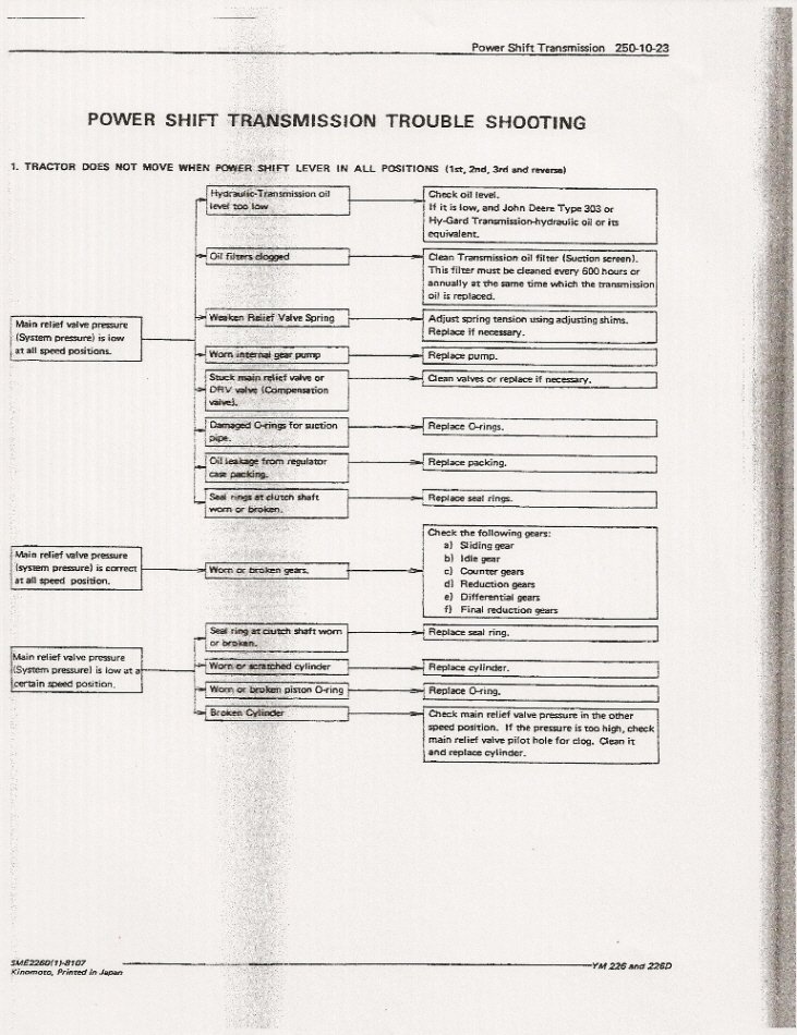

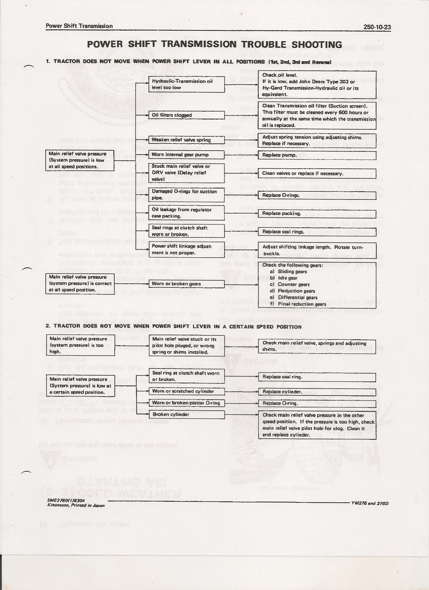

Main relief valve seems to be the one mentioned in the 276 manual for your problem. Sending you a pm.
