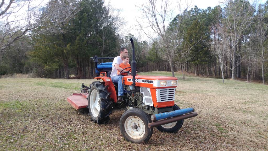

Ok reverse the lengths of the pipes I listed. The solid steel one is the longer one. The lead filled one is the blue one.

Thanks.. that looks good. I should be able to make something like that

When I bought the first YM186D - the one without a loader - I found four front bumper weights that were intended for a much larger tractor. Seller didn't know what they fit so they were cheap. I added a chunk of 4x6 wood with metal angle iron (to resist wear) to fill in the gap and match the height of my much smaller front bumper. In the second photo I also added a chunk of railroad rail- my second anvil - to increase the weight a little more.
In my orchard I need the tightest turning radius possible to avoid the trees so this narrow ballast worked better for me.
Photo 1
Photo 2
Photo 3 (A city friend wanted a 'country girl' photo for her Facebook :p). This shows weights off an exercise machine added in that front gap.

ones from John Deeres from the 80s and 90s will fit. The like 790, 850,855, 1050 all those family of tractors. They really are just green yanmars. But you probably wont find many of them and they will be expensive. If you can find a farm with junk laying around or you know the guy you might find some there. But they do cost a good bit when found at auction or to buy new.
I have done what California has tried to avoid with a narrow set up. While turning i have clipped a tree or caught the front of stuff sometimes. But only in turns as the tires are still wider than the pipes.
