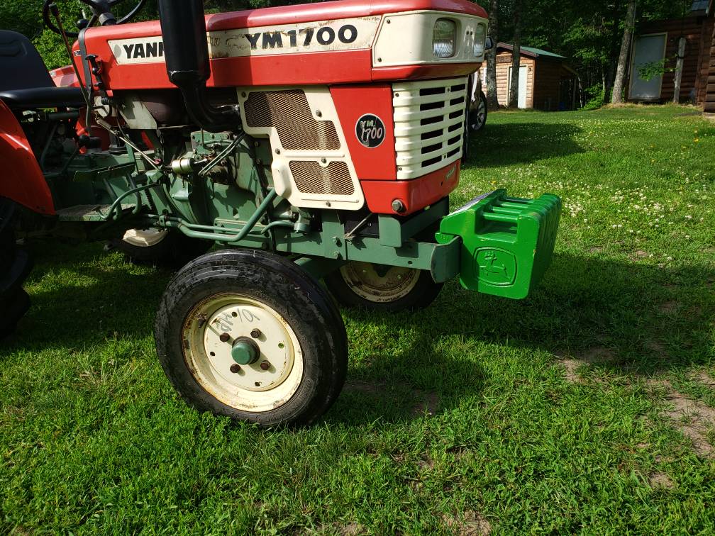

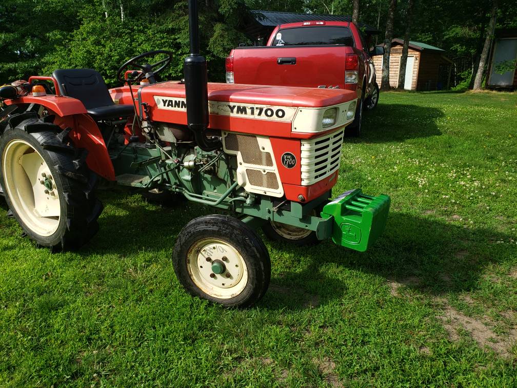

well I bit the bullet and went to my local JD dealer and just bought some. (I figured that if they dont work correctly they will let me return them) I am heading to the property in the morning so I will post up that. I also have to install my overrun clutch I got from you Aaron. I am excited to try them both.
   / YM1700 and a 60 inch finish mower
#23
They fit on perfectly. Very happy with results. 20190629_091121.jpeg20190629_091118.jpeg
   / YM1700 and a 60 inch finish mower #24
The look good. Paint them Yanmar green now and Bondo up that deer! Haha

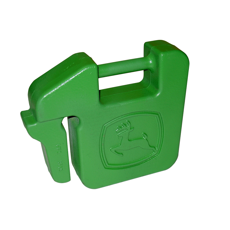

You get FREE shipping to any Lowes store for pickup for the same price. I have 2 of these already. :) My YM2610 does have the 6ft Brush mower from King Kutter. Without the weights, the front wheels get off the ground if things bounce. With the 2 weights, 84-lbs, it tames everything. The front bar can handle 6 of these weights.
https://www.lowes.com/pd/John-Deere-Suitcase-Weights/50292597

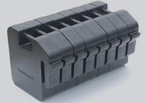

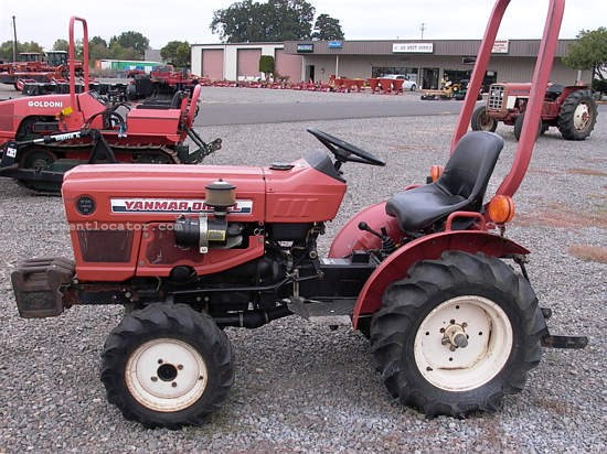

I just added the BLACK Yanmar weights to the above posting. Just in cause you wanted the weights to be more Yanmar color matched. :)
Here's one with faded and lite rusty Yanmar weights.
