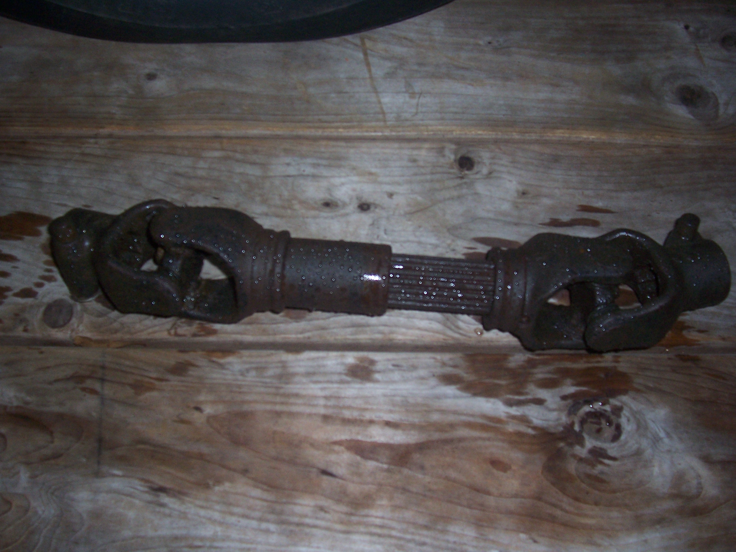

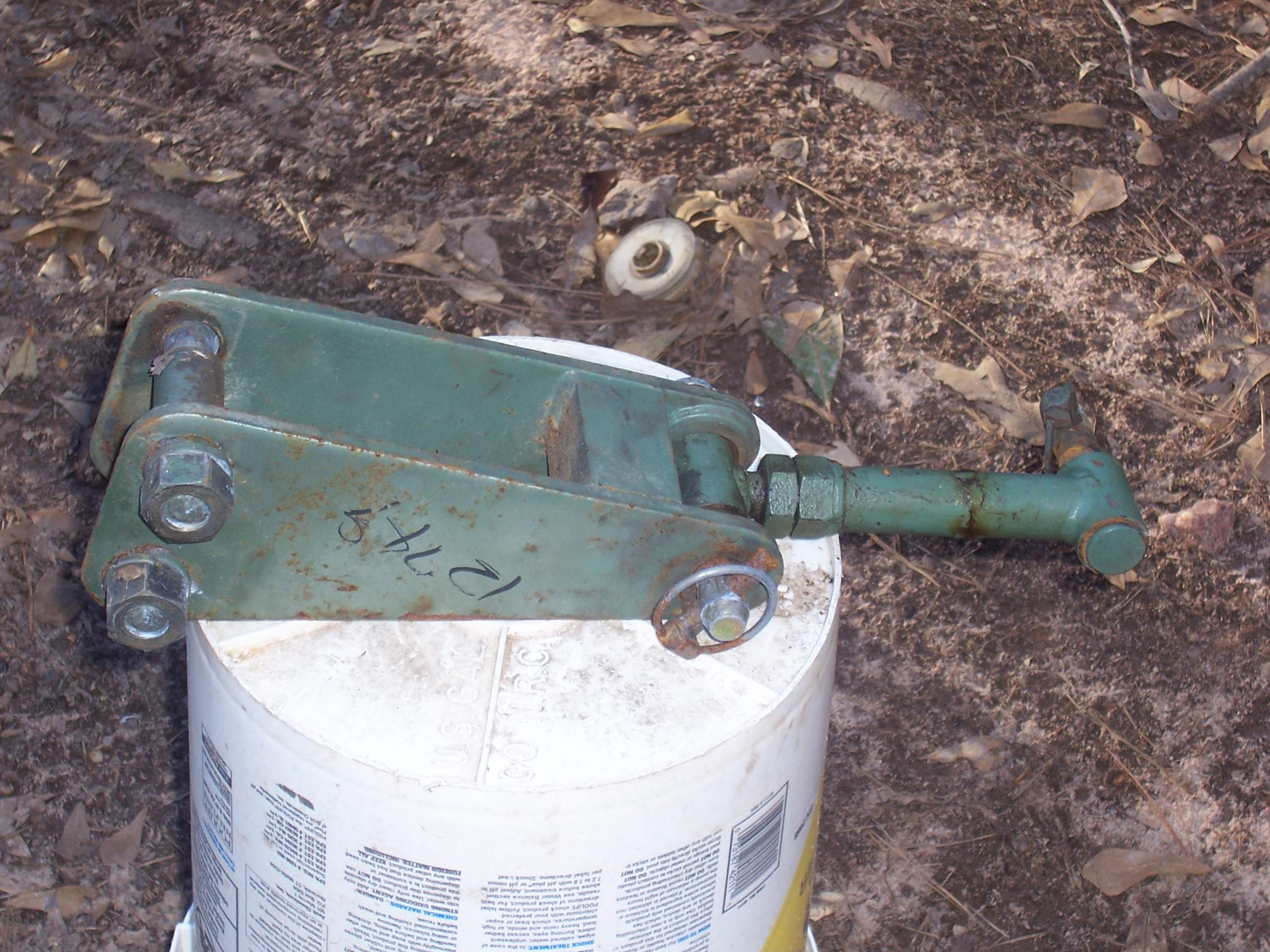

2000BD is a nice model, a good choice. I hope the roll of dice on quality comes up in your favor.
Tillers: Just look for the simple stuff. They are near indestructible. But get an exchange warranty in case the internal gears/chain are torn up. (Not likely, but maybe nobody inspected it).
Be sure the tiller includes its driveshaft.
And be sure to get the special top link that the tiller requires. This is a rigid 'bridge' that clips on the back of the tractor and goes halfway back, then a short (8-10 inches) upper link that goes the rest of the way back. You can't use a regular upper link because with that, lifting the tiller pushes it right into the tires. And don't accept a tiller with a new set of lower pins welded on farther forward, which was sometimes an owner's attempt to fix this lift problem. That 'fix' would need a new longer (expensive) driveshaft.
Be sure it has a full set of tines. The original tines are great. Replacements are expensive and can be poor to fair quality.
Drain the tiller and replace with fresh fluid (90 wt gear oil) no matter what they tell you. These were run half-submerged for 20 years then sat in a scrap pile for another 10 accumulating condensation inside. There's sure to be some water mixed in the oil.
Plan to inspect and repack the lower off-side bearing (same as packing a wheel bearing). A few of us have found water in there.
Enjoy!
   / ym2000BD is the price right? #75
Thanks California that would have taken me all night to go through. I do have a pic for the top link. Went Through the Wrong Dr. shaft. I'll do Survey1 a favor and show him what the correct one looks like for a YM2000 which the Rs1400 was Factory for it. I'll see if I can find my pic. of what it's not supposed to look like also:mad:
