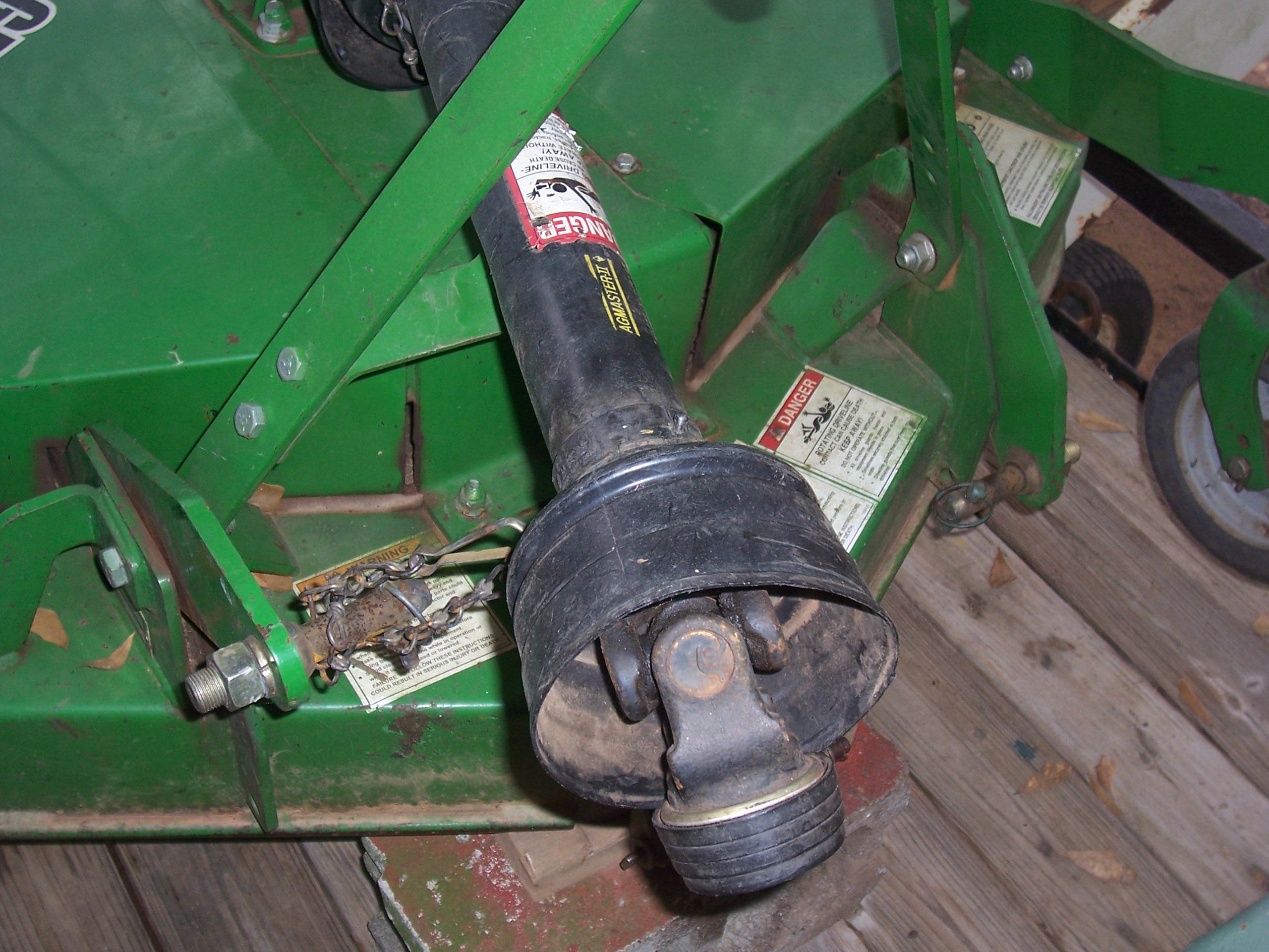

Here's my Fm setup DND. Works great. The one on the left is all the way up. On the R. to Mow.
