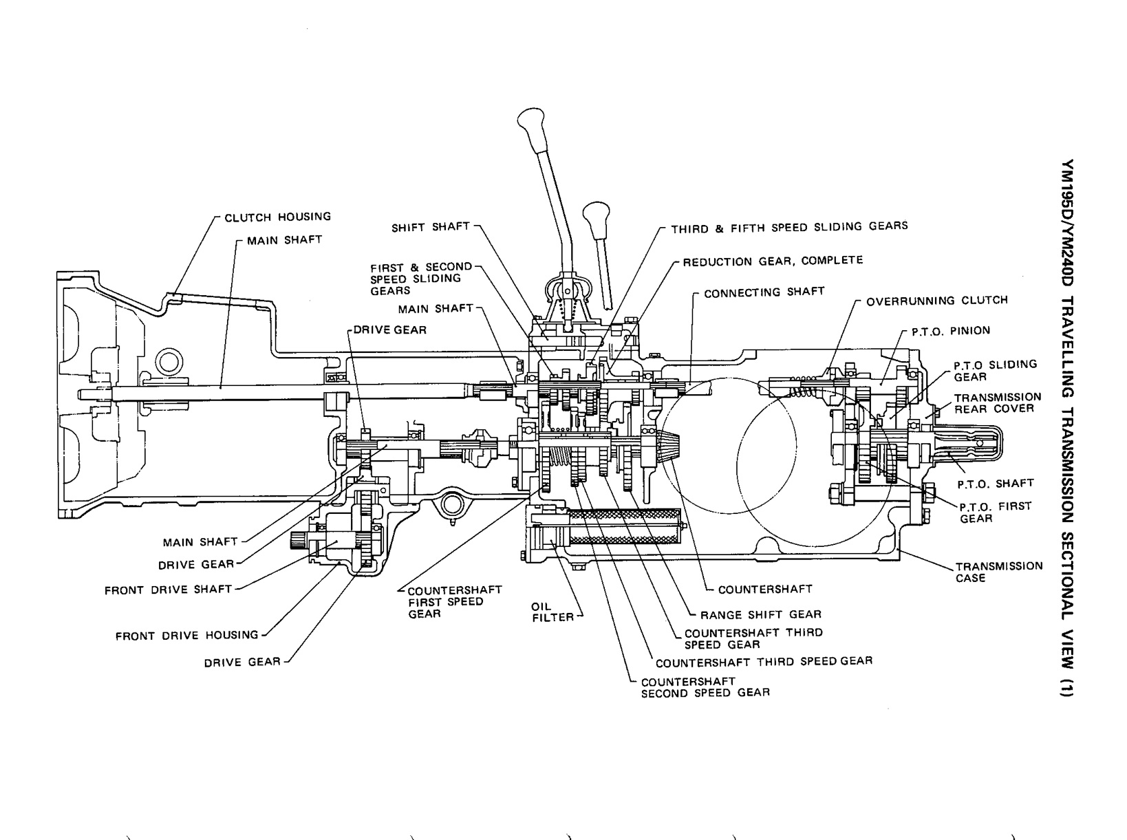

Here's a cross-section of my machine. Maybe that helps?

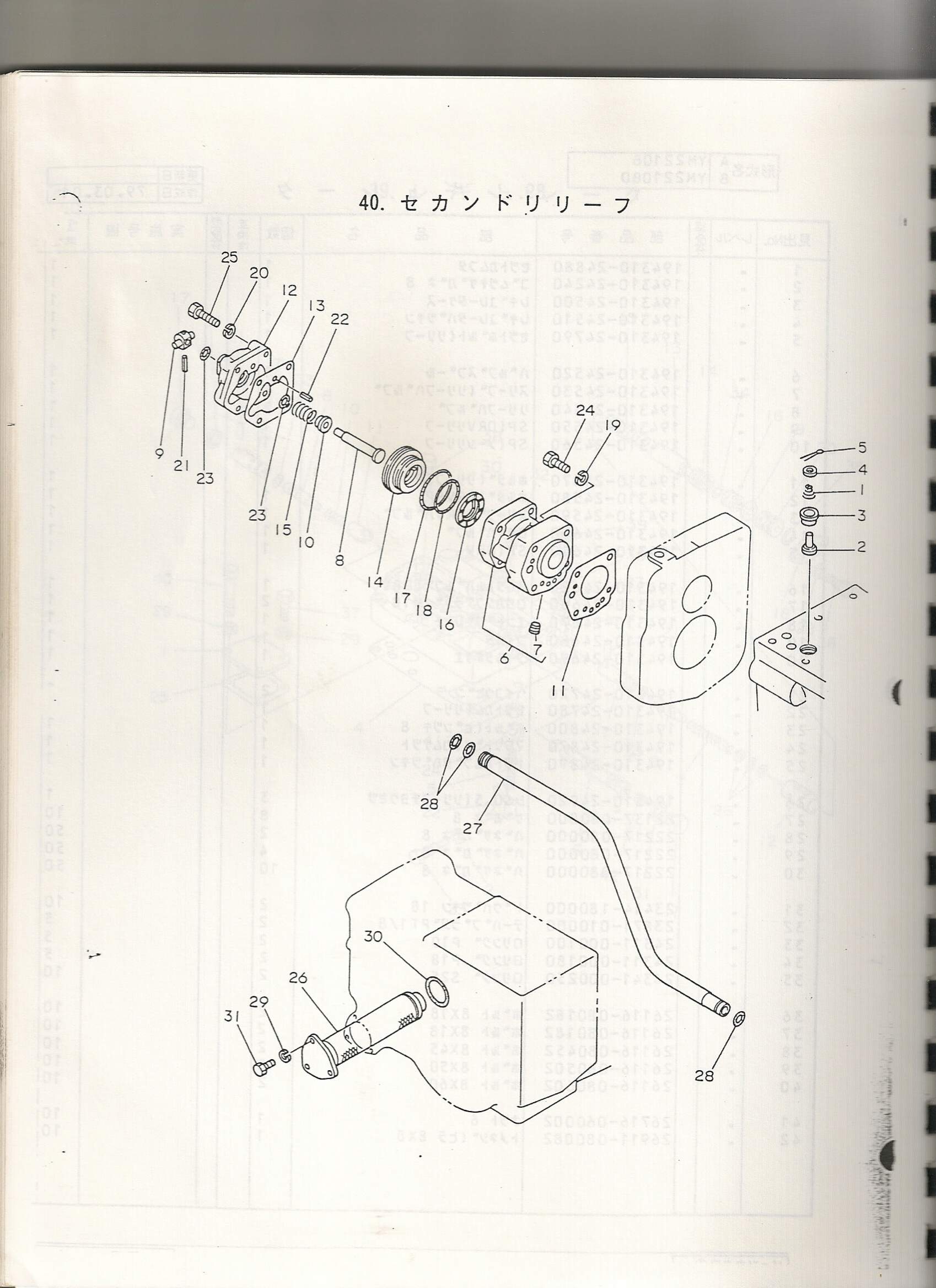

Out of the 2010 manual.

ufengineer, I owe you an apology. I copied the wrong page. The one I copied was the 2210. Only difference is yours has the 2 bolt flange. Same place though. Sorry I mislead you. :ashamed:
/ YM2010 Transmission Screen Location
#13
Thanks Winston. This model has a cover with two bolts. The two vs three bolt cover is what was throwing me off. Apparently most models have a three bolt cover and only a few have a larger circular cover with two bolts. I was one of the lucky to have one with the latter.
