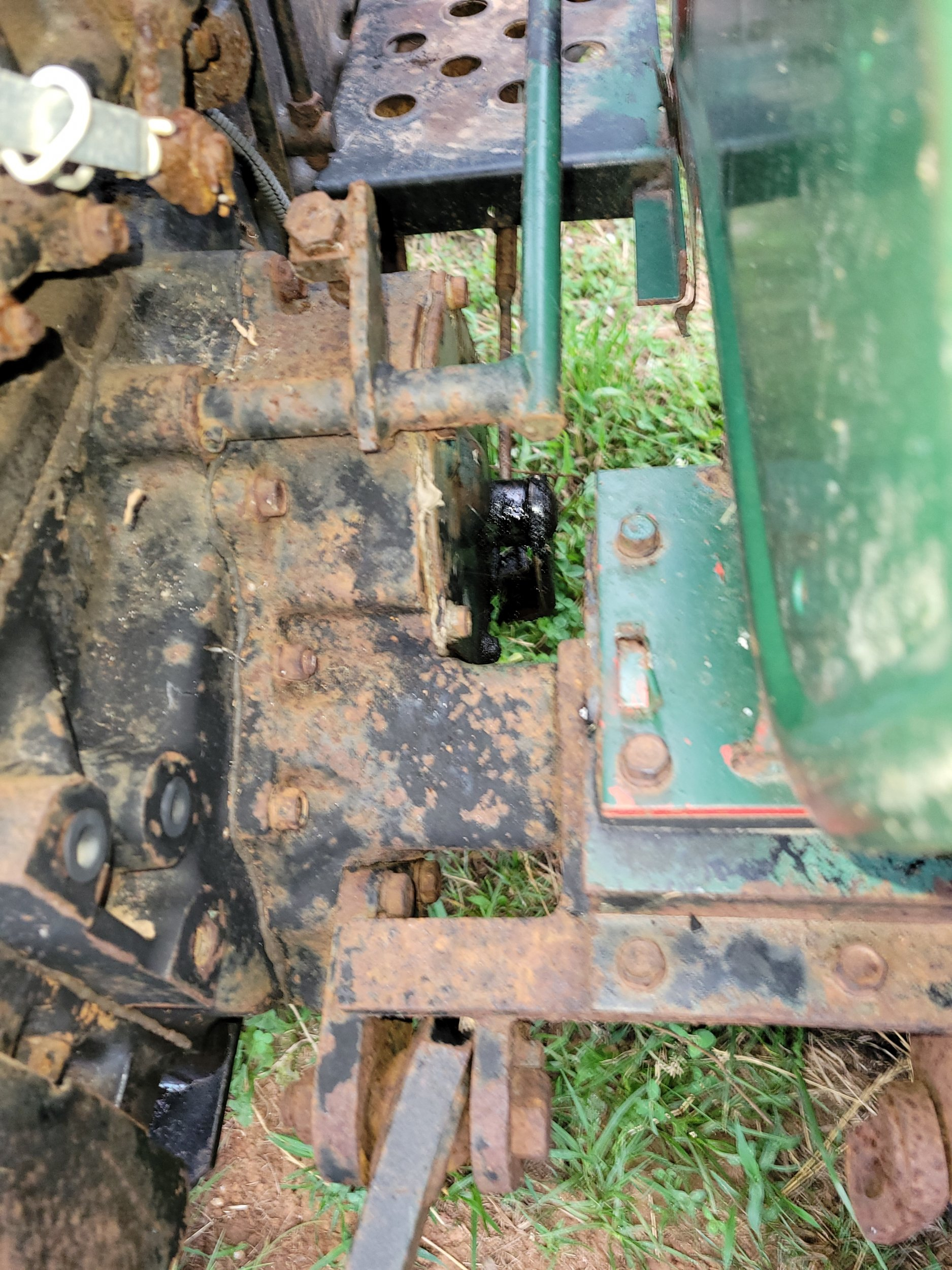

Next up for this tractor is looking into the hydraulic system. The PTO turns fine but has a small leak. The 3PT lift doesn't move. This appears to be because of a lack of fluid. It's not reading on the dip stick. I have what appears to be hydraulic fluid coming out of the break housing on the right side. I'm hoping this is just a seal or two.

Looks like I was wrong in post #24. After replacing the copper washers on the banjo bolt at the injector pump, the tractor ran good for a long while. I'm no longer leaking fuel at this fitting. However, periodically have to open the bleeder bolt and let air out. That first day, I ran the tractor probably an hour (maybe longer) without any issues. Now, I'm having to bleed just the one bleeder valve at the injector pump fairly frequently. Too often to be able to use the tractor in any meaningful way.
