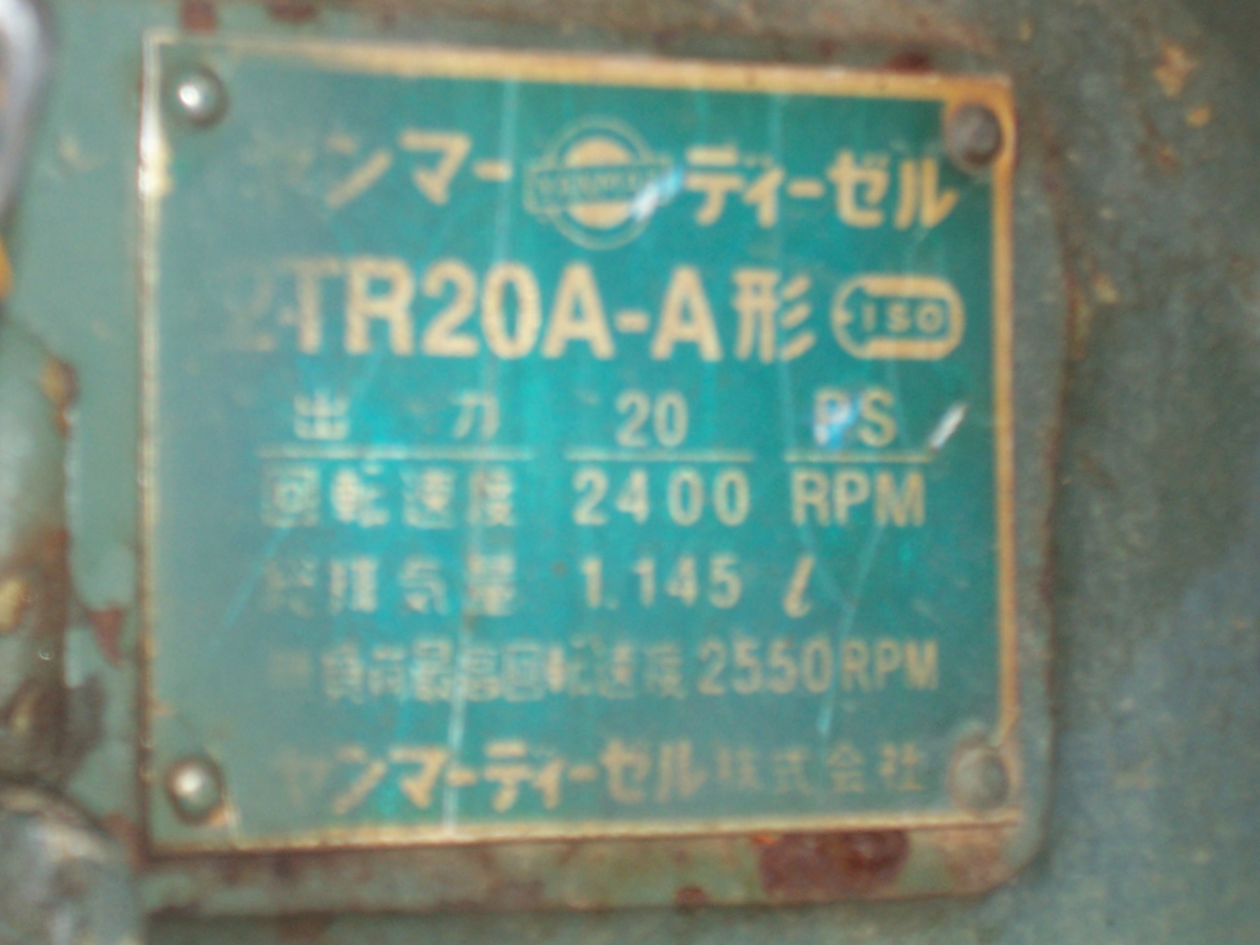

2TR20A-A on my 2000. I've owned it 6Yrs. come Feb. And still have only heard of 1 Maybe that has a "-A" but I believe it was Prob just 2TR20A. Anyone :confused3: Here's a Pic. It's without a doubt Orig. The touch up paint was me.
