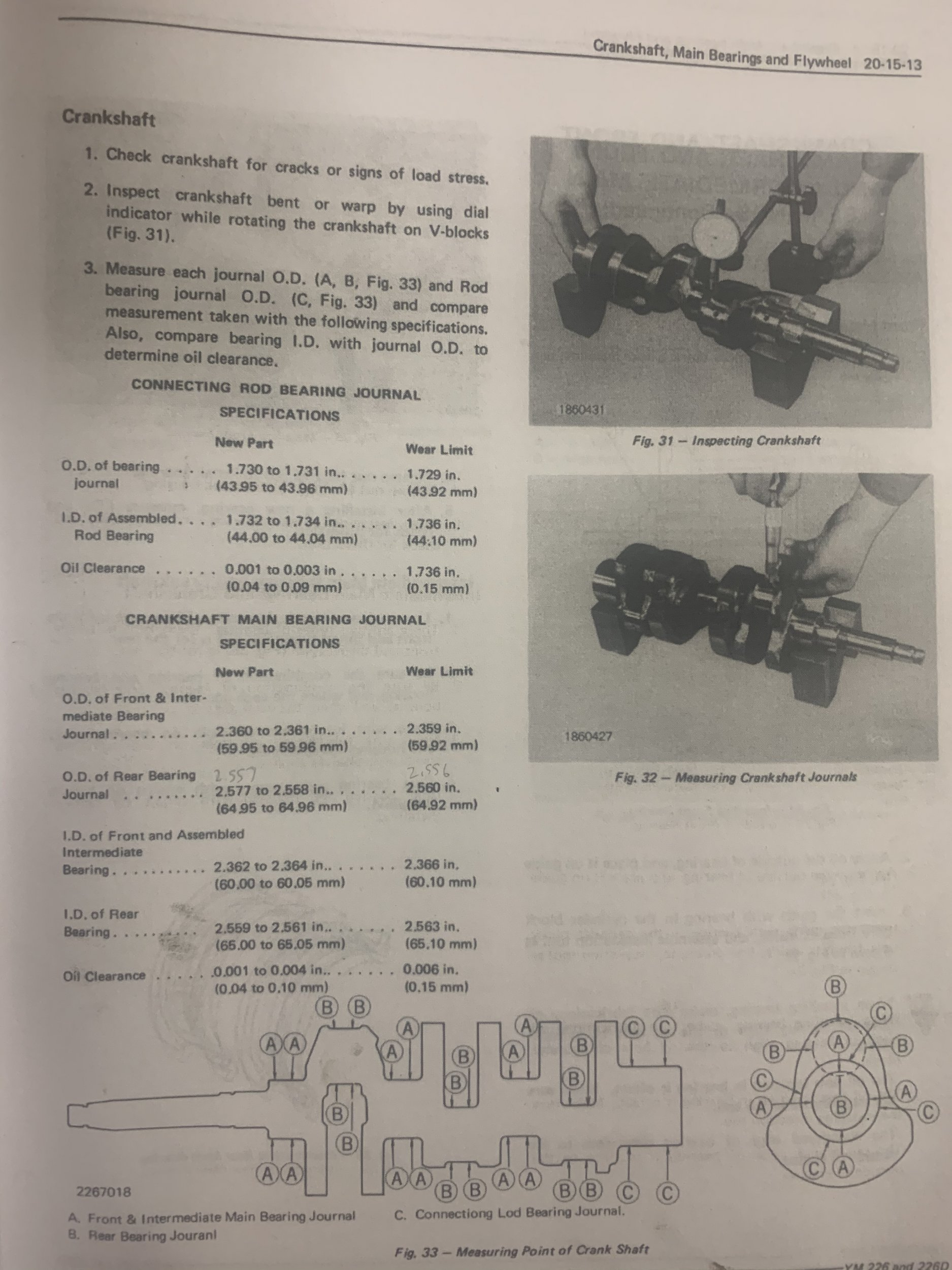

After taking the intermediate bearings off I cleaned the crankshaft and set out to begin inspecting/measuring it to see how far out of tolerance it would be. I ran into a few issues that I'm hoping someone here might be able to help me clear up. Here is an image from my manual:
For the connecting rod bearing journals - everything seems ok. The manual specs make sense and I am getting measurements on the crankshaft of 1.7301-.17303. I will do a full work up checking size in several directions to make sure nothing seems off later, but for now this is the least of my worries.
For the crankshaft main bearing journals I am very confused.
1. For the OD of rear bearing journal, the imperial spec appears to have typos. The manual states 2.577-2.558 with a wear limit of 2.560. Those numbers don't make sense so I checked the metric specs listed and realized there appears to be a unit conversion issue. The metric specs when properly converted state 2.557-2.558 with a wear limit of 2.556. I am getting measurement readings from 2.5430-2.5575. These readings reinforce my theory that a unit conversion mistake was made, and it makes sense the range is so wide because I can see/feel ridges and my previous videos show how much slop there was between the crank and block.
2. For the OD of front and intermediate bearing journals, the spec appears to just be completely wrong. It is listed at 2.360-2.361 with a wear limit of 2.359. I am getting measurement readings in the range of 1.8470-1.8486. If the spec were correct it would imply that I wore this journal out by a half an inch. The driving factor for why I believe I didn't wear these journals out that bad is the fact that the rear bearing journal mentioned above is only wore out on the order of .015". I don't think it's possible to wear the intermediate journals .500" and the rear only .015", but maybe I'm wrong? The metric spec matches the imperial spec so there doesn't appear to be a unit conversion issue. Any thoughts on what's going on here?
Thanks for the help!

YES, there are type-o's in the manuals. rScotty has made mention of this a few times in the forum here. Glad you have a good eye and a pocket calculate to either multiple 25.4 or to divide by 25.4 to get one direction or the other in the imperial system or metric system.

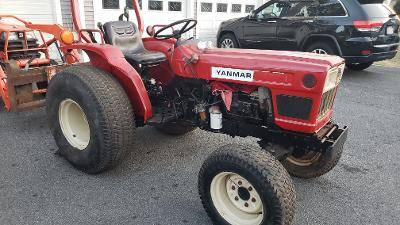

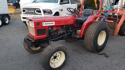

I've been searching all over for various options to keep this project moving forward and have found little as far as tractors/engines for sale go. I've been checking ebay, craigslist, tractor auction sites all over the country and then this just popped up for sale and is less than an hour from me.
It's the exact same tractor (ym226d) and visually is in way nicer condition than mine. I spoke to the guy selling it and the engine is currently being rebuilt but he has everything to complete the rebuild. The story is that the previous owner used starting fluid to get it going and cracked the rings. I was told the injectors and pump were just rebuilt and that he has the new pistons and rings to put in it. He said the cylinders were fine, although it doesn't seem like the sleeves are hard to replace, and as far as he knows everything else works. The tractor has 400ish hours on it and he is asking $4500.
Compared to spending over 3k in parts, this seems like a way better deal but I'd love some outside opinions if anyone has one. If I purchased this tractor my plan is to make my current tractor the parts tractor and get this new one running. I would move the hydraulics/loader over to this one and end up with a ton of spare parts to either keep on hand or sell to recoup some costs. I think I would come out ahead as far as being invested about 5k into a complete and running ym226d with loader and rops plus a parts tractor, but I'd love some feedback. Thanks!

The sleeves are simple to replace with a hydraulic press and a good 48 hour chill down in a freezer. Ideally, the engine in a cold winter night and the sleeves pulled out for an early morning install is the perfect way to go.
I would believe you would be far ahead because there would still be a parts machine. :)
The key is to get at least 50hours on the rebuilt machine to know for certain its going to hold up. :)
/ YM226D Project #78
... being invested about 5k into a complete and running ym226d with loader and rops plus a parts tractor, but I'd love some feedback.
I would do it. Those tractors are hard to find, especially as nice as your combo tractor will be.
