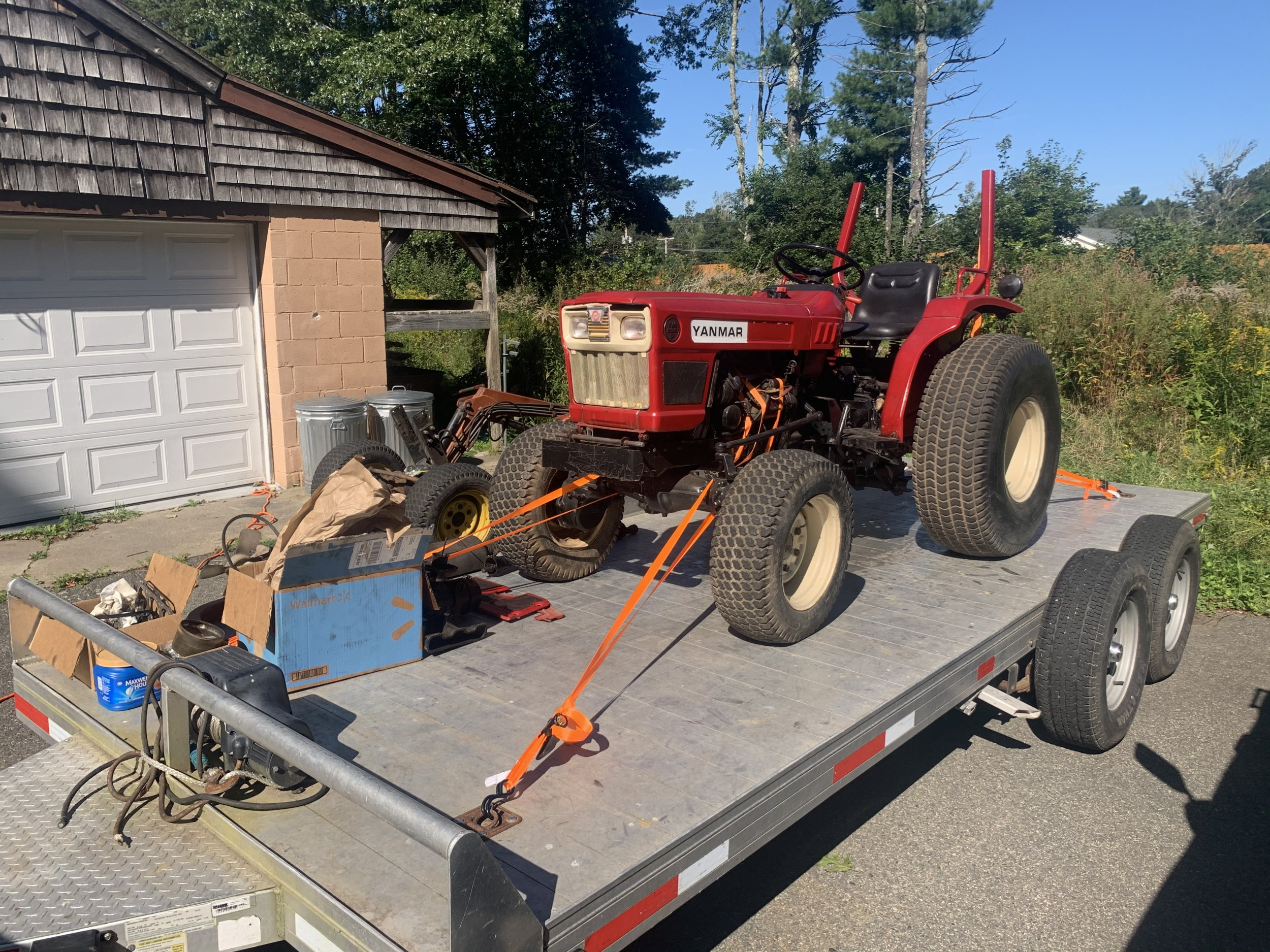

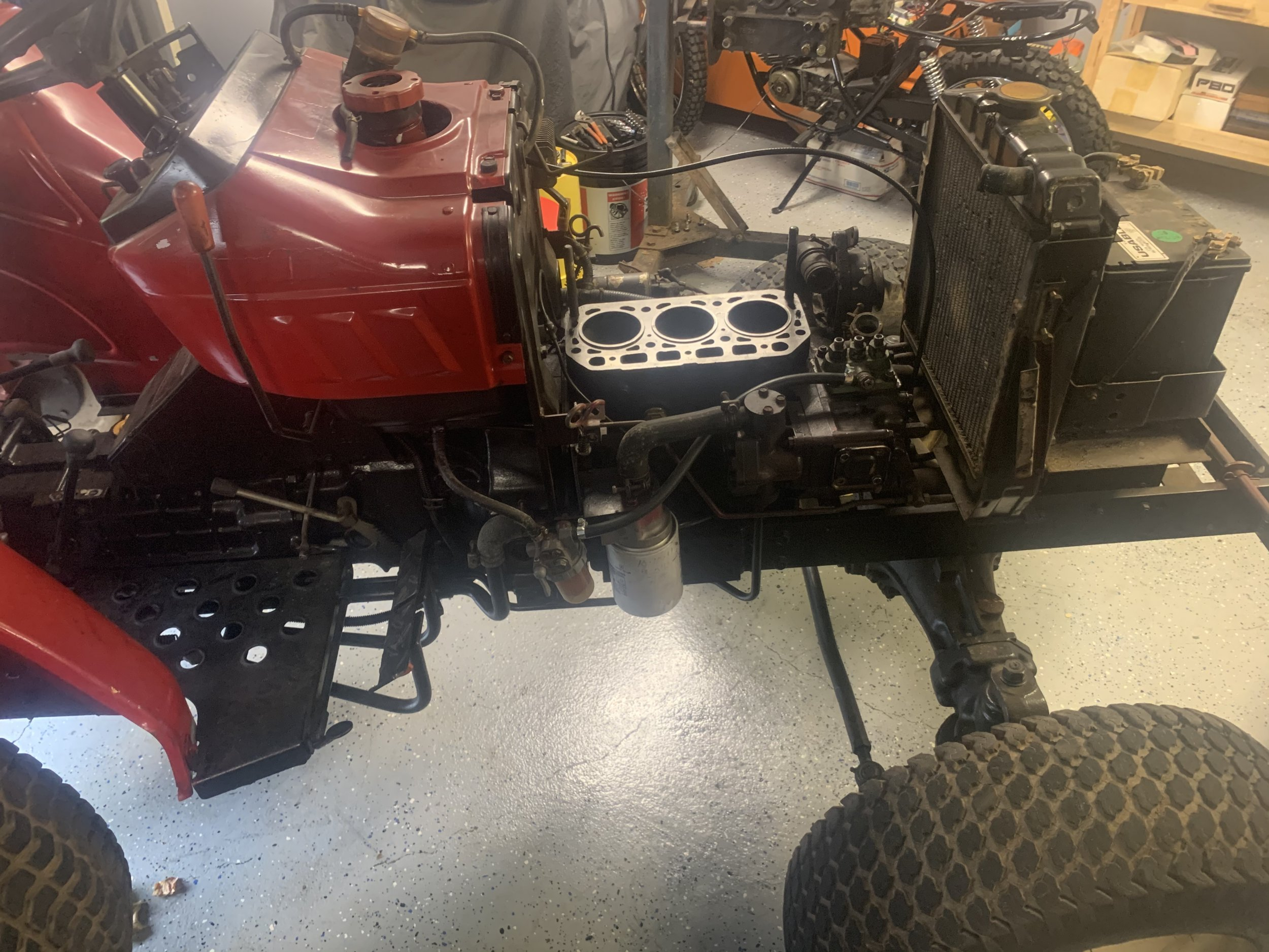

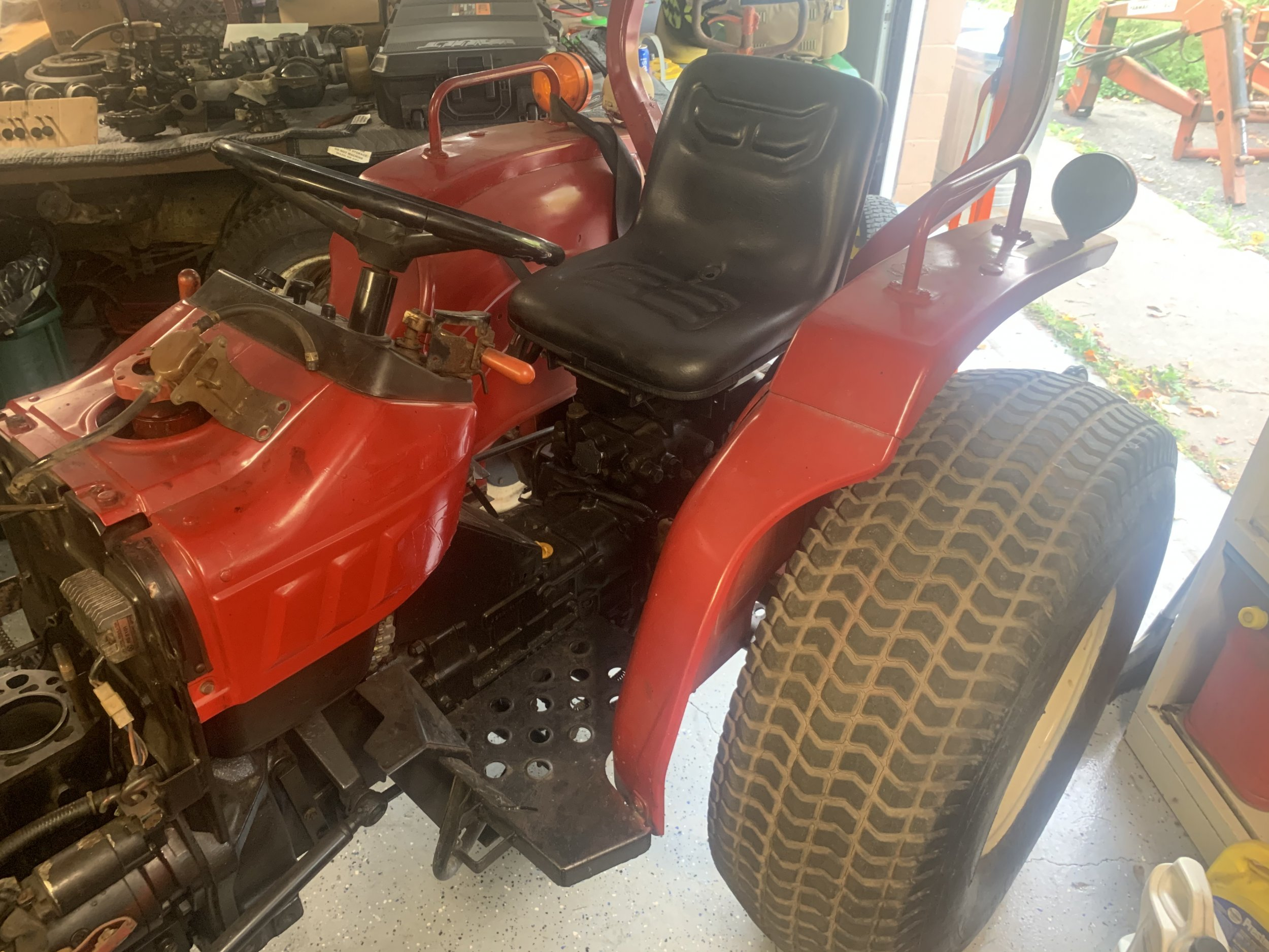

Here's a bunch of pictures to show how I picked it up and some of the initial discoveries:

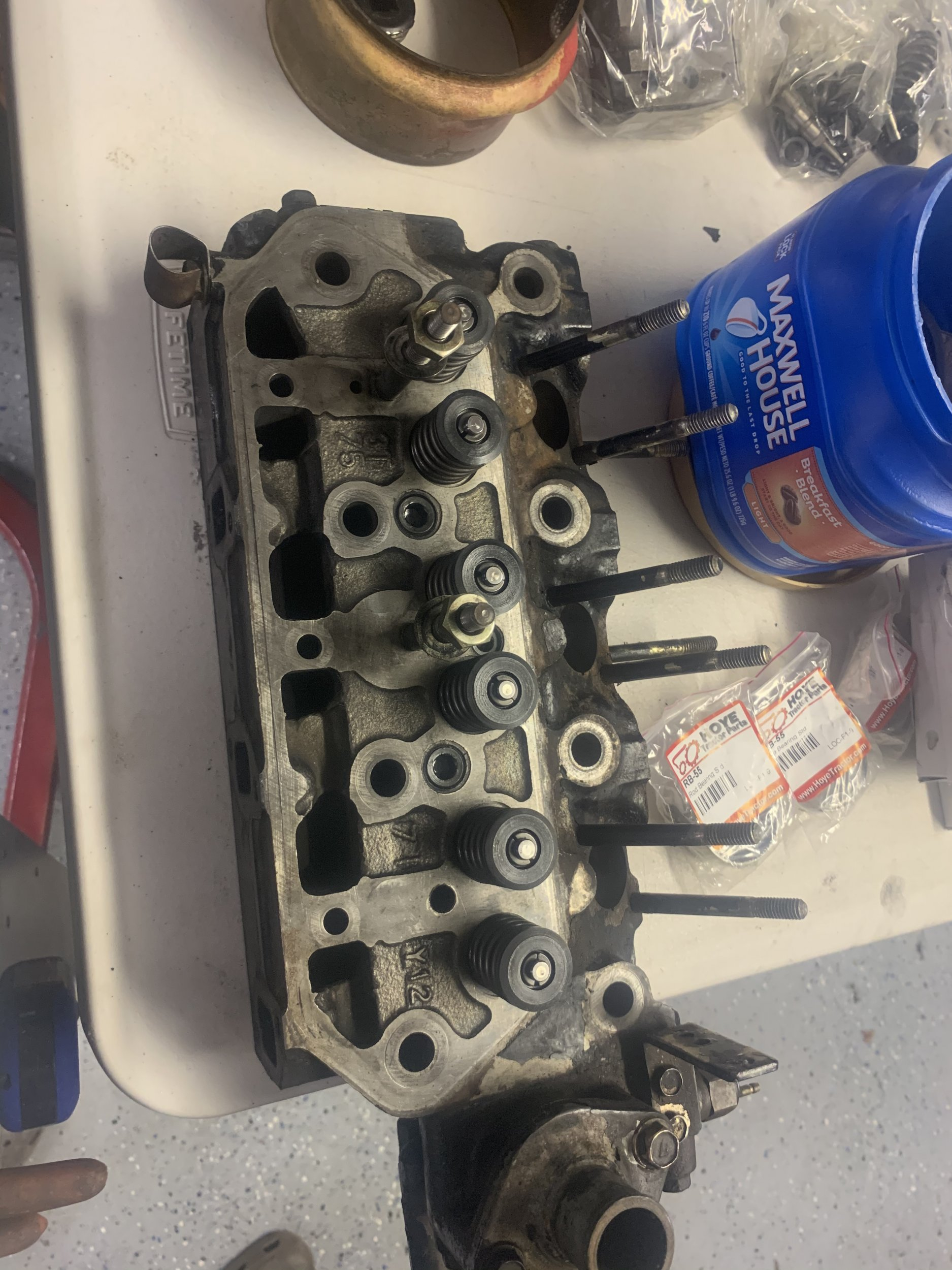

Head:

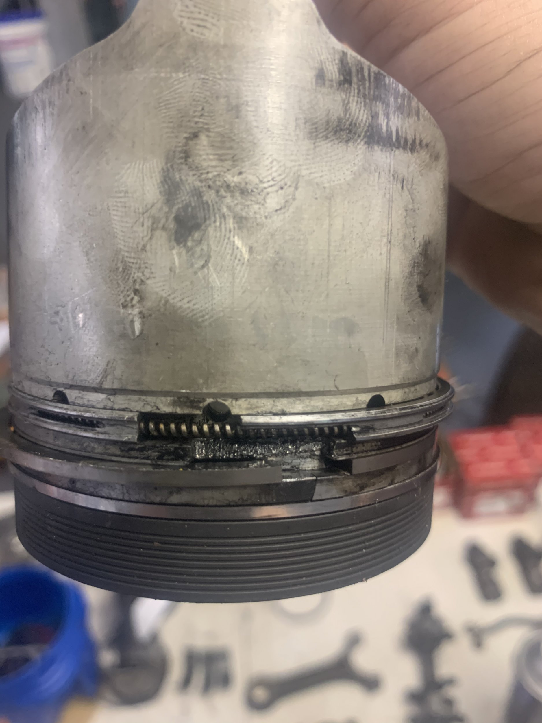

Two of the old pistons that were damaged due to starting fluid:
