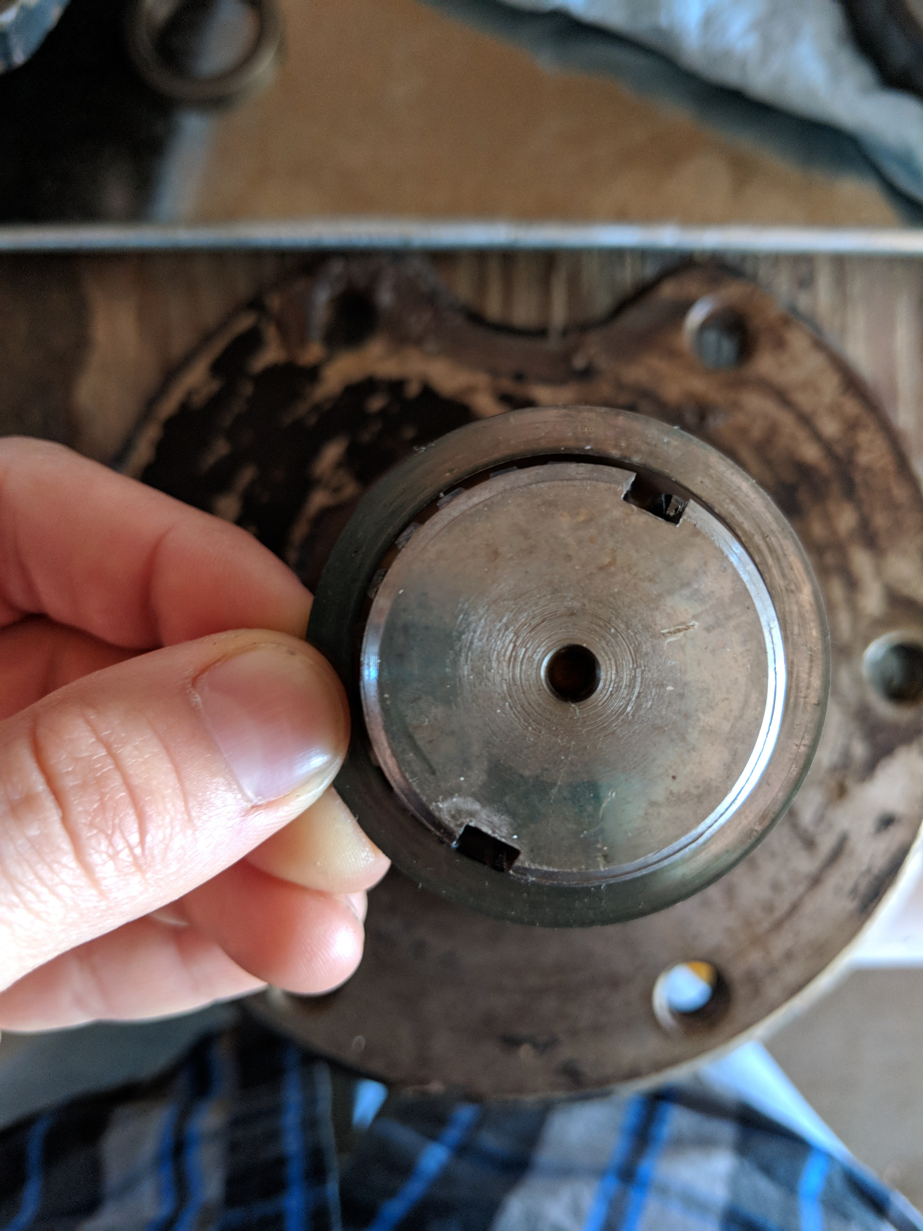

Status update:
I am back at the ranch, got into the garage and measured shims. Also took picture of how one of the better survivors fits:

I'm guessing someone had the unit apart and did not install the shims properly, thus the damaged shim and leak. I would just clean up the shims and reassemble with other new parts. Dern, just read through srscotty's post. he beat me to it.

What are the measurements of that shim? Do you think it originally was intended to go around that axle in that location? Shims work by spacing bearings - and the other side of the bearing generally pushes up against something hard - like a machined surface -- or sometimes a circlip, And depending on the design & designer, sometimes the inner bearing race is shimmed and sometimes the outer. Now if that shim works in that location by spacing the inner race of a bearing held on the other side by that circlip, the ID looks a little too large. And if they are spacing the outer bearing race then the OD looks small. Makes me wonder if that particular shim goes with a bearing at that axle location at all.

Enlarge and check the marks on the mangled shim. It obviously was not properly seated from the beginning.

The shims measure 40mm ID x 50mm OD. The axle around that area measured 39.9mm. They are sandwiched between a spacer (42x48) and the gear.
I think there was too much space and the one shim traveled a lot and found a favorite side.

Remember you said YOU called Hoye and THEY said its 42mm ID, 48mm OD. That is what I would go by... 42mm x 48mm size would fit with the spacer...

OK, I'm with you now. I think from your photo that you are working on the wheel spindle.

Uh-Oh...BTW, my apologies about my rant about bearing prices.... I didn't realize just how much heavier the 240D axle is than the 195D front axle. The bearings are NOT $12.00 bearings - the 240D uses one each of the #6008 and 6211 in the spindle area - which are more on the order of $36.00 each. Here's a link to bearing dimensions and specs that is informative and might help calculating shim size, too.
McMaster-Carr
If you are working on the spindle like I think you are, how are you coming on the oil seal? From the drawing it looks like Yanmar cleverly put a wear sleeve (collar) between the ID of the oil seal and the spindle stub axle. Of course doing that creates another leak path, which they addressed with a hidden O ring inside the wear sleeve and what looks to be a groove to hold it in the spindle stub axle. Hmm....well, they got that half right. A single O ring would stop but also needs something to keep the wear sleeve from cocking relative to the axle shaft. They could use either another O ring, or maybe very careful sleeve dimensions so that it gets sandwiched and stays parallel with the axle because of that. If yours weeps a little when you are done we can put some more thought into improving the oil sealing on the inside ID of that wear collar.
