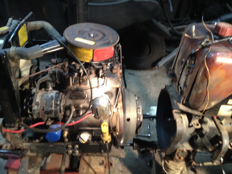

Ok split tractor today and clutch is completely gone. Will order new one and throw out bearing tomorrow.

So I put a new clutch in and it went well after I found out that the YM240d main shaft in the bell housing does not pull out like all others..Other then that it went well..

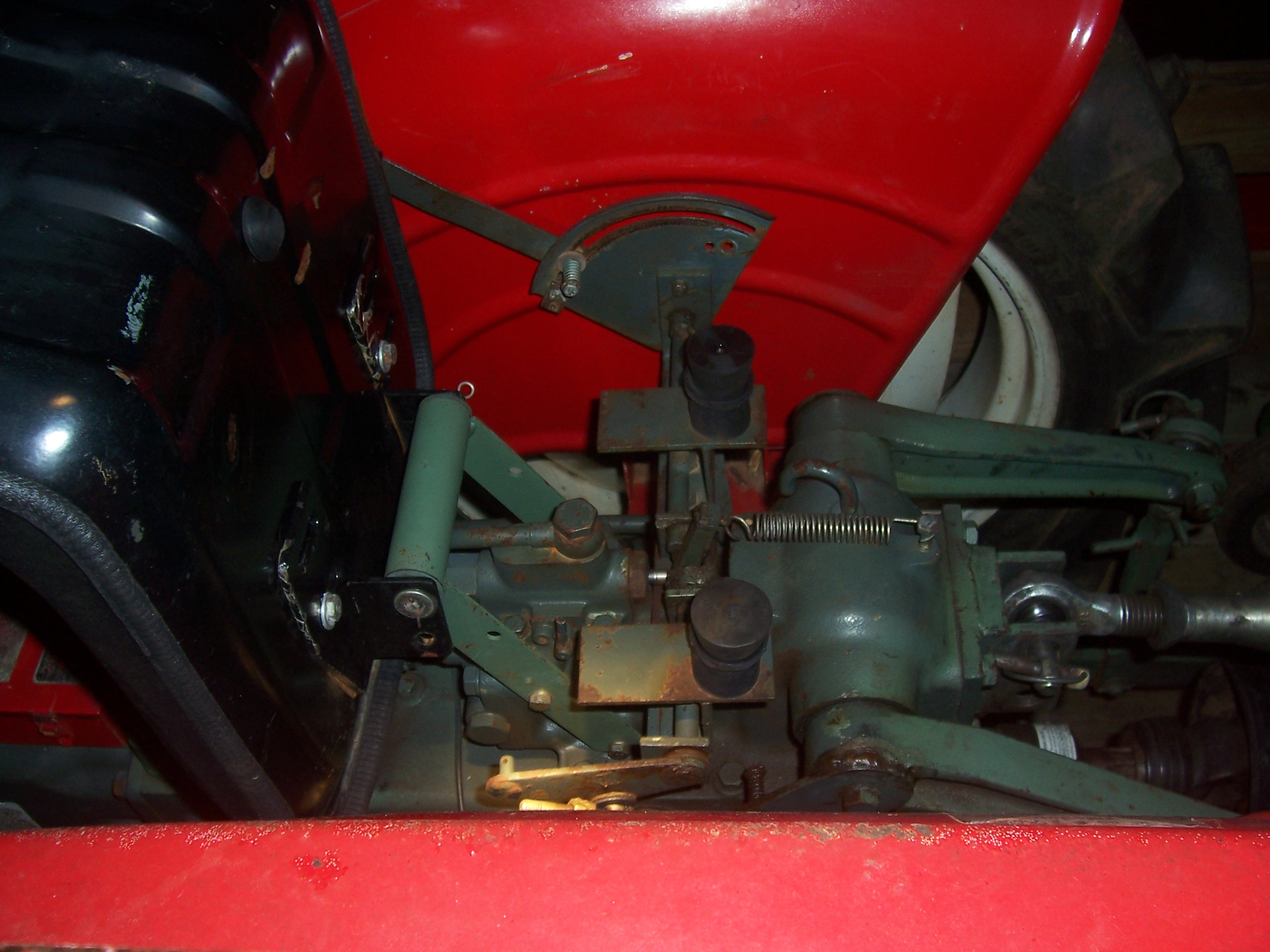

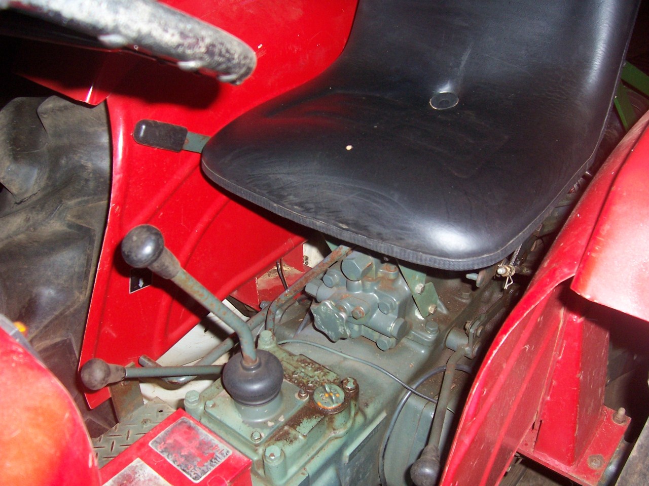

Crack the Hyd. line to the Control Valve to make sure your Pumping Hyd. Fluid. Make sure the Hyd.Serv.Stop Valve is open. In the Pic.between your legs under the seat. Counter clockwise is open. Some one may have closed it to prevent the lift from falling but it also prevents it from lifting. If it shut it's locked. Make sure the linkage to the Control Valve is working. 1st. pic. On the Plunger were the finger and spring is. To raise the lift the plunger is pushed in on the Control Valve. How far In or out it's moved is how high or low your arms move. That is the basic's to check first. If it's pumping fluid and the linkage is working Serv. valve open and no movement my Guess is a bad control valve. Also look on the side of the valve and your see the Lowering Adj, Its the set screw with the pin in it. Should be pointing up.

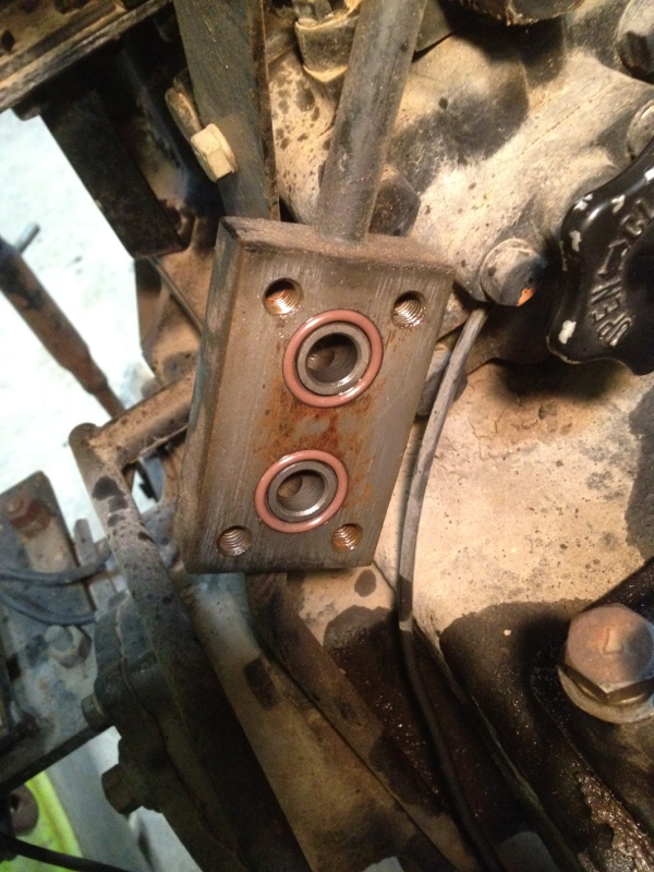

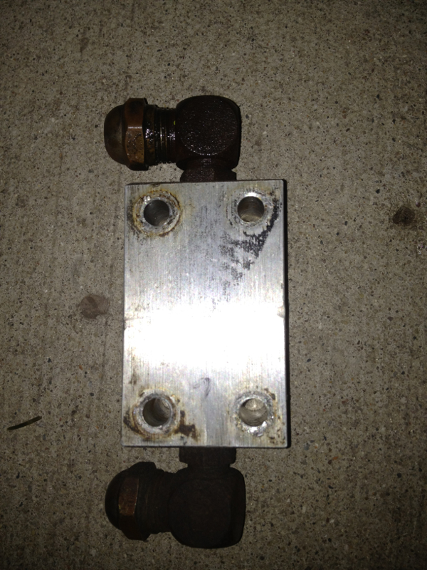

Ok every day I'm learning not to assume . My hydraulic pump works fine the problem I had is with these blocks not having any flow thru ports I wasn't getting fluid to my 3 point valve. So for this to work I need to install a jumper hose in between the caps. Right? Why is this block not drilled through to run the 3 pt and a loader or something??
