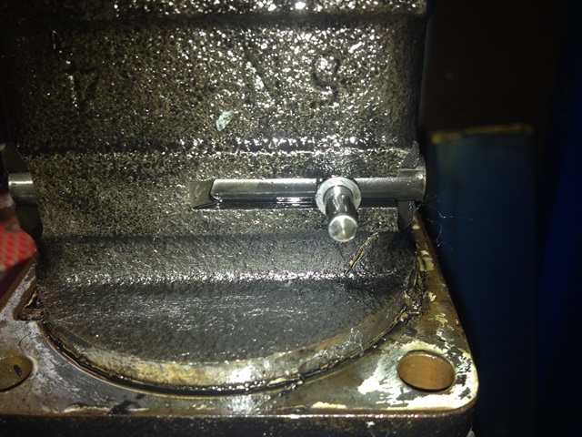

My throttle on my YM300 has become inoperable and the tractor only runs wide open in a run away state. I have taken the throttle linkage loose from the lever on the injector pump and there is spring tension on the lever from inside the crank case but it does nothing to control engine speed. This evening I'm going to remove the inspection plate and see if I can determine what has come loose. What should I be looking for in there and can I resolve this problem thru that opening with the plate off?

Here's what I'd do. Remove the inspection plate with the tractor off. See if you can access the rack visually or physically, or both. Take pics, post them, and wait for replies. If it seems possible to move the rack, without doing further damage, you might try doing so, but I doubt you will be able to without further dismantling.
This is the "Rack" on the pump. It has a flat lever attached to the pin,with a little bushing and a hair pin. The rack is probably stuck? It should move freely in and out of the pump. Take off the breather cover above the pump and you can see it and maybe free it up.Or you might have linkage problems?Won't know till you look.
/ YM3000 injector pump linkage/engine run away #7
Had one doing the same thing, The little hair pin Barry 1 mentioned had fallen off and the engine ran away as soon as the engine started.

Thanks for the replies. I ended up having to pull the pump. The gear on the first injector had somehow become disengaged from the rack and stuck the rack. She's now running like she always had before the issue.
