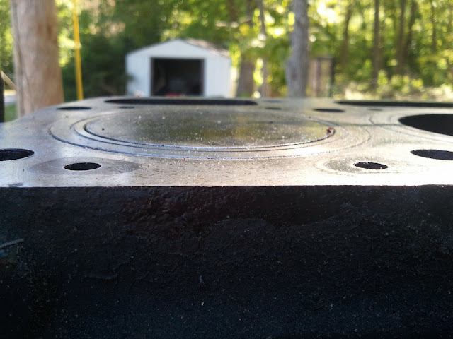

Okay, I measured the piston heights at TDC compared to the deck height and found:
#1: .019"
#2: .018"
#3: .018"
I'm going to guess that extra .001" doesn't really mean anything vital in terms of final compression.
Here are some pictures showing how the pistons and sleeves line up (in order of #1 -> #3):
Sorry the angles aren't all the same, not much room to hold my phone below the block.
What does concern me is the fact milling .011" from the head makes the pistons much closer to the head, even with the head gasket. Seeing as there are dents in the pistons where the injector nozzles have hit the pistons tops it appears the nozzles are a major concern, especially now.
I hate having to remove those nozzles (never did remove them completely), but if that is what is needed, so be it. I was contemplating simply grinding a flat spot into the nozzles in order to make them flush with the head, as right now only one of the three sits below the head surface, and only about .005". That would not require much grinding. It seems every time i have to remove something else, something else breaks and requires another Hoye order.

Glad to hear the rods are not bent I sure would have sworn they were by the pics! Actually the head is the same distance from the pistons the pre-chambers and valves are whats closer fwtw. And no .001" wont affect anything compression wise anyway.
I would not grind the pre-chambers. The "dents" you refer to are simply wear and tear from the injection process not parts touching.
