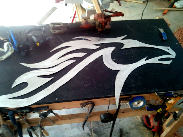

A horse head I made for my local horse club (stainless steel)
