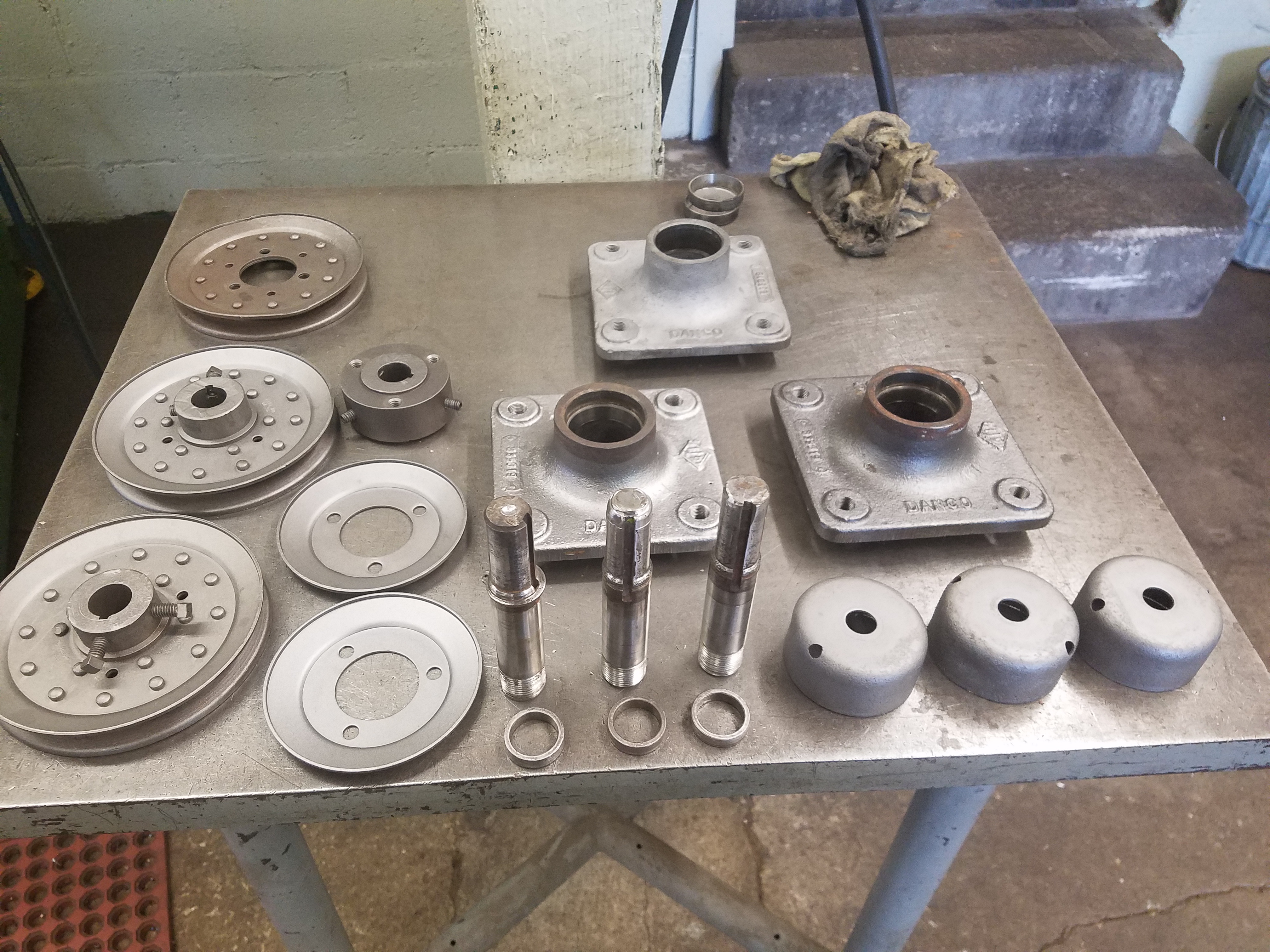

I am trying to put together my YMM-45 deck that was tore apart by someone else. They had the 2 outboard spindles in pieces to re-build them. I have the new bearings and all but 2 seals (working on that). I blasted all the parts and will probably just powdercoat them for durability.
Now, The problem is I don't have any exploded views or information on how to re-assemble the spindles. Does anyone have any information on this and recommended pre-load procedure for the tapered bearings? I also am going to need a locknut for the middle blade as the heat required to break it loose melted the nylon.
Any Help would be great!

That helps! is there a procedure for pre-loading the tapered bearings?
Also do you know what #23 is the first pic?
/ YMM-45 MMM Spindle assemblies. #6
The manual calls it a 'cup washer -5/8'
It does not mention anything in the manual. I would just set them like a trailer axle tapered bearing which is usually: Tighten the nuts fully tight, rotate the spindle a few times in each direction to be sure everything is seated, loosen the nut completely, then re-tighten just beyond finger tight.
It does not mention anything in the manual. I would just set them like a trailer axle tapered bearing which is usually: Tighten the nuts fully tight, rotate the spindle a few times in each direction, loosen the nut completely, then re-tighten just beyond finger tight.
Thanks for the Information! I also just received information from Gary so I hopefully will be good to go.

Did Gary have any advice on preload?
#9
No, there doesn't seem to be any specifics on that so I'll just use the method above. It looks like the only thing I am going to need is a new locknut that holds the spindle in. Item 9 on the spindle. Should be able to find that locally once I get the size.

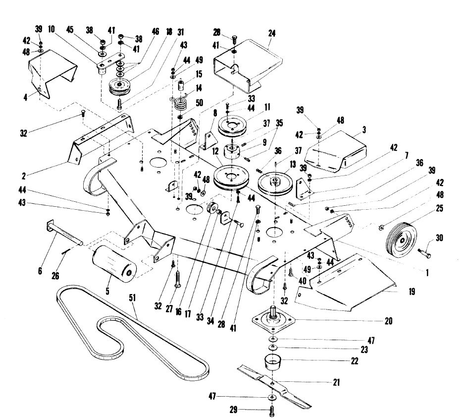

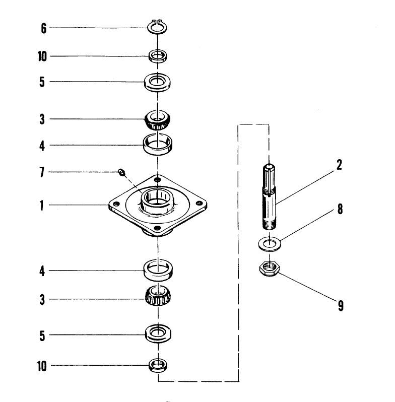

Whilst searching for any remotely related manuals, I did find pages on Ebay and elsewhere for this YMM-45.
/ YMM-45 MMM Spindle assemblies. #17
The remaining pages,
This should provide a bit more help.
Click on the images and then a second time for FULL SIZE.
