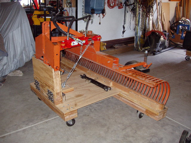

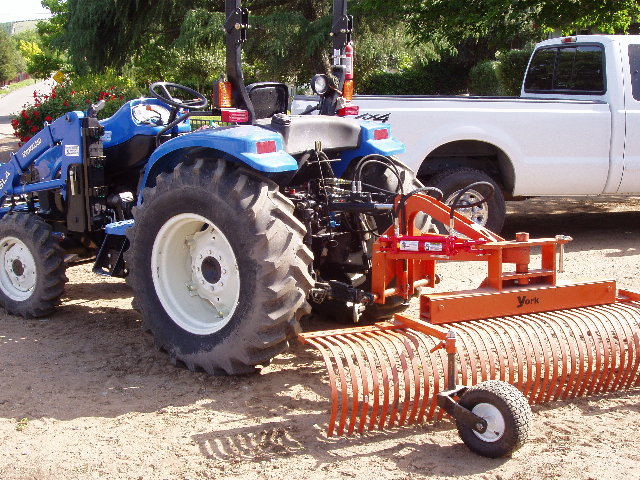

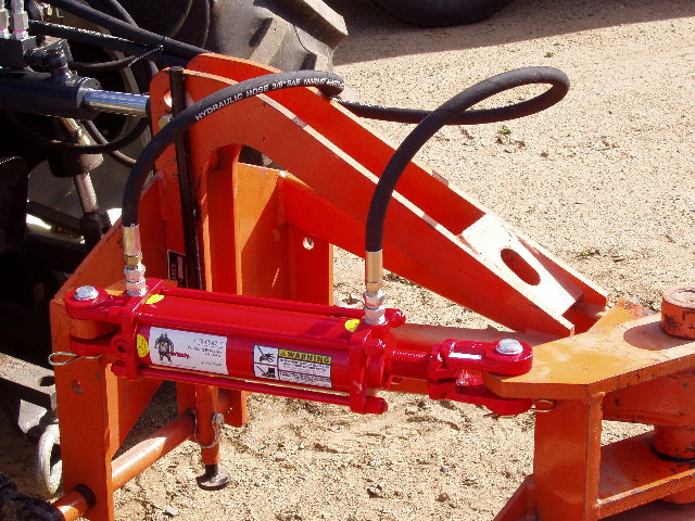

Here are some photos-my neighbor had scalpel surgery this morning-crazy thing is he just had his four roping horses shod a couple of days before the accident so he was hit with full weight double back foot iron.
1st photo see the original stock factory mechanical angle arm laying on the dolly bed. I built this dolly before I bought the TnT cylinders so I designed in the hinged front piece so it could be dropped for the rake teeth clearance while using the standard NH turnbuckle type top link and then driven over but with the hydraulic top link I can now angle the rake way up and clear the front section without having to use the drop down hinges. Nice.

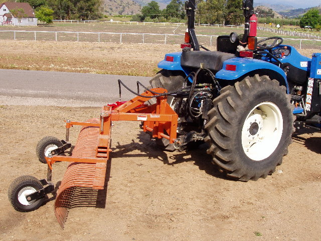

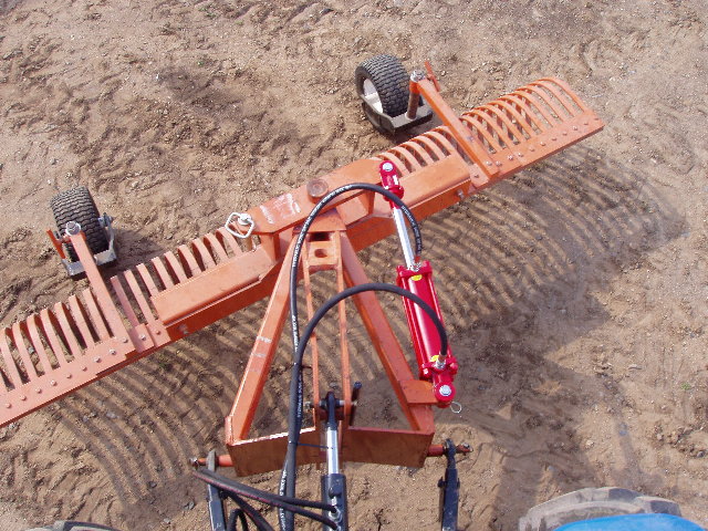

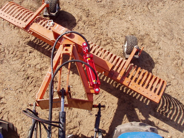

second and third photos show the right and left swing controlled by the push/pull of a lever.:)
Yes, there is a 12 gauge shorty in there somewhere...
