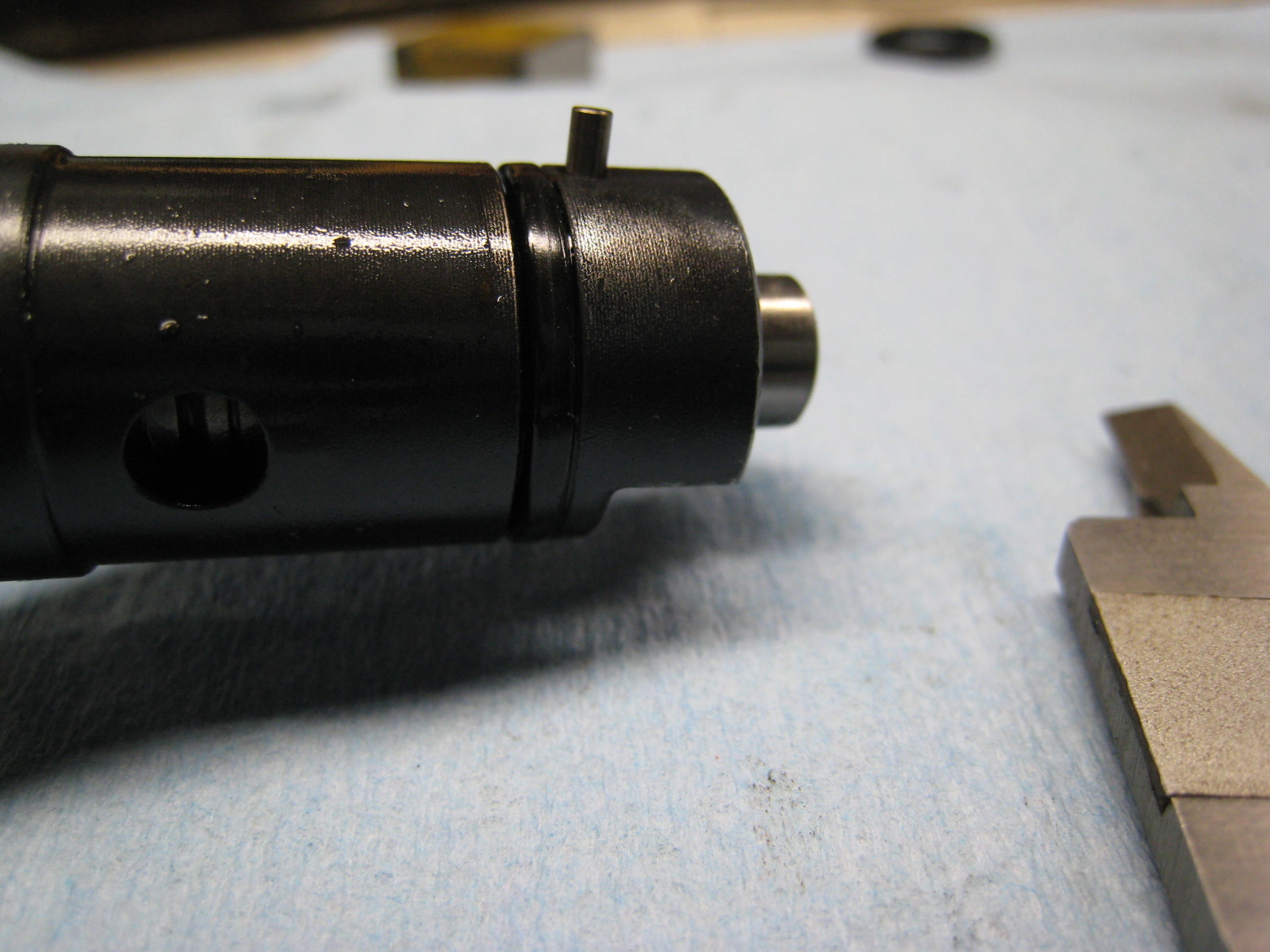

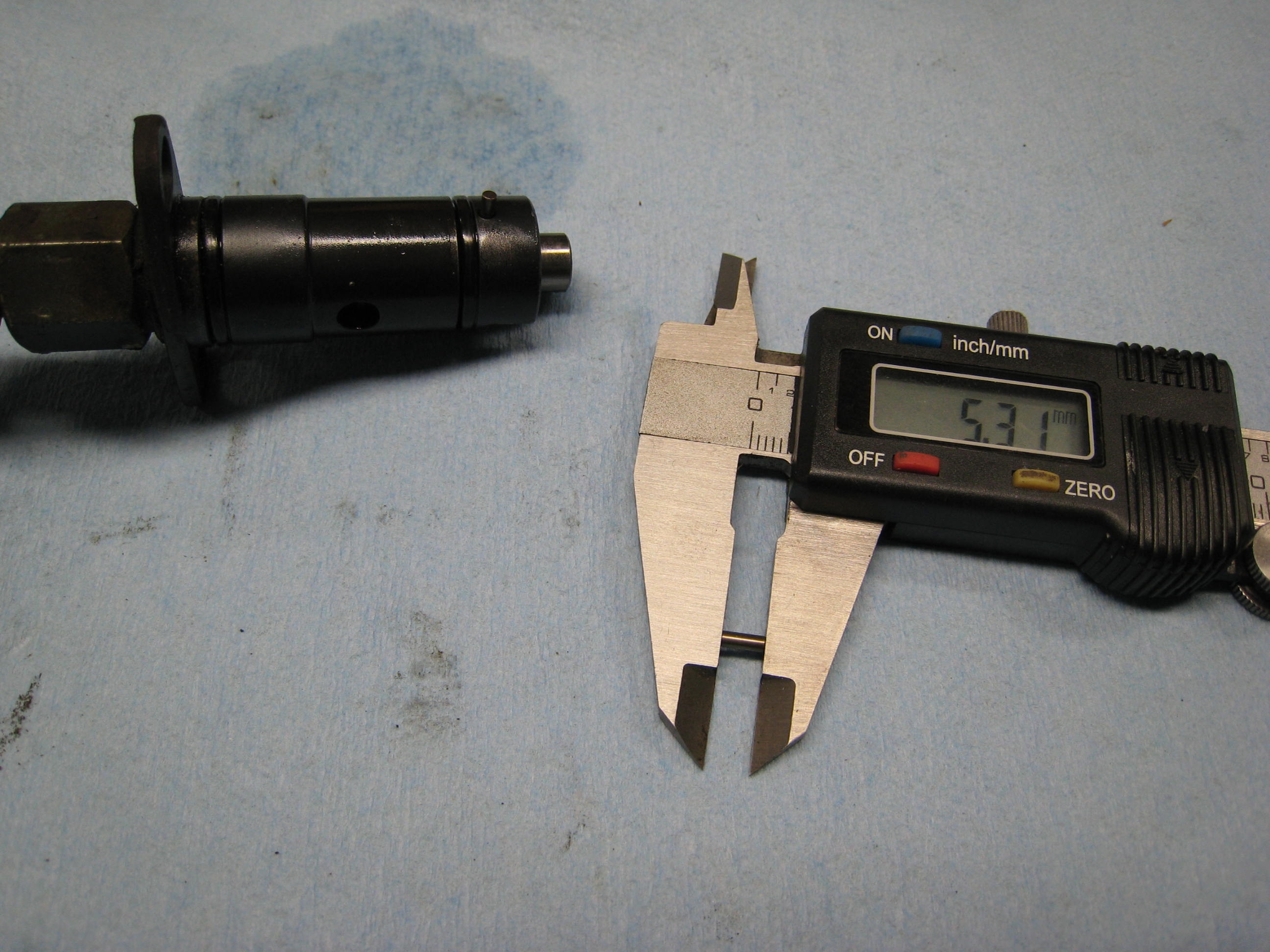

I had a small leak in my fuel injector pump and read that self-repair of these units is impossible, or at least strongly discouraged. Having a brother that is a good mechanic and can bail me out of most of the messes I create, I figured I would give it a shot. My repair was to a 3 cylinder Kubota (D722), but I think the same basic process would work on any Kubota diesel engine. This seems to be a fairly common problem so I hope it saves some time and money for others.
The leak was around the base where the injector lines connect to the pump. Slow leak, but over time builds up oily junk down the side of the engine. The problem is failing O-rings on the shaft of the injector. 2 O-rings on each shaft. Here's what I did:

I have exactly the same fuel leak in my Kubota F3060 mower (Kubota V1305 engine), and was able to find the O-rings on the eBay with the dimensions you gave by searching: Viton/FKM O-ring 11.8 x 2.4mm Price for 10 pcs

You're welcome! Glad you were able to source the o-rings. I don't have the machine any longer, but the repair was permanent. I hope yours is, too.
