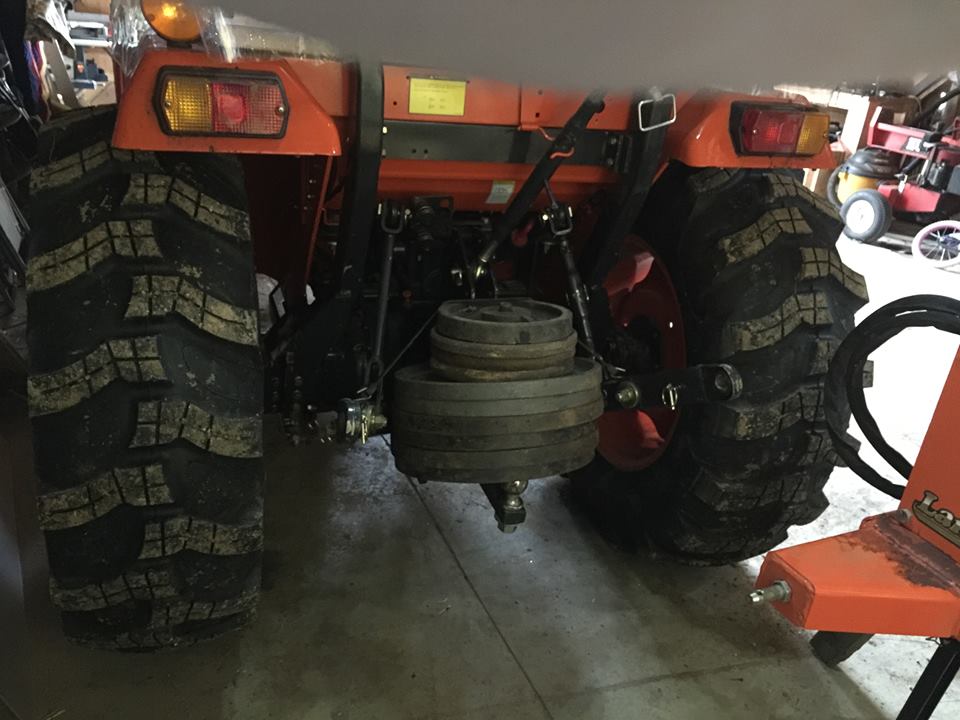

Don't get me wrong, I like lots of weight on the rear. I have 1000 pounds of fill in the rears, a 200 pound brush cage and 400 pounds of iron ~18" behind the rear axle. Factor in the 100 pounds I transfer from the front and I'm running 1,700 extra pounds on the rear and the tractor is very stable. If I need more weight I add additional weight to the 3pt hitch in the form of an implement or weights. My tires are also set reasonably wide etc. I like stability. But all of that is irrelevant to the question at hand - what's the real world impact on the front axle of not having a 3pt counter weight on when doing loader work.
Here's my every day set up. I like it because 1,700 pounds is enough to keep the rear planted and because it is right over or very close to the rear axle it keeps my front nice and heavy for digging in dirt and steering in snow. Plus it doesn't stick out at all so no maneuverability issues like you can have with a 3pt counter weight.
