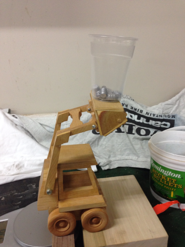

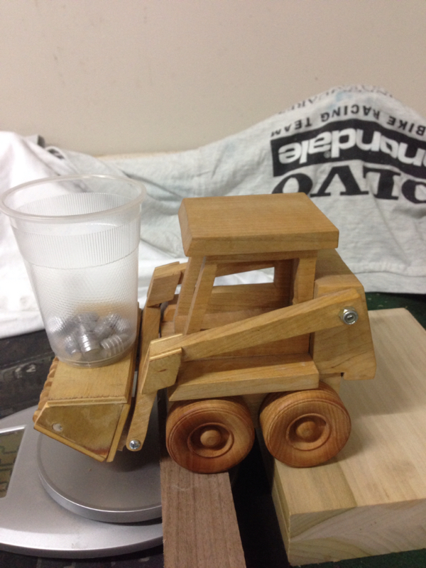

Here is another small scale test this time using a toy skid loader. The geometry of the arms on this loader aren't very good, BUT they still attach behind the rear axle. The weight distribution is also poor, but neither of those should matter for this test.
Unloaded front axle weight 12.6 oz
Unloaded rear axle weight 9.2 oz
Total machine weight 21.7 oz
Now I loaded the FEL with 5 oz.
Loaded front axle weight 22.6
Loaded rear axle weight 3.8 oz. this is with the arms all the way down.
Loaded rear axle weight with the arms 1/2 way up .3 oz.
I had to raise the arms to this position to get more weight on the rear axle VS the unloaded weight.
