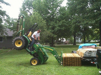

It may or may not have looked something like this for that as of yet unidentified 14 year old that I mentioned earlier. The kid can't remember much about that episode except that nothing broke and he was usually much more careful from that point on.

Interesting picture.
Way to small of a tractor and with a light PHD on the back to boot.
What is that? a Full bundle of treated deck boards? 2500-3000# assuming only 8' boards?
I think it's a simple matter of the counterweight (PHD) being too light...... ;)
Can't tell the model of loader/tractor...but I think it's more than just counterweight.
Looks like the loader was only able to take enough weight off to slide the load. As soon as it cleared, down it went
