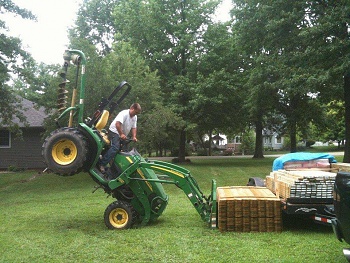

It may or may not have looked something like this for that as of yet unidentified 14 year old that I mentioned earlier. The kid can't remember much about that episode except that nothing broke and he was usually much more careful from that point on.
On to that skidsteer dirt tipping reenactment I posted earlier in the thread? Now the kid remembers that one very well, but he was 17 then and trying to show off while the boss took a break. Just last year I was able to stand the Max on its nose while trying to lift up a stretched and lifted golf cart with my clamp on pallet forks. Now that would have made a great picture, but my feet were firmly planted on the dash until I got back down. Everything works fine until the total CG just barely tips past the front axle and then it's all over.

Interesting picture.
Way to small of a tractor and with a light PHD on the back to boot.
What is that? a Full bundle of treated deck boards? 2500-3000# assuming only 8' boards?
I think it's a simple matter of the counterweight (PHD) being too light...... ;)
