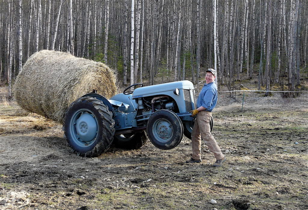

Another thing that hasn't been mentioned is the greater pushing ability with ballast. My backhoe and loaded tires weigh over 3,000 pounds. This much weight makes my tractor push much harder making it more like to damage the loader.
   / You need balast or you will trash your front axle!!!! really? #78
Ballast? Put on a backhoe, cradle a big rock, extend the dipper and lower the boom. Just watch out turning around :D
   / You need balast or you will trash your front axle!!!! really? #79
When I needed to move a bunch of logs I did that except the boom was in the closet position. That is too much ballast and causes the tractor to bounce. If I extend the boom out it will lift the front wheels off the ground. I'd say that relives the stress from the front axel.
   / You need balast or you will trash your front axle!!!! really? #80
And what's your opinion on the lever arm length ( 3 point ) that he needed to achieve his result....
It would have to be pretty long or a whole lot of weight, but you don't want to achieve my results. With such little weight over the front you can't steer without the split brakes.
