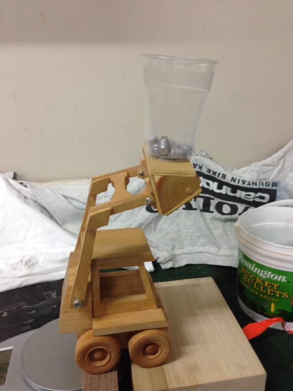

I did a small scale test using a toy loader and a kitchen scale. Let's pretend the lift capacity of the loader is 1 pound.
Machine weight with no ballast 17.1 oz
Front axel weight with no ballast 10.3 oz
Front axel weight with bucket loaded to tipping load with no ballast 27.1 oz
Tipping load was 9.2 oz. this is pretty accurate since most tractors will tip before maximum load is reached.
Now I added 11 oz of ballast.
New front axel weight 4 oz.
weight of front axel with previous tipping load 21 oz.
Here is the problem, I can now lift much more.
Weight of front axel with 1 pound load 34 oz.
weight of front axle with the ballasted tipping load 70.oz
Weight of tipping load 41 oz.

Does that mean you are understanding now? or do you still incorrectly maintain that added weight behind the rear axle doesnt take weight off the front axle?
   / You need balast or you will trash your front axle!!!! really? #83
No. Its wrong because we a re not talking a static condition. Enuf has been said about the greater front loading possible with rear ballast that it should have been called to your attention as obvious. If you use your loader lightly, counterweight will reduce front load. If you use your loader to capacity pushing and lifting, then rear ballast and counterweight will enable much more weight on the front axle -- up to the combined weight of the entire tractor, its ballast and counterweight, and the load supported on the loader. The tractor will move but not travel in this condition because the rear wheels are skimming and you cant steer. If you use the loader a little lighter duty youre able to steer and travel as needed with about 90% of all combined weight on the front axle.
What in what I said is wrong?

Here is a simpler experiment. The fulcrum over the scale represents the front axel.
In this picture the load is close to balanced with 107 oz over the front axel.
Now without moving either fulcrum or reducing the front load I can reduce the load over the scale to .9 oz.
The problem comes in is now I can stack way more weight in the front bucket without changing the fulcrum or changing the rear load I pegged the 10 pound scale.
And 4570 your second effort was even better. Debate of viewpoints is always a challenge of varying methods of communication. I think you were quite successful in the exchange of viewpoints.
But even more . . . you didn't stray into unsafe examples merely to attempt a weak point.
And by your very examples you also showed just how much weight at a short leverage would be required to effect the longer leg on the front . . thus demonstrating the OP's original post as well.
Well done demonstrating ground pressure. In a visual manner with humorvand skill. You have a teacher's talent.
Greetings LD1, what it means is that a debate of viewpoints is a non-emotional effort to better communicate. I admitted in my original post that I was confused by the statements made prior to my 1st post and then established why. It also means that 4570 was very skillful in recognizing a need for visual instead of theoretical reasoning.
You used in this post that I was "incorrectly maintain" something while others claimed my need for "movement" was not valid or even required.
But 4570 in his second example skillfully demonstrated that movement was needed . . But that great force was required to create slight but important movement . . thus altering ground pressure . . a term never used until much much later after 4570's communications.
You asked if i am now understanding . . and my answer is yes . . because someone properly showed there was movement of the lever because ground "contact" is a variable. 4570 also showed just how much weight would potentially be needed on the short side of the lever (rear axle to 3 pt ballast) to create any measurable impact on the long side of the lever (rear axle to front of fel bucket).
I'm certain had you been around during the short debate . . that you would have recognized the need as 4570 did.
I also noticed a couple posters used words like "argue" which often implies emotion or rididity. I can't speak for others . . but you likely noticed mine reflect a willingness to communicate and listen to others points of view as long as unsafe operation is not acceptable . . and 4570 had some good points made :)
Just so no one misses my response to your posted question ive repeated it again here: "You asked if i am now understanding . . and my answer is yes . . because someone properly showed there was movement of the lever because ground "contact" is a variable. "

Rear ballast certainly takes weight off the front axle. But do you admit rear ballast also adds weight to the front axle (defined by: it enables you to load the front axle to much more than it would otherwise see)? Which gets us back to the OP's original post.
I think it's hard for people to wrap their head around (or communicate) this contradiction.
