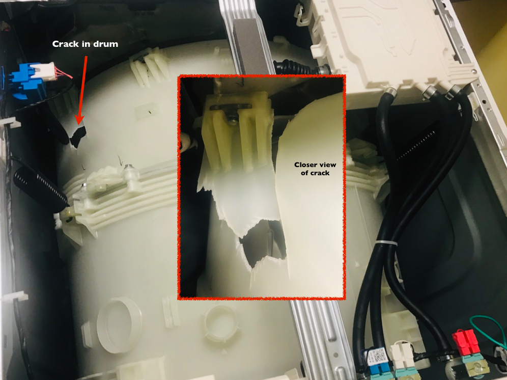

Well, found out what the issue was.
To Samsungs credit, we will be picking up a new washer hopefully by the end of next week.
I was surprised to learn looking at the machine that it was built (assembled) in the United States.

Dang!
I was wondering how water got out of the washer & onto the floor.
That'll do it!
When did they start making plastic tubs?
Think it was damaged when built, shipped, installed? Or a large out of balance load, or a missing, failed, or wrong size spring that let an out of balance load crack it? Do washers have an "out of balance" switch that can fail?
You did say it made some weird out of balance noises before the water showed up on the floor right?
I'm thinking something went wrong somewhere else and this was the result. ???
What does the bolt & piece that that broke off bolt to? A top collar of the tub that's also suppose to move?

The washing machine was delivered first week in October of last year.
Unit failed at 3 months almost to the day. 2 teens (who do their own laundry) along with my wife and I and my father. The teens also did their laundry in the older machine as well. Machine sees use weekley needless to say.
Special screws are set in place in the machine for when it leaves the factory for moving that are removed when installed, to keep the "tub from moving.
I only took a quick pic because the service technician was running late and I know what it's like to have a homeowner looking over your shoulder, and I wanted something for documentation on my end if they were not going to replace the machine. First year warranty, I'm not going to touch it unless I'm the one who screwed it up.
In complete honesty, I've never had to take a washing machine or dryer apart because I've never had a problem with one in the past. I'm guessing that's going to change. Honestly the plastic tub surprised me as well. You got to figure manufacturers know what they're doing, but then I think of a HVAC manufacturer I'm intimately familiar with, and sad to say, the answer is sometimes manufacturers don't know what they're doing when they build their products LOL
