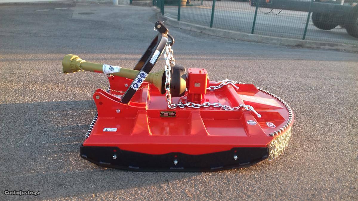

I can see where this would ride over the rough terrain good but it should float like the King Kutter Flex Hitch. That way it could twist independent of the tractor.
Also, the shoes are not rounded on the bottom for turning. Swinging the deck sideways would slice off any hump of dirt or sod.

1- Half round skid plates. This works very nice and will prevent the grooves and collecting of all kinds of stuff in front of it.
View attachment 606366 ...
I really like the profile of those skids. If it had a tail wheel, they not be meant to drag on the ground all of the time, but rather to minimize the gouging if they do contact the ground in rough terrain. When I am brush hogging, the front is slightly elevated by the 3pt hitch, and the rear is elevated by the tail wheel. That's all well and good on level surfaces, but it all goes out the window when the tractor is rocking and rolling on uneven terrain (which is usually what I am on). I wish the skids on my Kingkutter had that profile.
