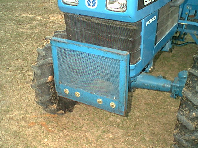

A front bumper grill gualrd to attatch to the existing bumper on my NH 1920... Has perf'd metal on it and has proven to keep about 80% of the crap outta my radiator screen.

I've attatched a copy of the bumper on my Nh 1920.. Just buzzed together, and bolted on.. painted NH blue.. parts were free from scrap pile.. Nh blue was 6 bucks.. Still allows the hood to tilt back.
